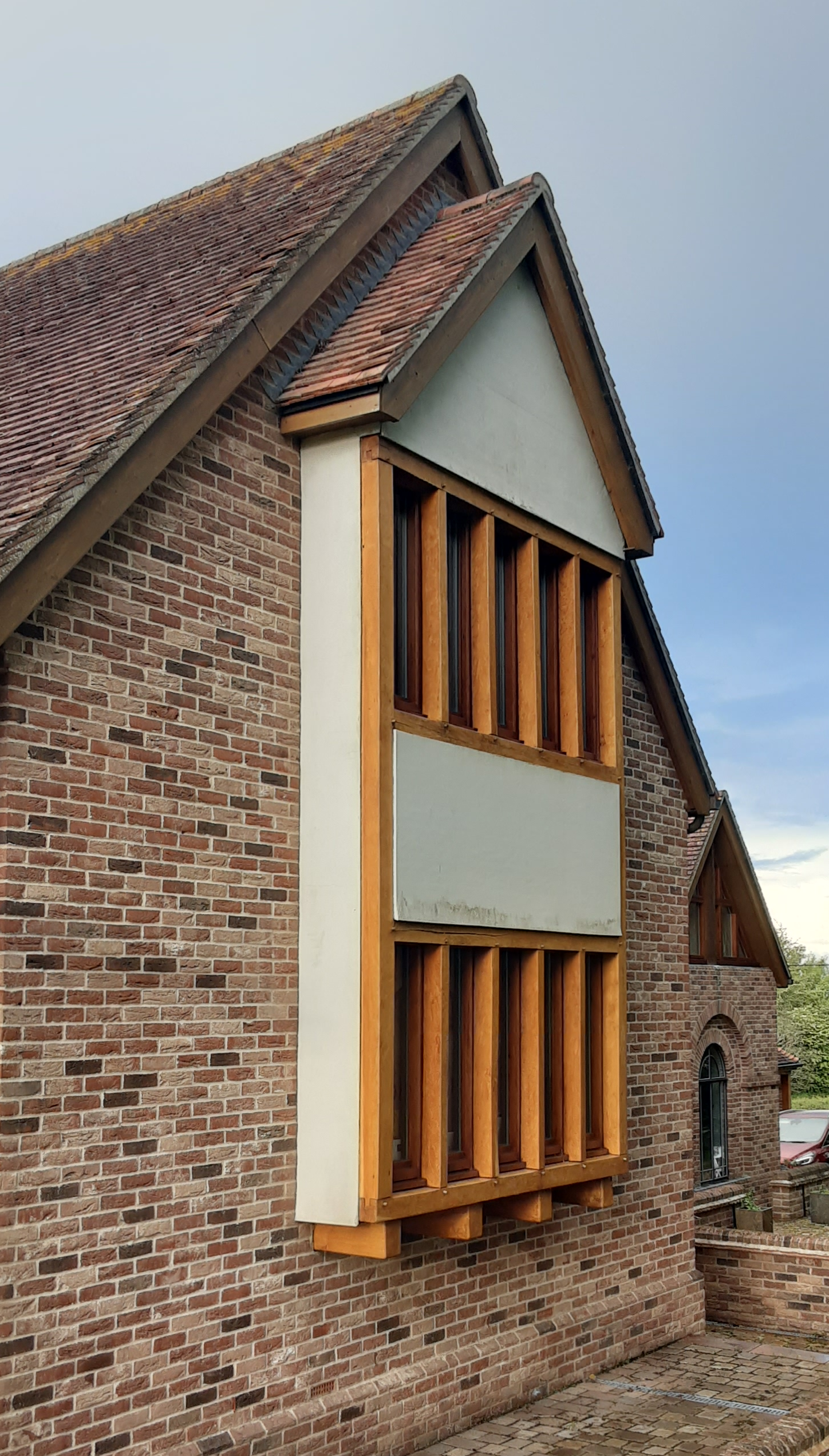

Glazed gable, oak cover boards and oak fascia.
Q. How to protect vs water damage without sacrificing the natural appearance?
So far, front running option is Plastikote clear lacquer spray matt. But I know less than anyone else about this.

One end of the lean-to gable is sufficiently unprotected to receive direct rain on the sapele (dark hardwood) cill. Perceptible water stain already, within weeks.
Coverboards are oak, not sapele.
