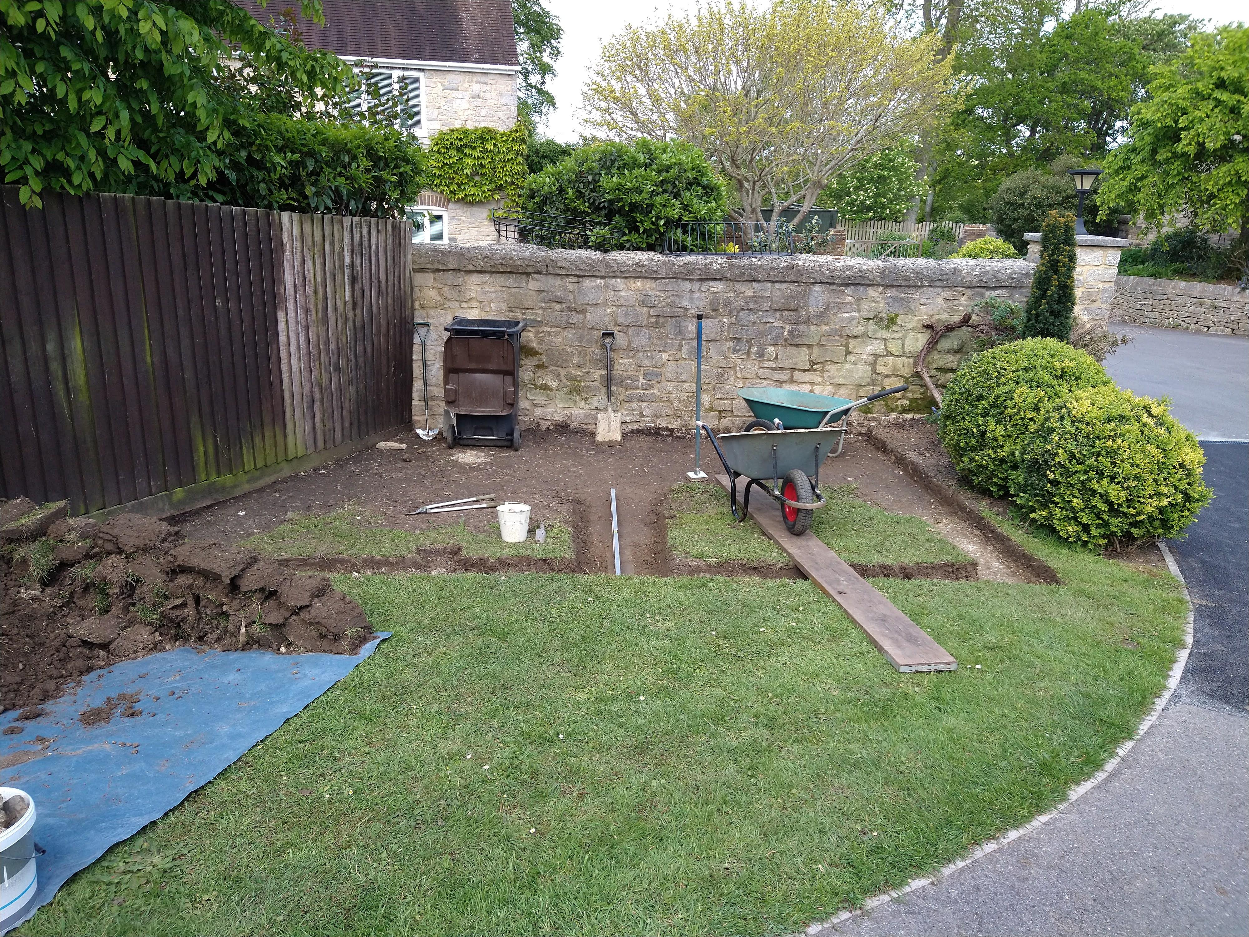

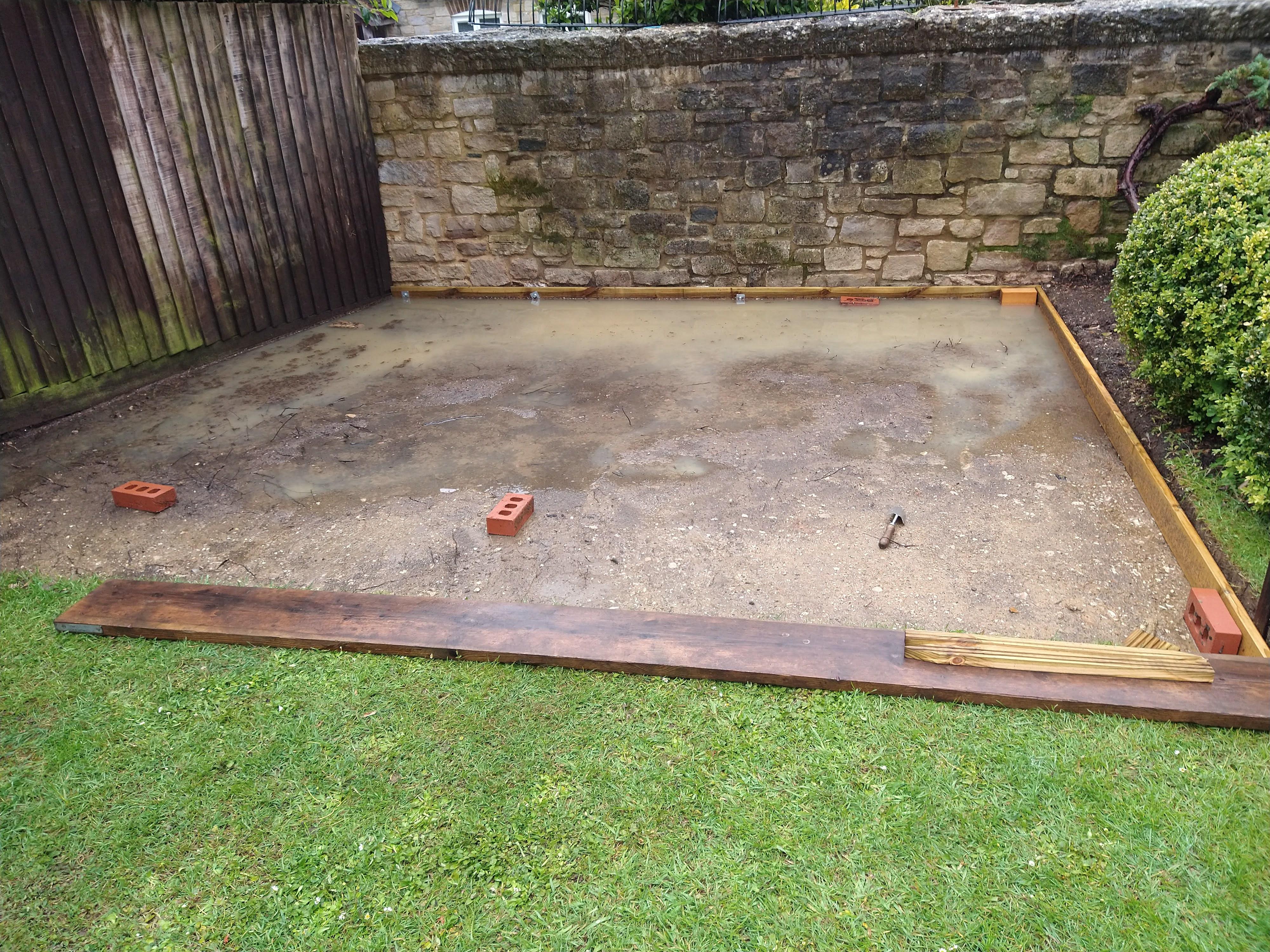

Radian Posted May 16, 2023 Author Share Posted May 16, 2023 Started stripping the topsoil for re-use in the raised beds. The plan is to create a perimeter using 125mm deep deck boards to define the plane and serve as screed rails to level the sharp sand fill. Then after a bit of a whackering, dry lay my reclaimed 450mm concrete slabs leaving two cutouts under the beds. 1 Link to comment Share on other sites More sharing options...

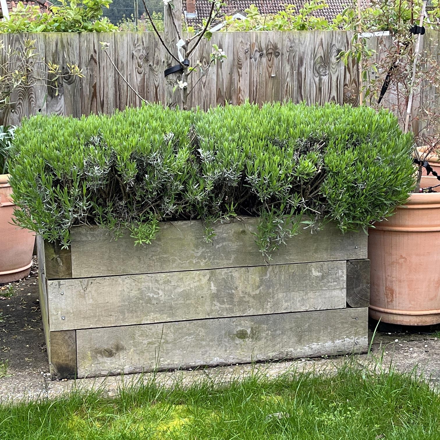

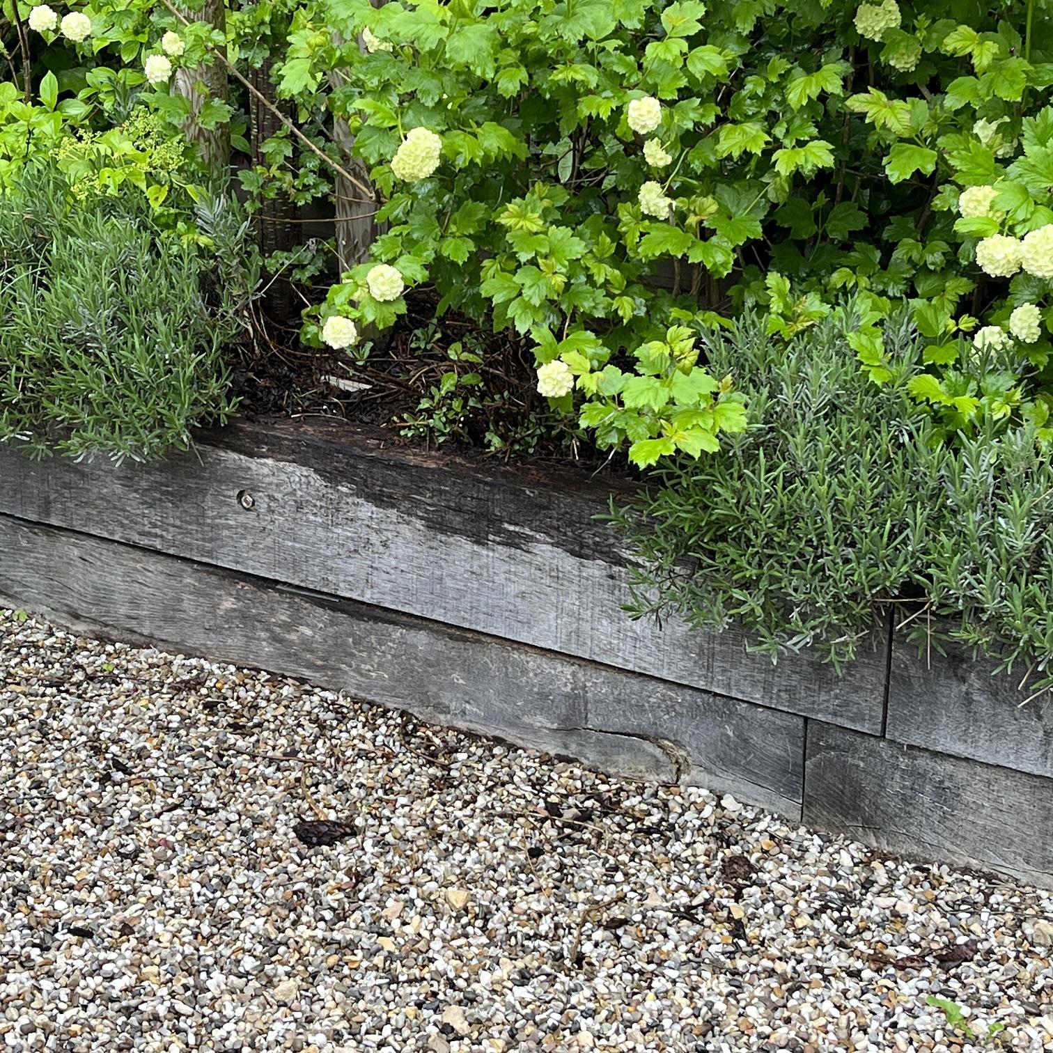

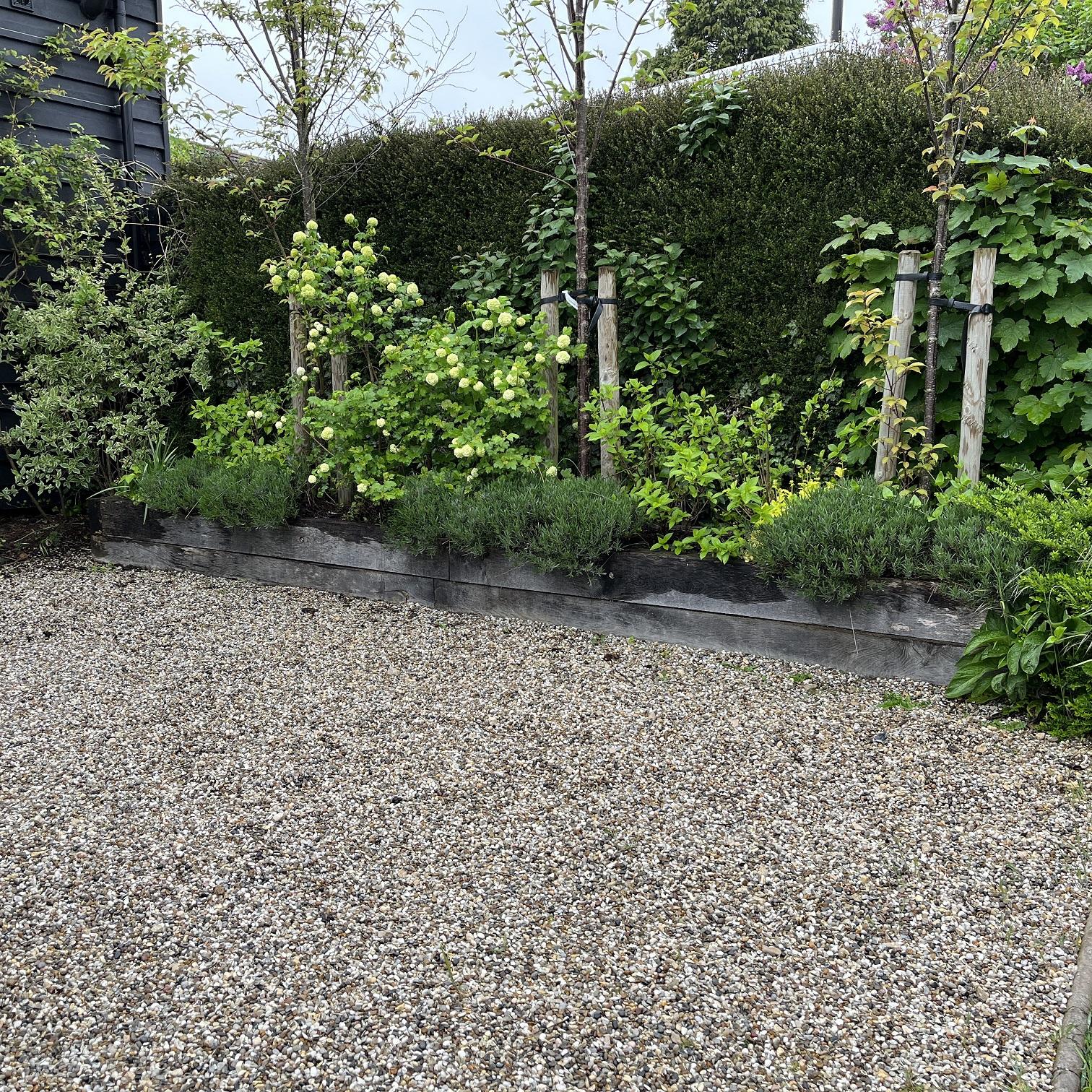

Alan Ambrose Posted May 19, 2023 Share Posted May 19, 2023 (edited) OK a couple of images of mine, these are oak and so the fasteners are stainless. They're 5-years old now so have gone a silvery colour. I got the suppliers to cut them and figured out the dimensions so they used either whole or 1/2 sleepers - so there was no wastage and no need to cut on site. Edited May 19, 2023 by Alan Ambrose Link to comment Share on other sites More sharing options...

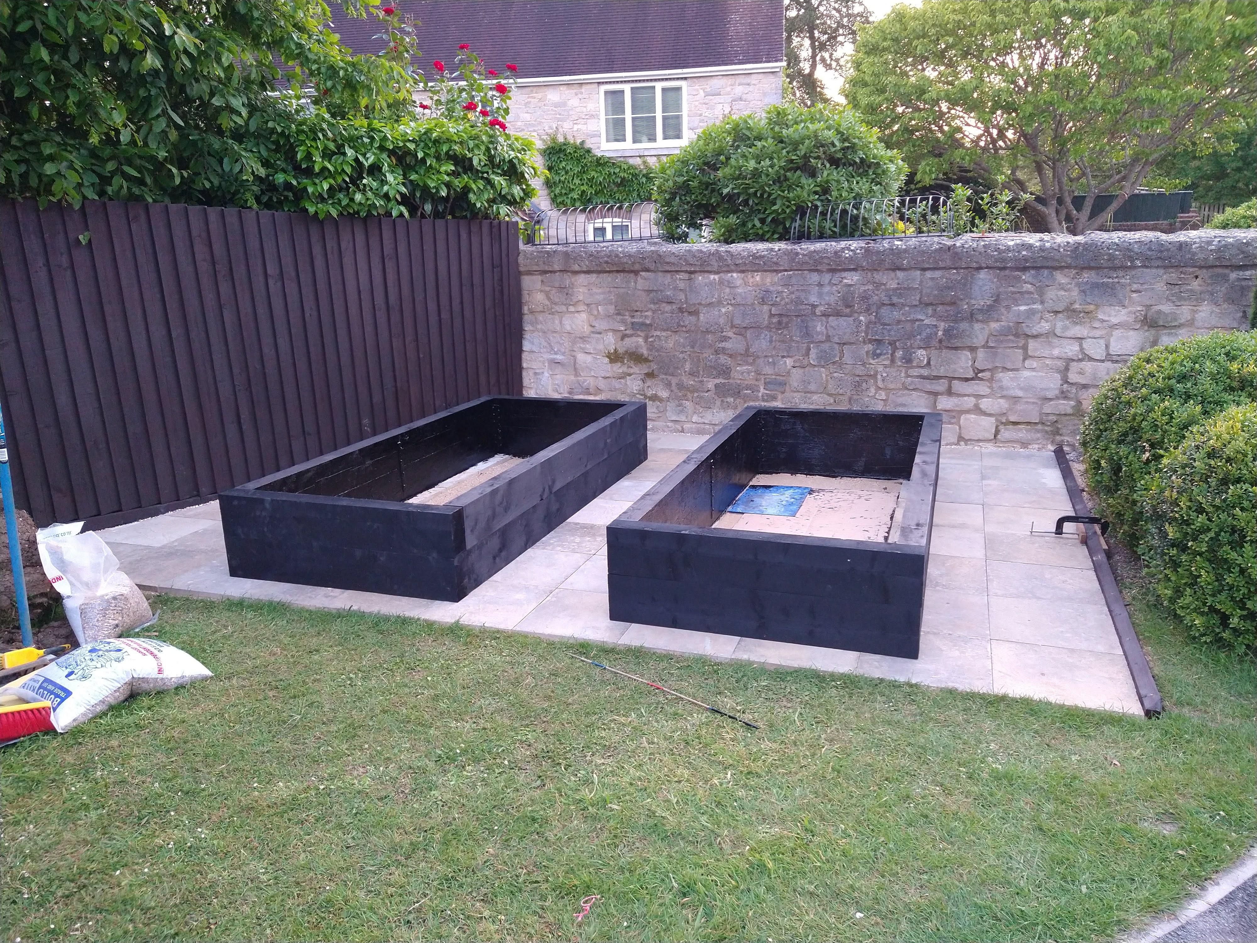

Radian Posted June 1, 2023 Author Share Posted June 1, 2023 Almost there now. 2 Link to comment Share on other sites More sharing options...
