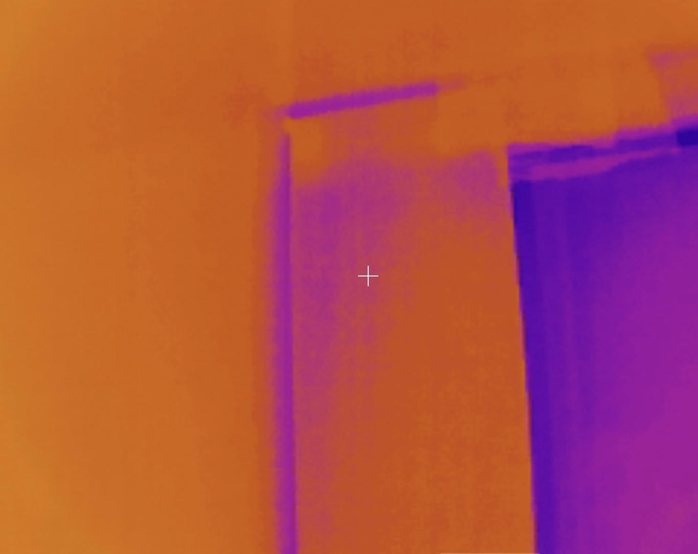

I used a thermal camera (pic attached from window) to scan the place but i can't identify the problem

If you can feel draughts it should be possible to detect them. Perhaps try Joss sticks or soap bubbles?
One possibility is convection currents. Normally rads are located under windows to minimise this. If your rads are on the opposite side of the room this can make convection currents worse.

Do you have curtains or blinds on the windows? I'm wondering if you're experiencing 'radiative cooling' where you physically feel the heat from your body radiating away to a cold surface like a window pane. An air temperature sensor won't register this effect.
If you can pull a curtain across the window you might feel the difference as the curtain will block the path to the cool surface.

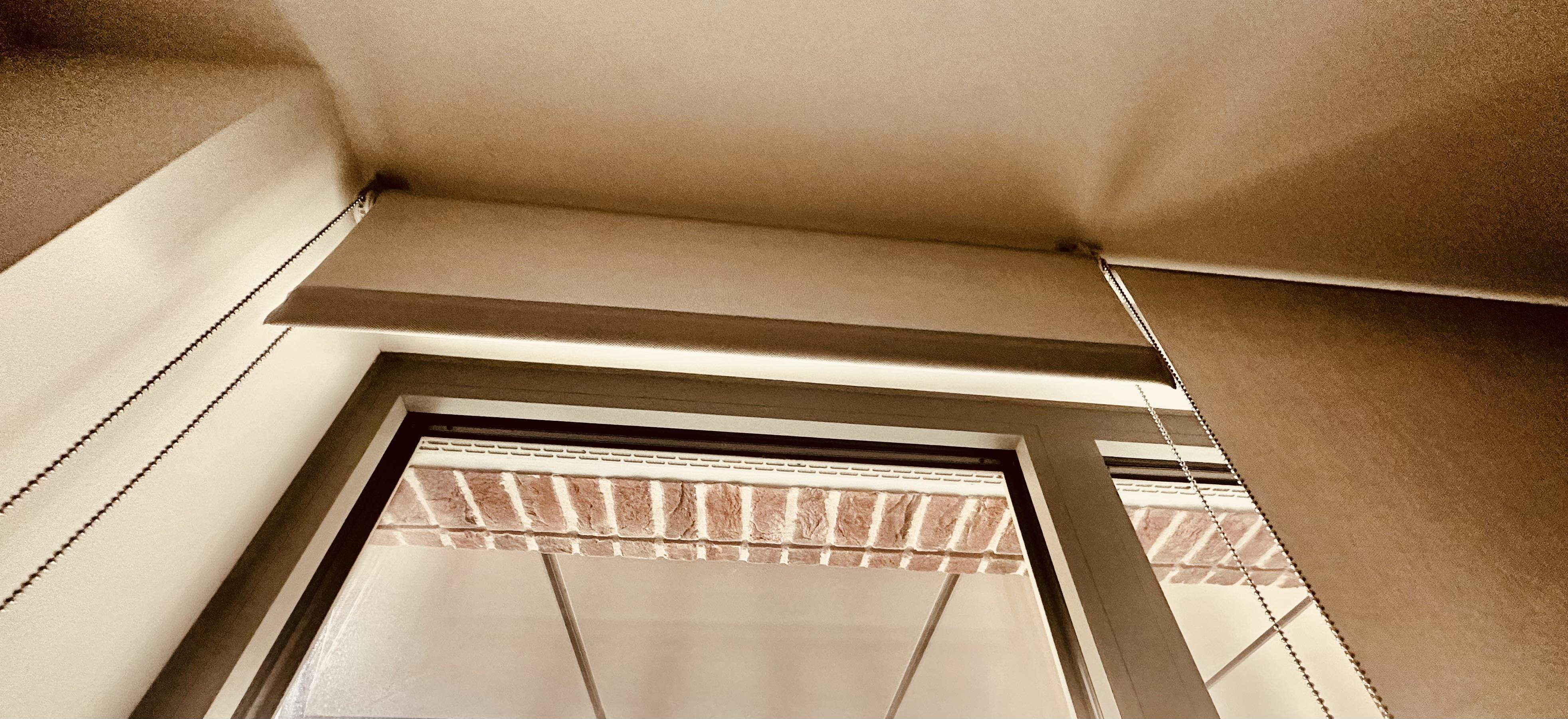

I have blinds at the moment which makes some difference when i lower em.
Never experienced such a thing in previous apartments so I believe that maybe something wrong with the windows.
The window frames probably have trickle vents in them to prevent condensation and mould. Sometimes these can be closed or partially closed but it depends on the make and you run the risk of inadequate ventilation if you shut them up too much.
I looked for vents but can’t see anything around the window frame that can be adjusted.
