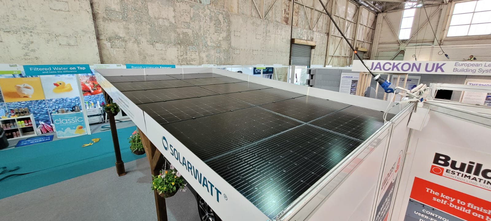

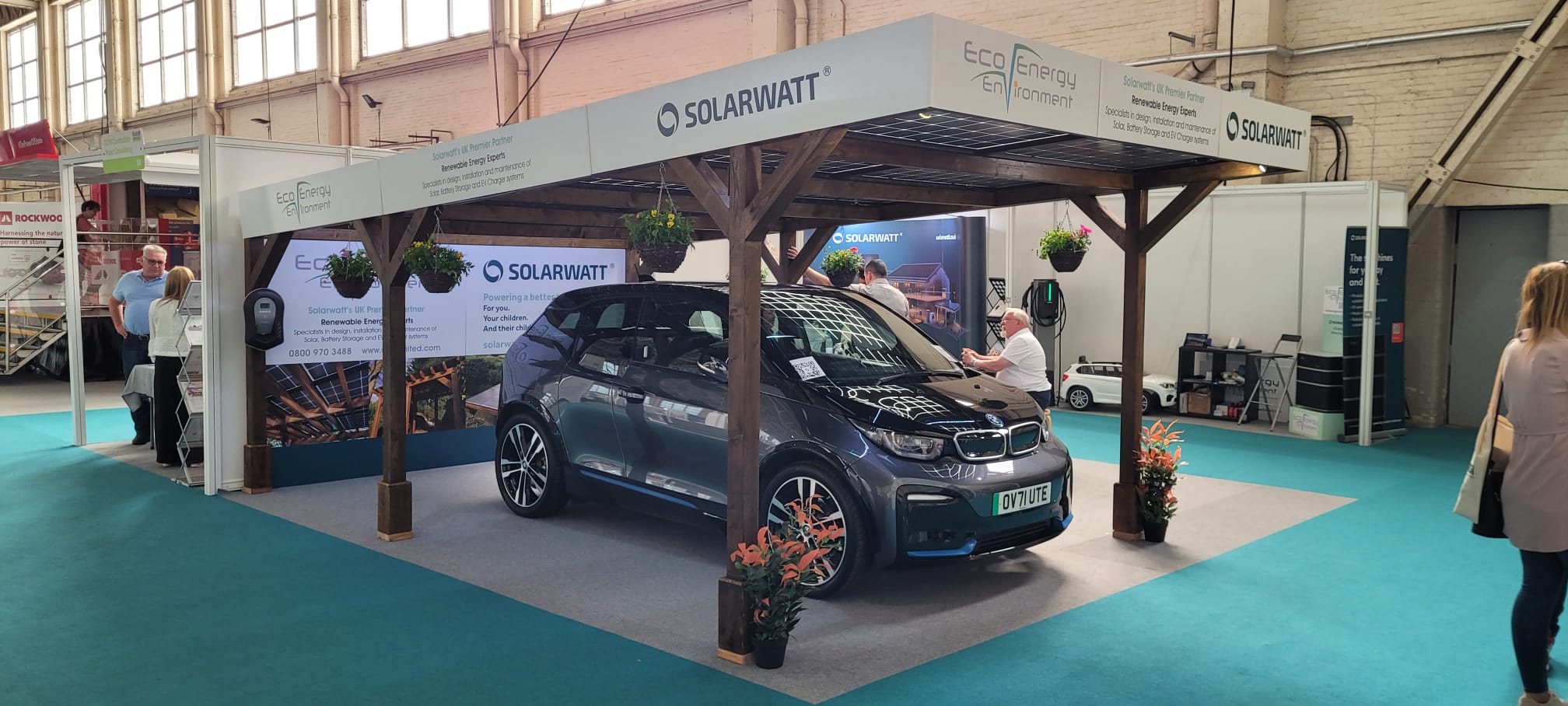

The lean to does not need a roof. the panels become a roof.
Have a read of my "solar shed"
Start at page 3 to get to the nitty gritty of the build
FCC6F01B-97CA-4BBD-BB7D-DD545196E362.thumb.jpeg.a1f50dd511233a6b8483fc69cf996b8d.jpeg6D40A2A6-39C7-41AF-A793-FE9CA77A8247.thumb.jpeg.b0aab5ed4b6a4372fc2ce57feb3ea420.jpeg
I knocked this up as a demonstrator. As Dave says the panels become the roof. This could have been a finished article and the gaps would then have been closed with black CT1 and some powder coated aluminium T sections.
They're Vision 325's also.
