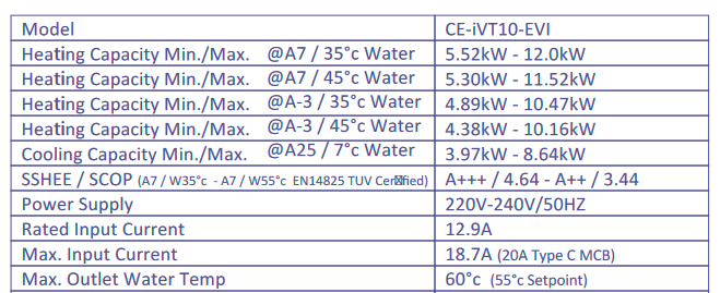

JohnMo Posted June 28, 2023 Posted June 28, 2023 Or you could get a cool energy heat pumps for about £3.5k, good for 12kW You would need a huge buffer to make use of off peak charging, if your heat demand is 12kW. Can you configure your zones so you don't need a buffer? Then you are down to £2k for general stuff to install - this could be reduced loads with careful shopping and designing. £3.5k for ASHP £250 for destrat pump £2k for your radiators So about £7.5k £6k cheaper than B.
sharpener Posted June 28, 2023 Author Posted June 28, 2023 (edited) On 28/06/2023 at 14:54, JohnMo said: Or you could get a cool energy heat pumps for about £3.5k, good for 12kW You would need a huge buffer to make use of off peak charging, if your heat demand is 12kW. Can you configure your zones so you don't need a buffer? Then you are down to £2k for general stuff to install - this could be reduced loads with careful shopping and designing. £3.5k for ASHP £250 for destrat pump £2k for your radiators So about £7.5k £6k cheaper than B. Expand Most of the time the only need for water at 55C is to heat up the rads in the master bedroom for an hour morning and evening, a 300l tank would I calc be enough for this, charged up while we heat the DHW as well using cheap/free electricity. I don't think we will get away entirely without a buffer to stop short-cycling and provide the defrost energy. Then the additional cost of expanding it to a 300l TS is not very great, I already have the pump so it could be done with two extra 3-port valves and a couple of relays. I'm of two minds if it is worth the added complication though. The £3.5k for the iVT10 is before VAT. The performance is a bit marginal, my design case is A-0.2/W55 which with a bit of extrapolation from the table below looks like the output might be in the range 10 to 10.5kW. I have in the past tried to get more detailed figures from CoolEnergy, but it's perhaps worth another go. When sent my floor plans they quoted for the bigger IVT-18, inc VAT that would be £5640 and like the Stiebel Eltron it uses R410a. Anyone got any thoughts on other budget HPs like Warmflow, Trianco, Riello? Edited June 28, 2023 by sharpener
JohnMo Posted June 28, 2023 Posted June 28, 2023 I see what you mean about being marginal. I saw them on eBay from their outlet store, which is normally about 20% off the retail price. Full warranty etc. They have other sizes there also. I looked at Trianco, and they are not inverter heat pumps, when I asked. CoP wasn't great. Riello are rebadged Midea monobloc ASHP. The specs look ok, but no experience, they come up on eBay for good prices. Grant could be worth a look also.
