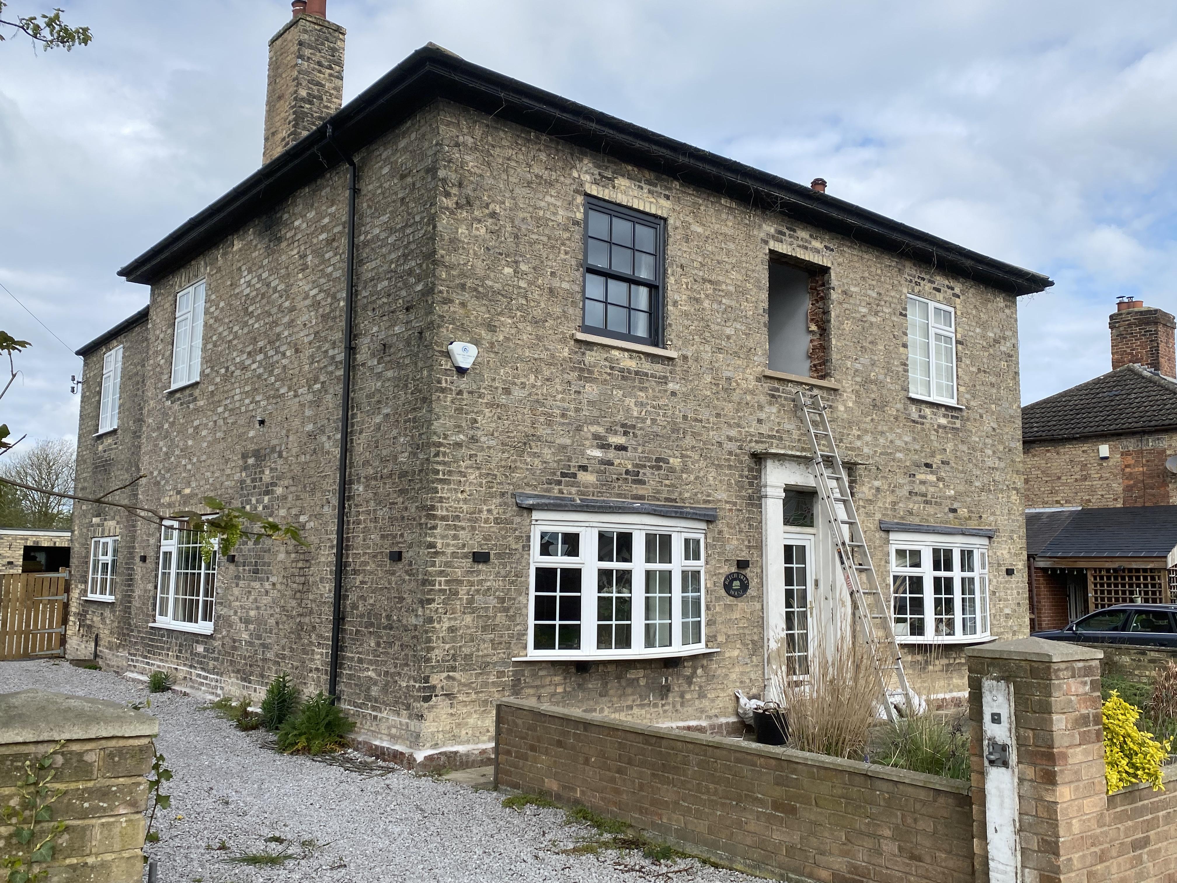

jayc89 Posted April 29, 2023 Author Posted April 29, 2023 First window out and cill poured. Will sponge off and get the new window in tomorrow morning. The 80s uPVC frames are featherweight in comparison to the new ones!
jayc89 Posted April 30, 2023 Author Posted April 30, 2023 11 hours ago, Dave Jones said: photos please. I'll get one tomorrow. 2nd, of 3 windows, is out and cill poured so it will be a nice before, during, after shot. 1
jayc89 Posted May 1, 2023 Author Posted May 1, 2023 Today’s turned into a bit of a shitshow. Dry fitted the second window to find the spring in one of the sash runners has jumped off so we have a drifting sash. Looks like we need a special tool to pull it out of the housing and back onto the cam. Went to take out the third window and found a massive gap above the old wooden lintels, and the original sash window head still floating around up there. God knows how it hasn’t all come crumbling down yet, but I’ll be ordering some new lintels tomorrow… Day off tomorrow, lintels hopefully here come Wednesday and hope to have the rest of them in by the weekend.

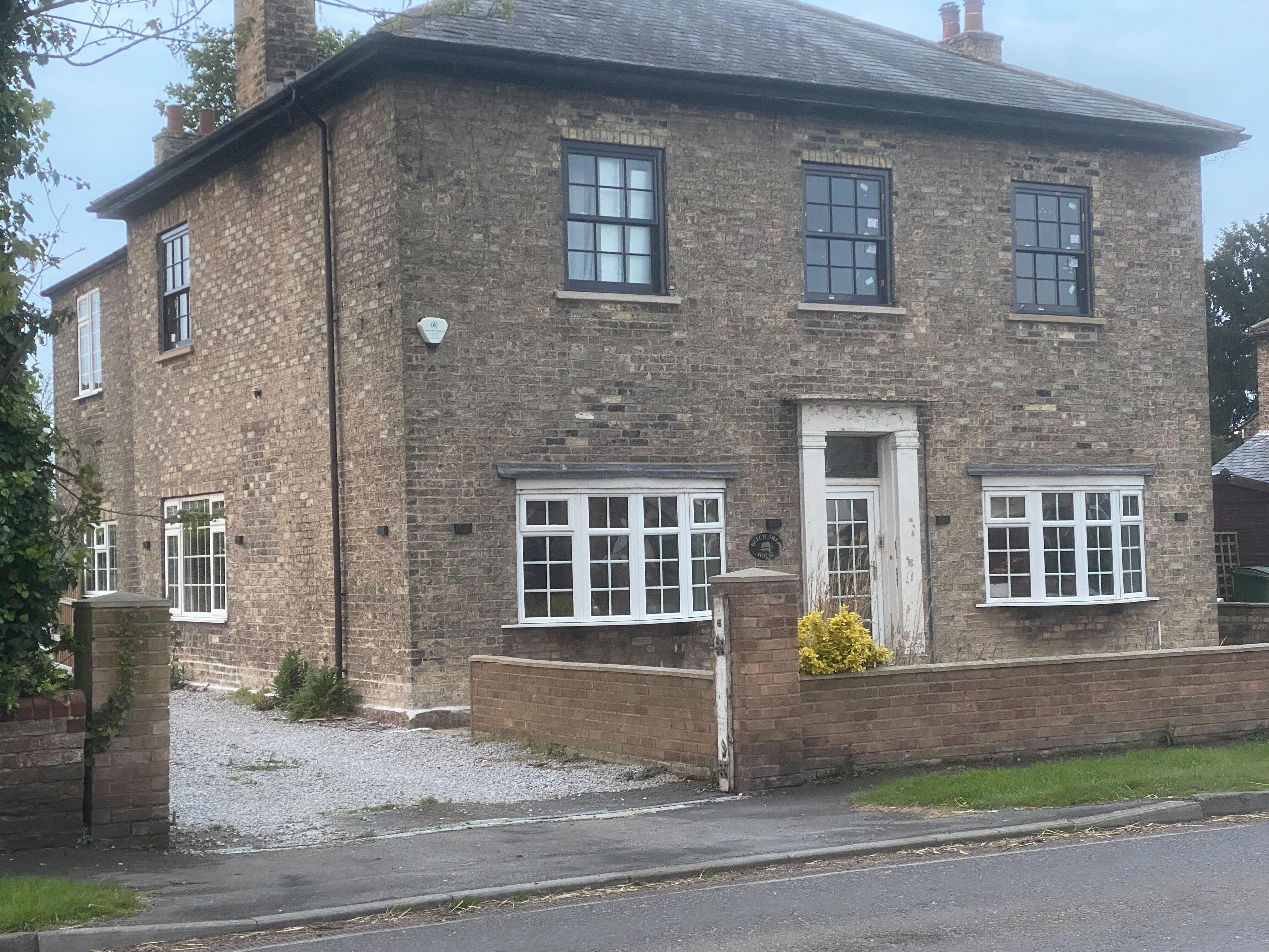

jayc89 Posted May 9, 2023 Author Posted May 9, 2023 Upstairs windows done. Need to find a builder to change the openings for the downstairs ones to go into now. Seriously starting to consider doing that work myself too, finding a decent builder who has the understanding and appreciation to work on older properties seems a real struggle around my area.
