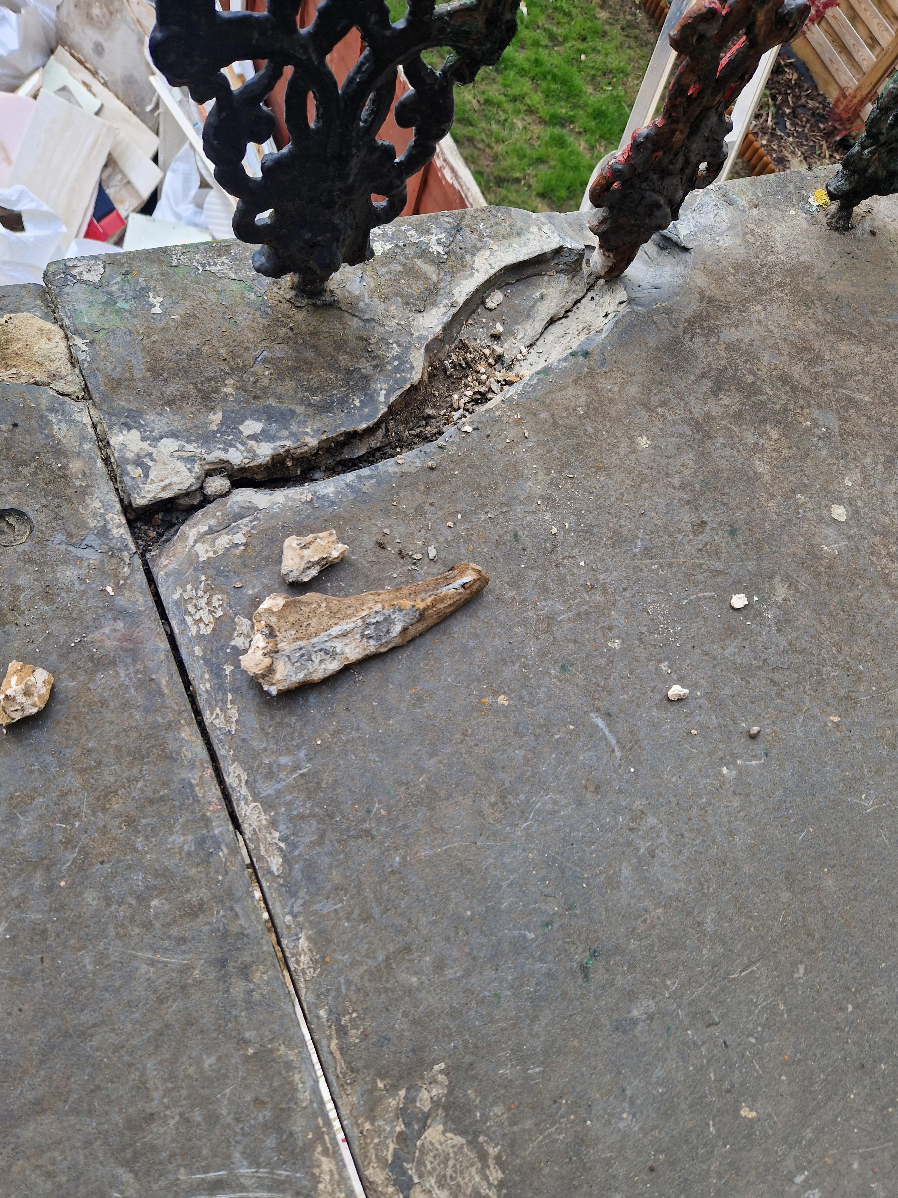

Erik79 Posted April 16, 2023 Share Posted April 16, 2023 We have a slate balcony that has suffered years of water damage. One of the edges has the most extensive damage, borderline compromising the structural integrity of the slab as directly underneath that edge is one of the pillars holding the balcony (the crack goes all the way almost the depth of the slab in that place). We therefore need a solution that will not only provide waterproofing but also structural bonding. I have got a couple of quotes to use a waterproofing system based on PMMA resin. This will cover the whole balcony and the contractor says that it will also provide structural repair once it is applied and cured within the slate cracks. The (only) stonemason that came around to see it suggested to insert reinforcement bars prior to waterproofing. I want a good solution but I also dont want to do unnecessary repairs if the PMMA resin is the solution that can offer both waterproofing and structural integrity? Link to comment Share on other sites More sharing options...
TonyT Posted April 16, 2023 Share Posted April 16, 2023 Can’t offer any help but make sure the metal work is not rusting, the rust expands the hole the metal work sits in , leading to a route for water. what about lithomex https://heritagestonemasonedinburgh.co.uk/our-work/lithomex-stone-repairs-edinburgh/ Link to comment Share on other sites More sharing options...
Erik79 Posted April 16, 2023 Author Share Posted April 16, 2023 13 minutes ago, TonyT said: Can’t offer any help but make sure the metal work is not rusting, the rust expands the hole the metal work sits in , leading to a route for water. what about lithomex https://heritagestonemasonedinburgh.co.uk/our-work/lithomex-stone-repairs-edinburgh/ You are right on that one, the original entry seems to be at the base of the railing and expanded from there. Previous owner seem to have tried to DIY the crack by some form of resin and cement mix but obviously it failed and led to more damage. We are restoring the railings as well along with the slate slab. I wasn't aware of lithomex I will look it up. Link to comment Share on other sites More sharing options...
