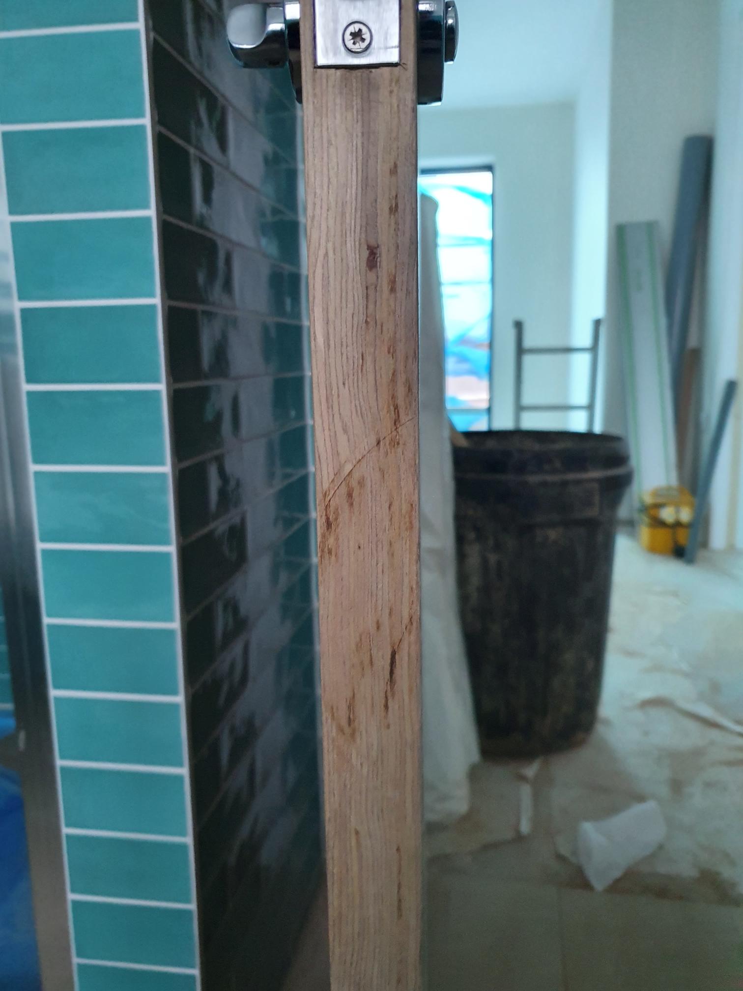

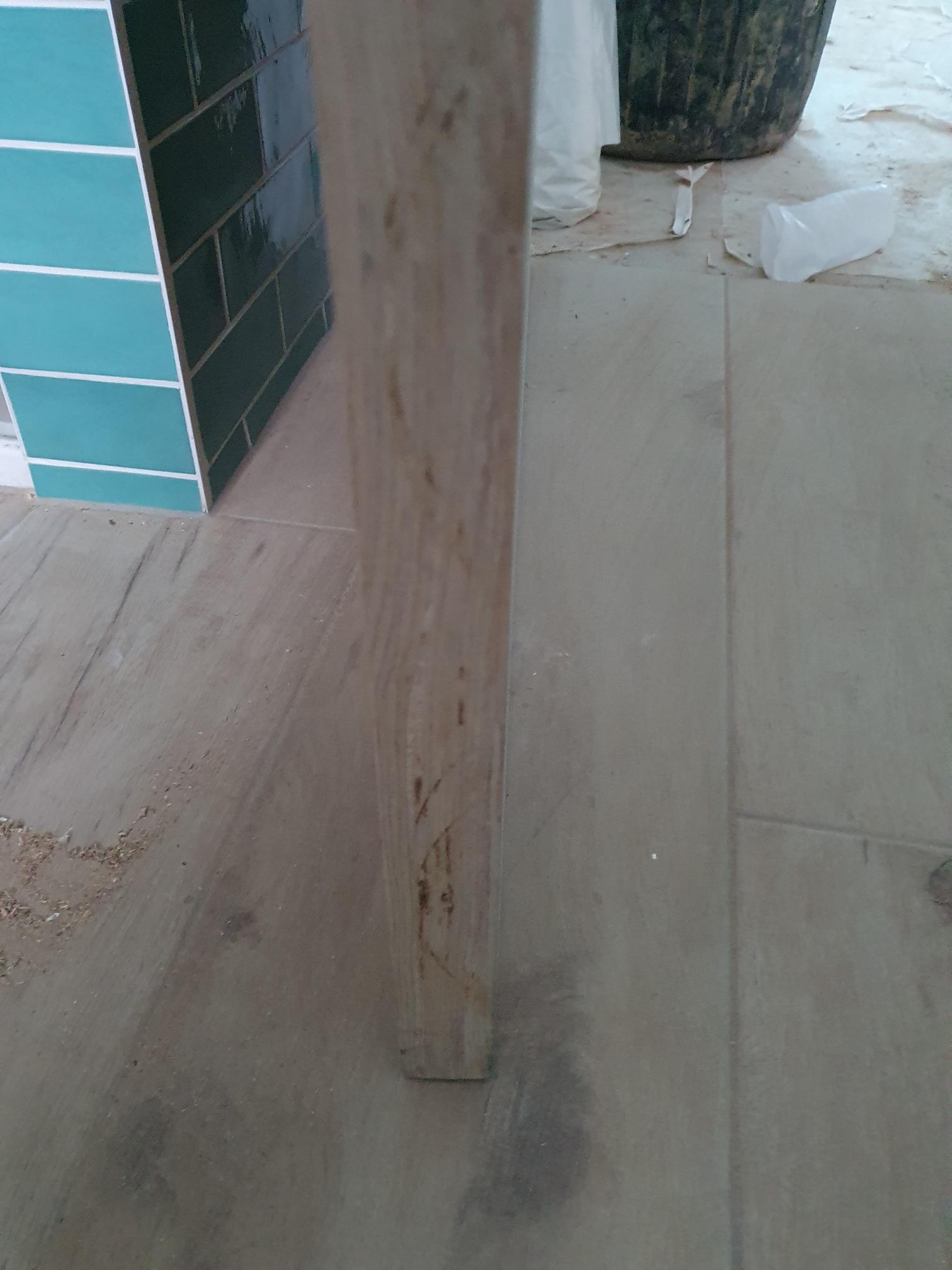

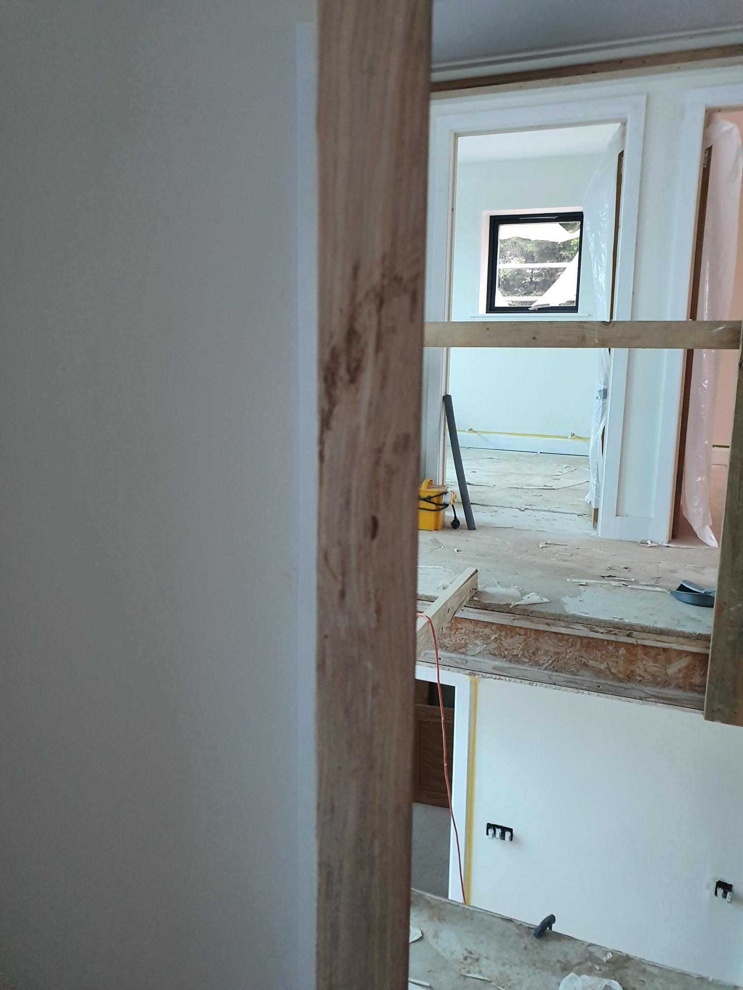

Moonshine Posted April 14, 2023 Share Posted April 14, 2023 Looking over the chippies work this morning and there are significant markings on door edges where it's been cut. Can anything be done? Link to comment Share on other sites More sharing options...
Dave Jones Posted April 14, 2023 Share Posted April 14, 2023 sand it ? Looks like they did the lazy approach, old blade and a single pass. They on a price ? Link to comment Share on other sites More sharing options...
PeterW Posted April 14, 2023 Share Posted April 14, 2023 Single pass with a planer set to 0.5mm will tidy that up Link to comment Share on other sites More sharing options...
