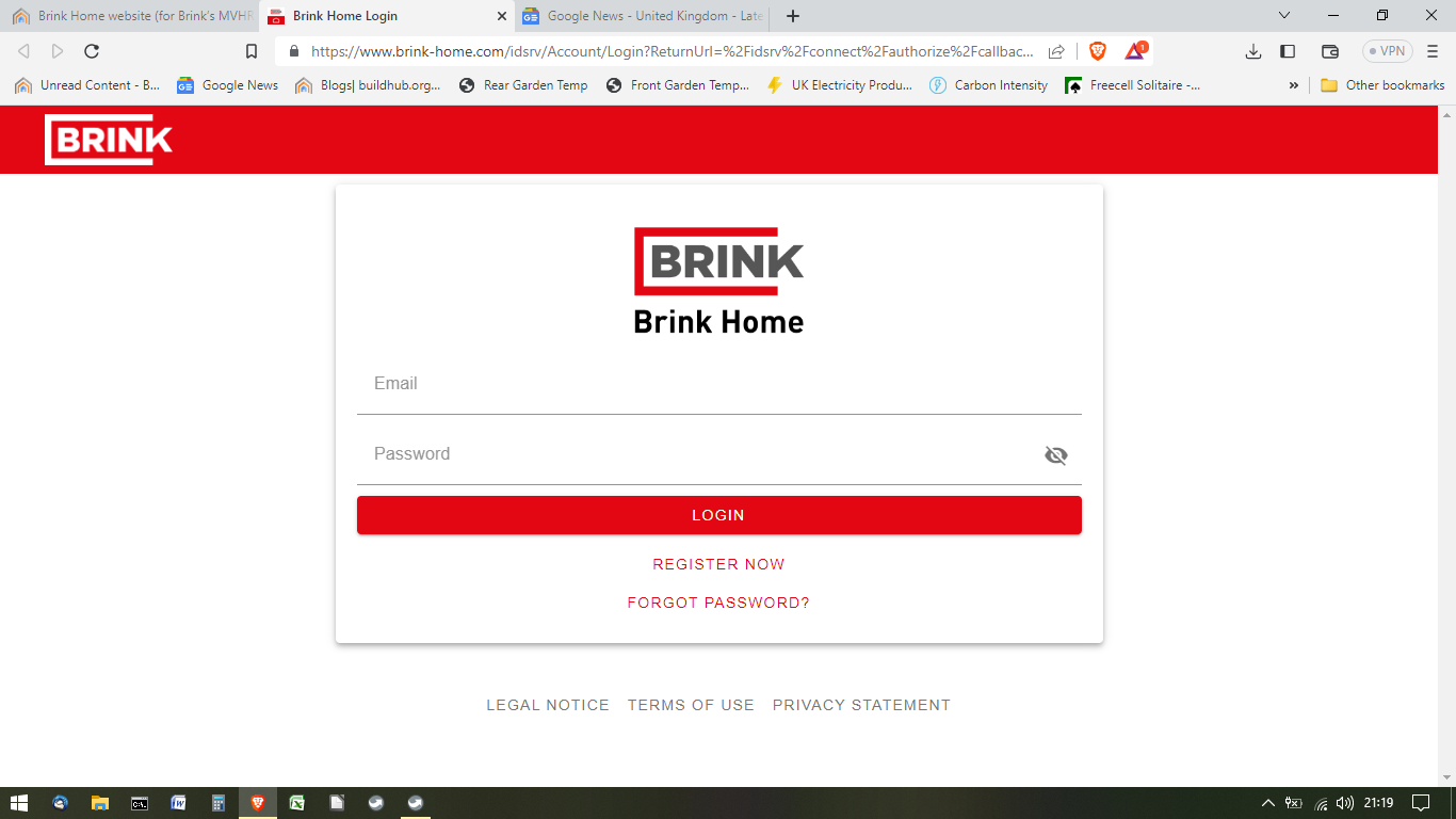

Brink Home website (for Brink’s MVHR app) down?
I clicked on your link and it took me to this:
But not having a unit, or account, can't go any further.
Yes, I can get that far too. Then I log on, get to the next screen and there I’m told “system offline”, but not sure if that’s my end of the connection or theirs.
