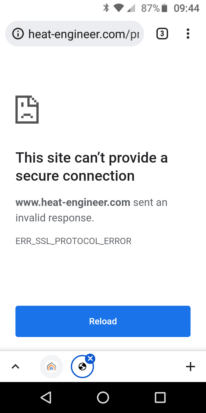

sharpener Posted April 7, 2023 Author Share Posted April 7, 2023 What do ppl think of the Heat Engineer s/w? £10 for a one-off survey seems almost too good to miss and the HelpGuide a lot of useful information. But if there are negative views here I might not spend any more time on it. Link to comment Share on other sites More sharing options...
SteamyTea Posted April 7, 2023 Share Posted April 7, 2023 Not a lot Link to comment Share on other sites More sharing options...
