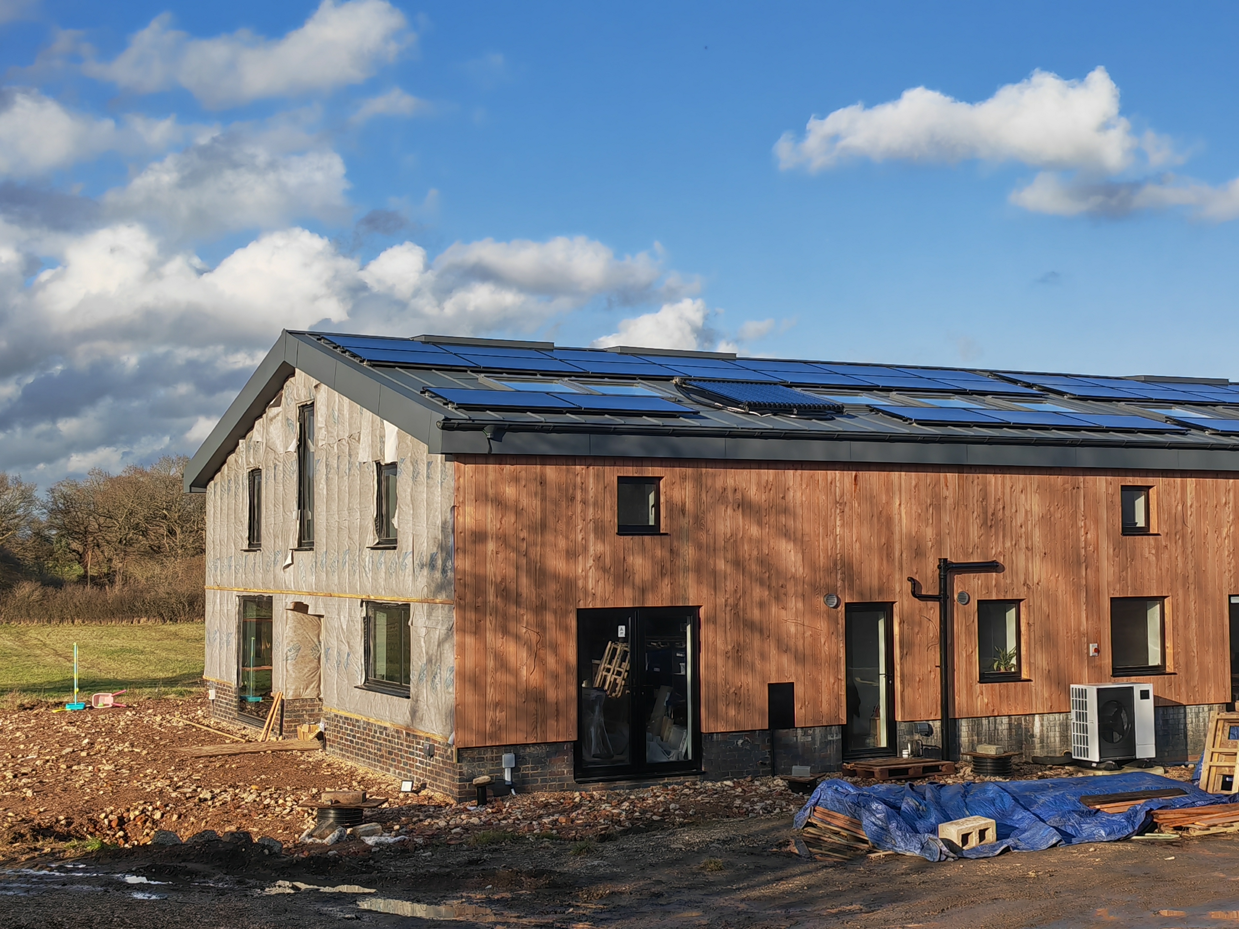

mattman Posted March 31, 2023 Posted March 31, 2023 Hi everyone I just wanted to introduce myself. My family and I are just coming to the end of a self-build steel framed barn conversion which started back in 2019. We only have minor things left to do. I project managed and also designed the entire house and my wife and I did all the planning application. I'm not an architect - it was more the fact we were left in the lurch by a really poor planning consultant/architect that we decided to take over ourselves and pleased we did. Our house is fairly standard block and brick masonry cavity-wall construction and we have quite large 150mm block cavities (concrete blocks for the external skin and thermalites on internal skin) full-filled with 150mm breathable mineral wool insulation, plus a further 50mm waterproof mineral wool externally behind cladding (crucially still allowing plenty of ventilation behind cladding), 100mm PIR celotex in floor (would have done more in floor but we're limited by potentially low ceiling heights), 200mm PIR celotex warm roof with an airtight VCL. We had a builder build our foundations and shell and he also put up some plasterboard on internal walls, we have a full wet plaster on all external walls. We had a separate roofing company do our metal roof, a cladding company have done our larch cladding and electrician and plumber are close to finishing our second fix items. My wife and I took over from the builder after he left. I then spent many weeks applying a cement lime "parge" coat on the inner face of all external walls (prior to our plasterer doing the full wet plaster), and I applied air tight tape everywhere in an attempt to make the house as airtight as possible - it was hard because our builder did not see the importance of air tightness. I've also built an exposed brick wall spanning half the entire downstairs and we also fully prepared the entire groundfloor for our concrete pour - doing the insulation, membrane and steel mesh etc, as well as doing some of the insulation and VCL in the warm roof. We had a concrete company pour and powerfloat the concrete slab which acts as our finished floor surface, as well as being a good thermal mass. Our house is heated solely by an 8.5kW ASHP and costs very little to run, which does all our hot water and our space heating, via wet underfloor heating in our concrete slab on the ground floor (no heating upstairs aside from a couple of electric towel rails). We also have solar thermal tubes which isn't doing much at the moment with the cloudy rainy weather and we also have 7.6kW solar PV on our roof which will be connected to an inverter and batteries later in the year. We also have MVHR. We just had our air tightness test done and we scored 2.5 m³/hr.m² @50Pa for the standard air permeability air tightness test, and 1.96 ach/hr @50Pa under a passivehaus air tightness test (although I can't use the Passivehaus test result for my SAP calcs). Dealing with non-straight original timber roof perlins and other characteristics in the original barn, and being masonry construction meant getting it air tight was a challenge.. plus it was a bit of a battle dealing with most of the trades who did not understand the importance of air tightness - our main builder thought we would never be able to open our windows! And it was solely me doing any kind of air tightness work. I'm not sure if 2.5 for a masonry house is ok or not?? I had hoped it might be slightly better after all the time I spent but I'm glad it is lower than 3 though because we have an MVHR and these work better at 3 or below (and at the end of the day it is just a number). House appears to stay warm, costs virtually nothing to run, no mould or condensation thanks to the MVHR which also evenly distributes the warmer air downstairs to all rooms upstairs, so overall really happy. It's been a lot of extremely hard work, especially with three quite young daughters, and working full time. Sorry for the long introduction. Attached is a pic. Matt 5

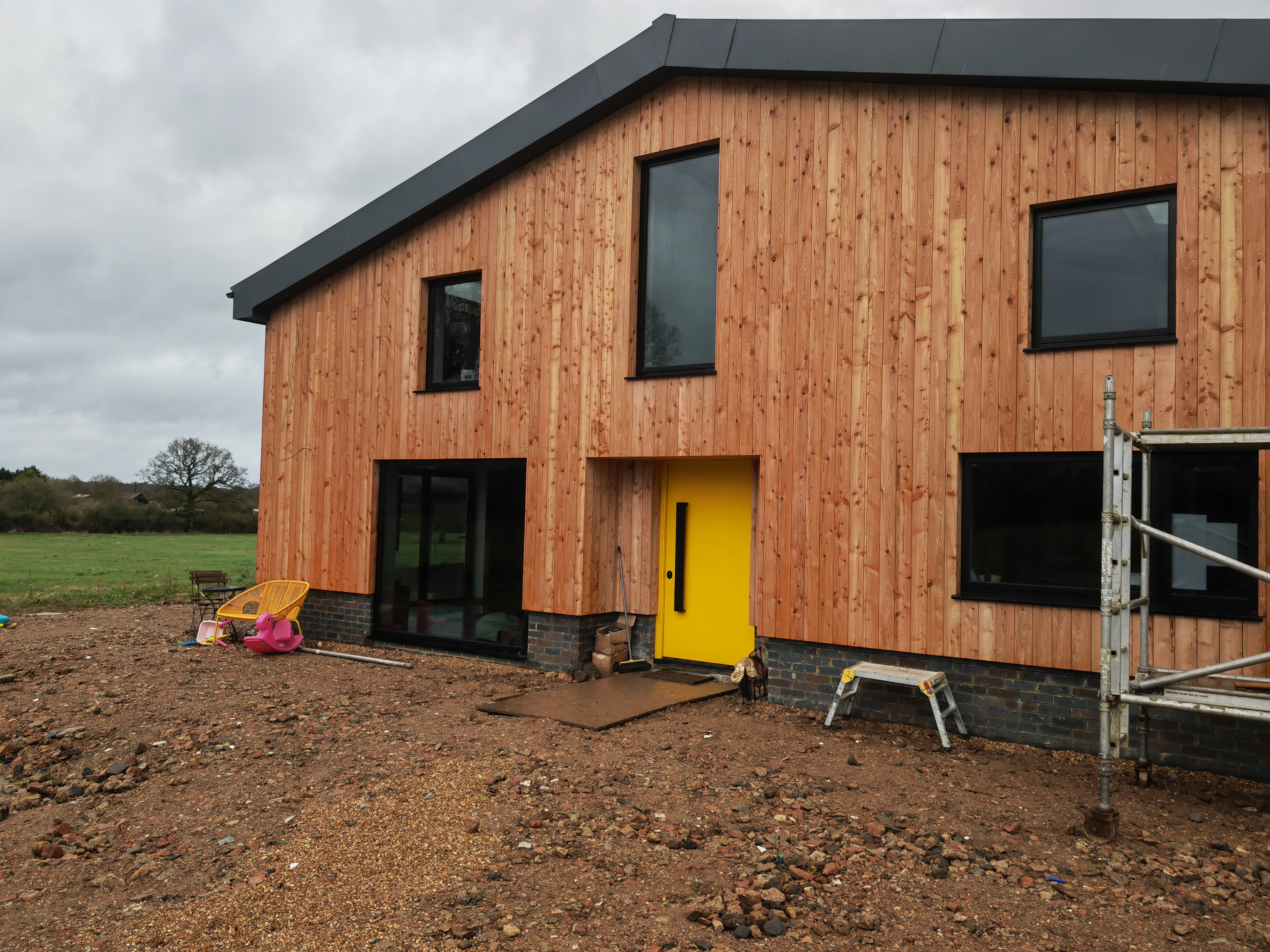

mattman Posted March 31, 2023 Author Posted March 31, 2023 Thanks for your reply. Here's a pic from a few weeks ago. It's still a bit of a mess. 2
mattman Posted March 31, 2023 Author Posted March 31, 2023 It used to be an agricultural steel shed. What kinds of air tightness scores are people getting on a masonry build?

IanR Posted April 5, 2023 Posted April 5, 2023 Hello @mattman, and welcome! Lovely project. I did very similar myself, starting in 2016, although with a timber frame rather than masonry. You appear to have put your PV on rails. What did you connect the rails to the standing seam with? Did you consider fixing direct to teh standing seam, without the rails. I've not made my mind up yet, so am yet to install PV.

mattman Posted April 6, 2023 Author Posted April 6, 2023 On 05/04/2023 at 18:42, IanR said: Hello @mattman, and welcome! Lovely project. I did very similar myself, starting in 2016, although with a timber frame rather than masonry. You appear to have put your PV on rails. What did you connect the rails to the standing seam with? Did you consider fixing direct to teh standing seam, without the rails. I've not made my mind up yet, so am yet to install PV. Expand Thanks. Do you have any pics of yours? We were lucky enough to inherit half of this barn in an amazing spot (my brother-in-law's family inherited the other half, so it's a semi detached barn conversion - luckily we get on really well! However next on my DIY list is landscaping - garden fences, small trees and walls, so we can make it more private as it is all a bit open outside at the moment). We each sold our houses and financed the build of both halves - lived in a static caravan on site for two years. Regarding our solar panels I'm pretty sure from memory they were "S5" clamps and Renusol rails. I'm not sure why we put them on rails - our installer specified the rails - I think possibly because it gives a bit more breathing space above the metal roof, as it can get quite hot to touch in the summer - although the DC cables are touching the metal roof so our electrician seemed to think it would be fine - I think using the rails made it easier to line up where we wanted the panels etc. We don't seem to get many birds on the roof but if we do I will have to have some kind of bird proofing put on too. We plan to get them connected to an inverter and battery storage in the next couple of months hopefully. Just waiting for our G99 application.

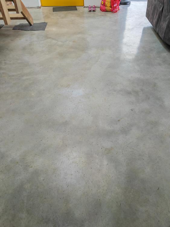

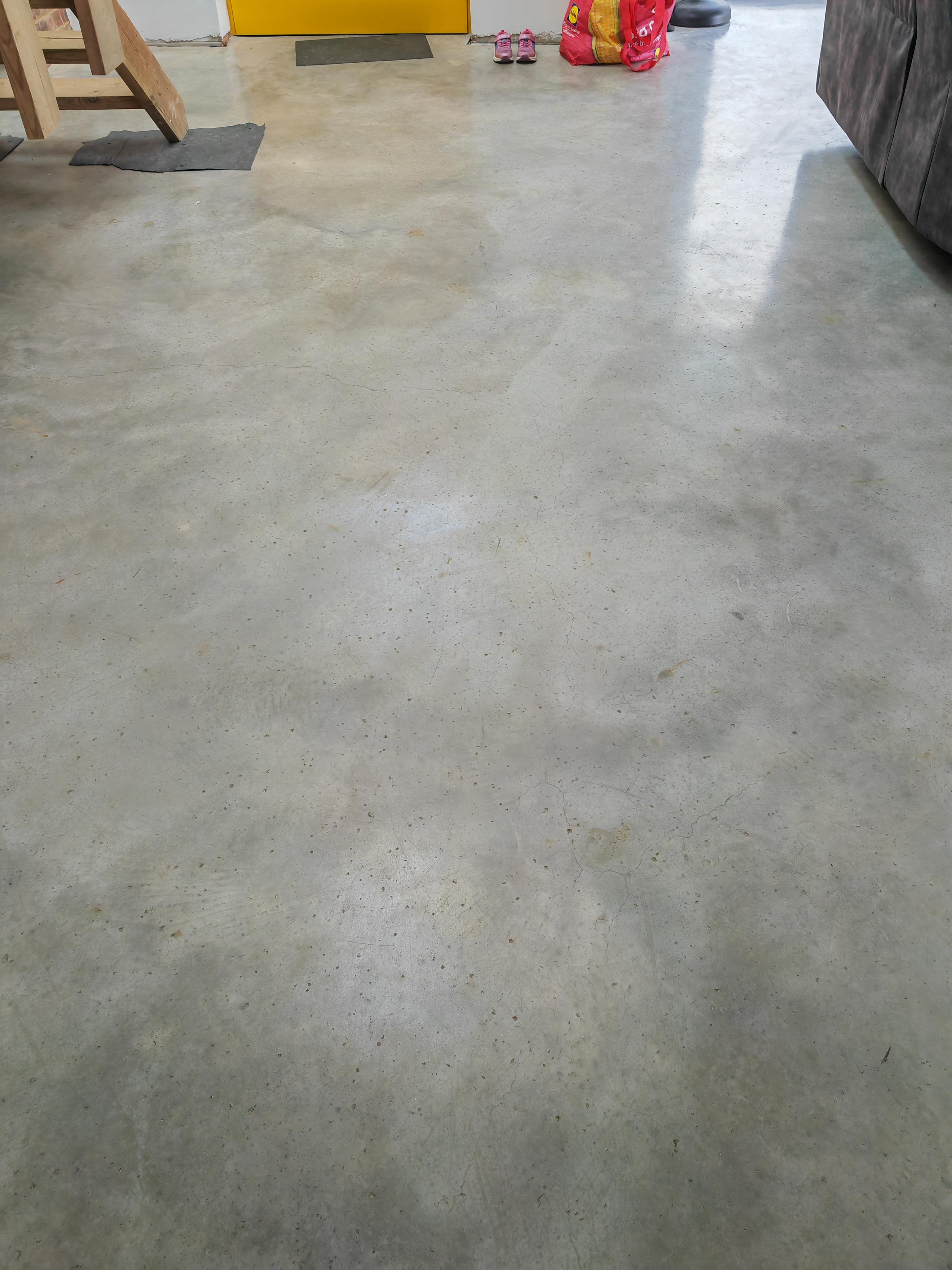

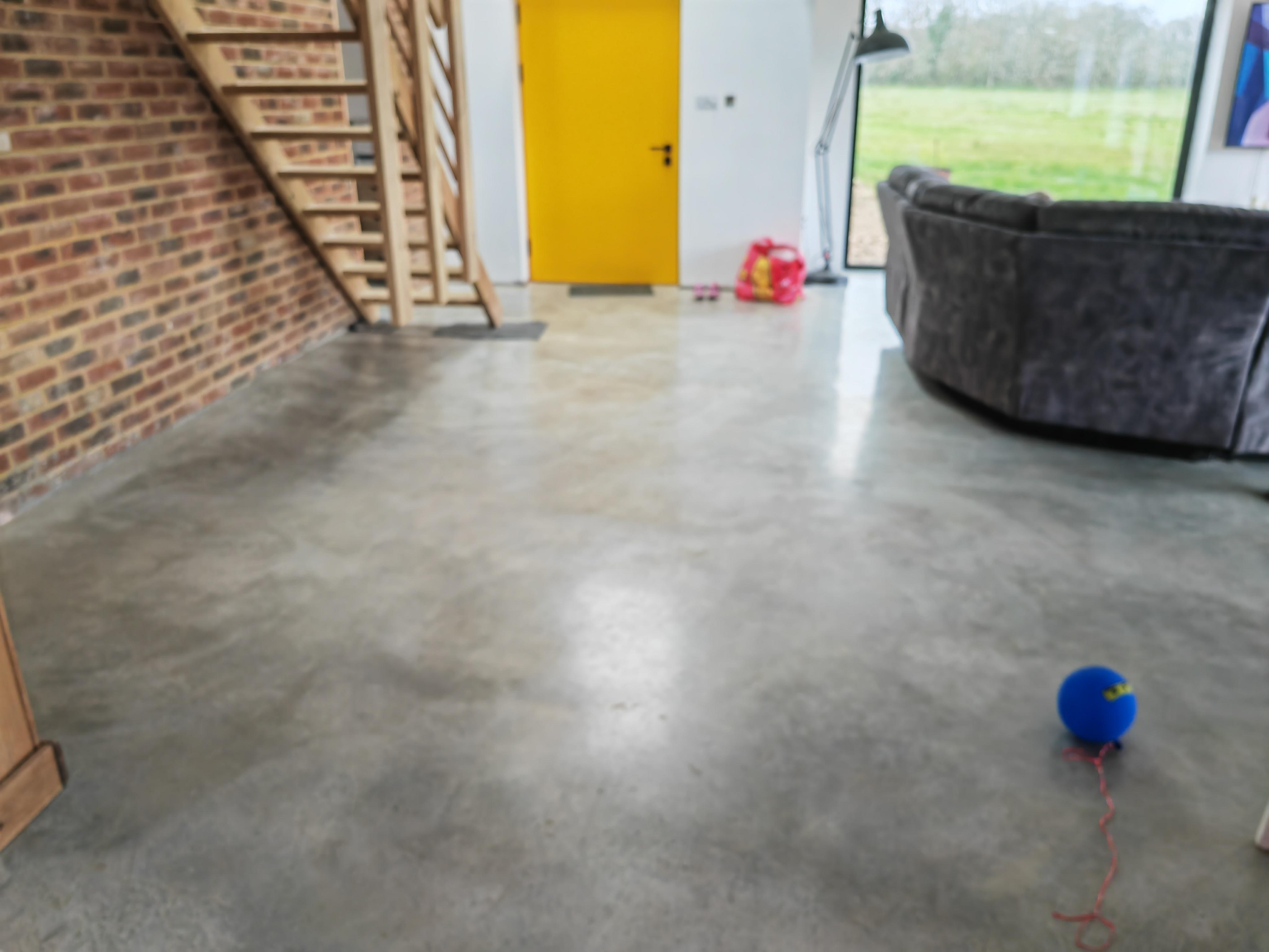

mattman Posted April 6, 2023 Author Posted April 6, 2023 Thank you for all the kind words from everyone. I should definitely have started posting when we started the project - time flew by - it was very hectic most days, doing my day job full time and also trying to manage the build as best often late in the evening/nights), and also spending time with and looking after our children. Not sure how we did it. Here's a pic of our floor. It looks a bit "rougher" (not quite as shiny) in person but we like it and all its imperfections. 1
SamSmith Posted April 6, 2023 Posted April 6, 2023 Thanks for the pictures. It's something we may consider as the costs for polishing are now in the realms of ridiculous. We prefer a more matt finish and the imperfections will hopefully give it more texture.

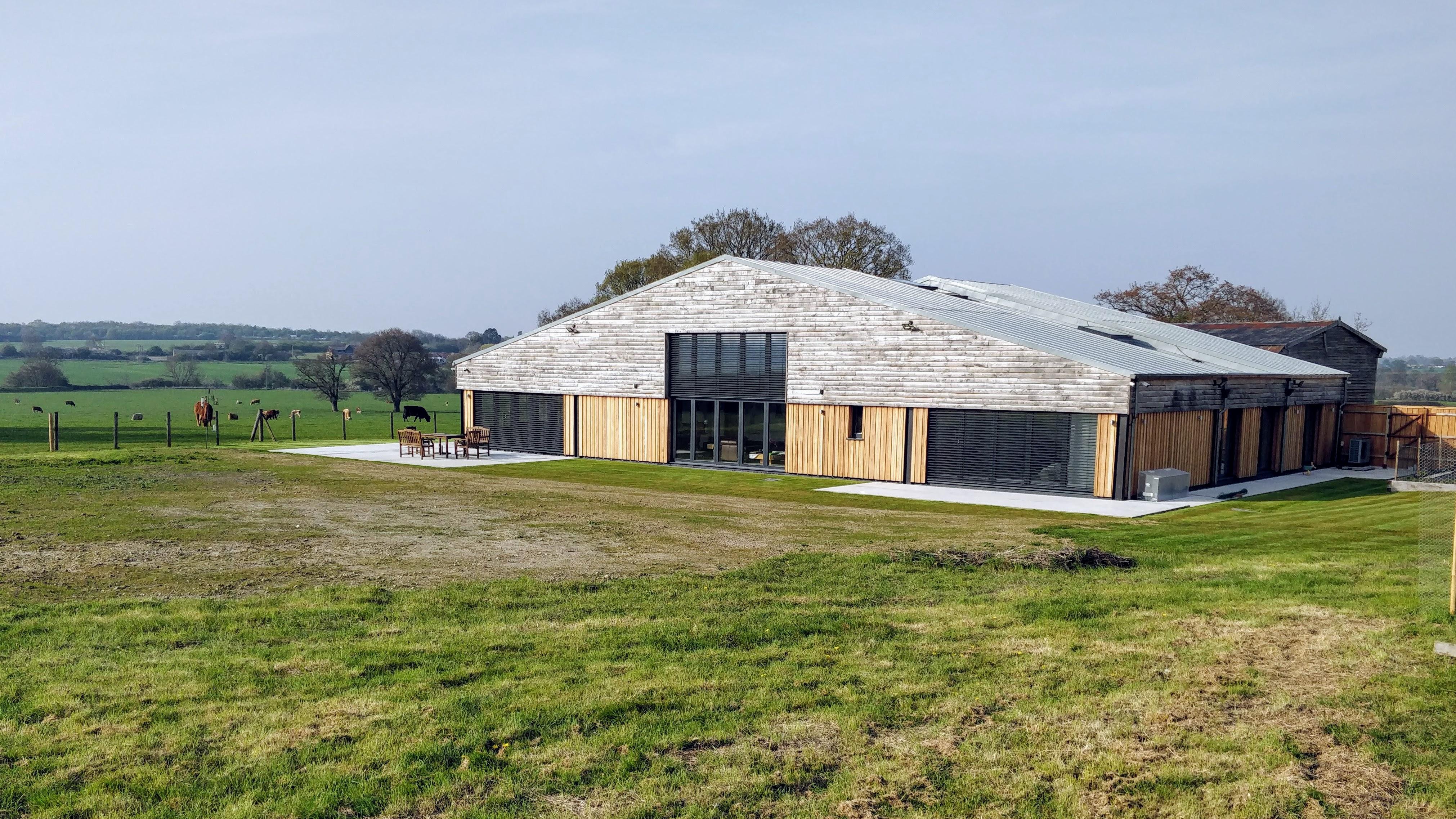

IanR Posted April 7, 2023 Posted April 7, 2023 (edited) On 06/04/2023 at 13:34, mattman said: Do you have any pics of yours? We were lucky enough to inherit half of this barn in an amazing spot (my brother-in-law's family inherited the other half, so it's a semi detached barn conversion - luckily we get on really well! However next on my DIY list is landscaping - garden fences, small trees and walls, so we can make it more private as it is all a bit open outside at the moment). Expand Here's ours, been in for 5.5 years now. This pics from a few years back, just after we cleared the debris from the build and started to get it seeded. Quote Regarding our solar panels I'm pretty sure from memory they were "S5" clamps and Renusol rails. Expand I've settled on going with the S5 also, but am hoping to go without the rails. I'm just looking for a few similar installations to get a bit more confidence in attaching in that way Edited April 7, 2023 by IanR 2
mattman Posted April 7, 2023 Author Posted April 7, 2023 On 07/04/2023 at 00:01, IanR said: Here's ours, been in for 5.5 years now. This pics from a few years back, just after we cleared the debris from the build and started to get it seeded. I've settled on going with the S5 also, but am hoping to go without the rails. I'm just looking for a few similar installations to get a bit more confidence in attaching in that way Expand Looks amazing Ian! I really like the design.
mattman Posted April 7, 2023 Author Posted April 7, 2023 On 06/04/2023 at 18:14, SamSmith said: Thanks for the pictures. It's something we may consider as the costs for polishing are now in the realms of ridiculous. We prefer a more matt finish and the imperfections will hopefully give it more texture. Expand Yeah we got some silly quotes for a fully polished floor. I think I read about or saw a program where someone powerfloated their concrete instead of polishing it and it seemed to be what we were after and less labour intensive so cheaper. We ended up going with a local concrete company who worked with a team who did the power floating, although my wife and I did all the labour to get the floor ready for the concrete pour.. Ie insulation, membrane and the steel mesh. It was half the price of polishing. It is quite an industrial look but the imperfections do give it texture and character. We love it. A lot of visitors comment how they like it too. It does get a few tiny hairline cracks but it actually blends in and adds to the character. For a few weeks after we had it laid it was very "smeary" and blotchy in appearance, like a white haze and I thought we had made a mistake getting it but the haze disappeared after several weeks. It's apparently part of the curing.
cheekmonkey Posted May 9, 2023 Posted May 9, 2023 On 07/04/2023 at 00:56, mattman said: Yeah we got some silly quotes for a fully polished floor. I think I read about or saw a program where someone powerfloated their concrete instead of polishing it and it seemed to be what we were after and less labour intensive so cheaper. We ended up going with a local concrete company who worked with a team who did the power floating, although my wife and I did all the labour to get the floor ready for the concrete pour.. Ie insulation, membrane and the steel mesh. It was half the price of polishing. It is quite an industrial look but the imperfections do give it texture and character. We love it. A lot of visitors comment how they like it too. It does get a few tiny hairline cracks but it actually blends in and adds to the character. For a few weeks after we had it laid it was very "smeary" and blotchy in appearance, like a white haze and I thought we had made a mistake getting it but the haze disappeared after several weeks. It's apparently part of the curing. Expand @mattman i was about to post something later in foundations forum. we want a power floated concrete finish floor in our barn conversion but struggling to work out the slab make up that best works. we have a SIP build around an old concrete frame barn but it has a fair bit of proposed new steel work to hold it up. We have proposed ASHP & underfloor heating (single story apart from small mezz) architect had originally conceived a raft foundation but they expected us to screen the top therefore 75mm - talking to concrete people they say the top coat needs to be more like 150mm. they then said that they dont think that would work with UFH. my thought at the moment is: - strip foundations with block/brick stub walls that the SIP fixes to. (including internal walls) The steels bolt to these walls also, or small concrete pads - slab make up is then hardcode/sand/membrane/insulation/steel mesh/UFH (on top of mesh to in top part of slab)/150mm concrete that's power floated. All this can happen after the SIP is built so in the dry & won't get damaged after No-one seems to want to help advise what's best so i'm at the point to making the choices myself. Interested to get your experience on this & if you followed a similar make up at all. TIA Pete
