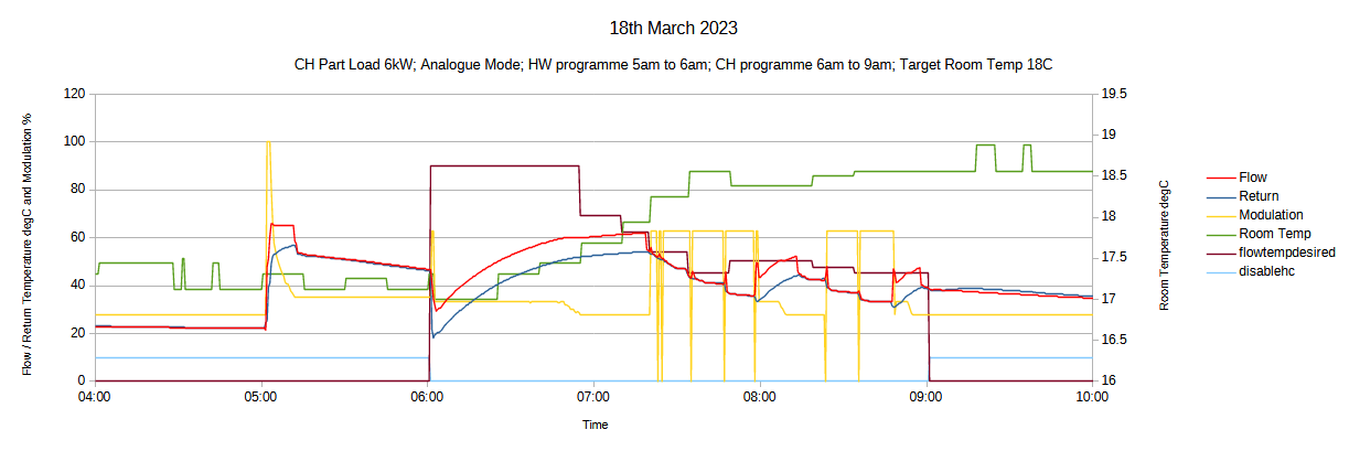

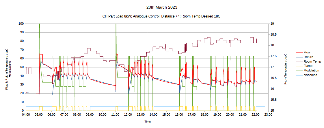

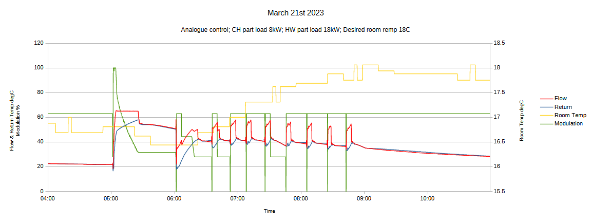

PiMike Posted March 18, 2023 Author Posted March 18, 2023 OK the rabbit hole just got deeper ... I changed the room thermostat mode to Analogue and set the CH Part Load to 6kW which is what I estimated the property's heat loss to be. There is also a +/-5 Distance setting which affects the response time to compensate for the distance between thermostat and heat source but I left that at zero for now. The obvious differences over 2-point mode are the behaviour of flowtempdesired and disablehc. The weather is now too warm for a proper evaluation but I would say this is looking promising. What does the panel think? Should I increase the CH Part Load? Mike
Radian Posted March 20, 2023 Posted March 20, 2023 On 18/03/2023 at 11:02, PiMike said: I changed the room thermostat mode to Analogue and And... general note, to be properly scientific you need to adjust one parameter at a time 😉 Remind me what you expect disablehc to be - is it the changeover from DHW to space heating? I've been guessing that your DHW is timed to come on at 5AM at full load. It looks better now although you could do with dropping flowtempdesired to 55 or 50. The only question in my mind is why modulation keeps briefly dropping to zero. You might want to plot the State number to see what the boiler is actual doing at these points.
markocosic Posted March 20, 2023 Posted March 20, 2023 Nice work 🙂 Presumably: Analogue = proportional control for room influence 2-point = PWM control for room influence That could be code leftover from the days of boilers that fired at a fixed rate or one of a handful or rates rather than fully modulating?
PiMike Posted March 20, 2023 Author Posted March 20, 2023 23 minutes ago, Radian said: And... general note, to be properly scientific you need to adjust one parameter at a time 😉 Yes agreed, but I'm pushed for time as the weather is getting warmer which makes it harder to get a meaningful result. As for disablehc, with the thermostat in 2-point mode it appears to act as a conventional on/off switch whereas in analogue mode it follows the CH programme (6am to 9am). HW is 5am to 6am. On the subject of flowtempdesired it's one of the few parameters I am unable to read on the bus. Don't know why ... You might just be able to see evidence of micro-firing in the above plot, which was logged at 30 second intervals. Zooming in for the rest of that day to 10 second intervals shows it more clearly. Also the Room temperature is well above target: I read elsewhere that micro-firing with the VRT392f thermostat can be eliminated by changing to return regulation, so that was today's experiment. Almost no micro-firing but back to short cycling and the modulation is stubbornly stuck at 63% ... Mike

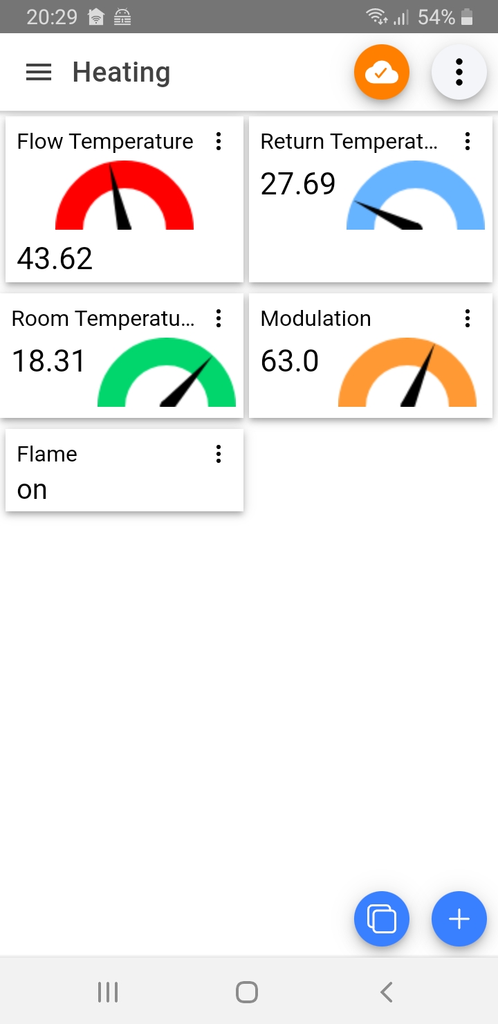

PiMike Posted March 20, 2023 Author Posted March 20, 2023 On a positive note and thanks to Radian's help earlier I can now monitor my boiler from my phone with a free MQTT app. Mike

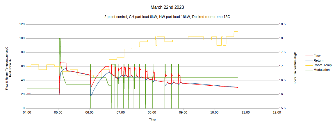

PiMike Posted March 22, 2023 Author Posted March 22, 2023 OK I think I'm going to drop the boiler tweaking for now as it's raising more questions than I can answer at the moment. Here are two plots from consecutive mornings, one with the thermostat in conventional (2-point) mode and the other in analogue mode (and return regulation). I can't see too much difference between them. The modulation is 100% (18kW) for HW. For CH the 2-point control looks to be better behaved. Thanks for all the input! Mike

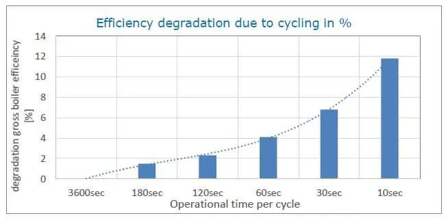

Lofty718 Posted March 23, 2023 Posted March 23, 2023 (edited) See this chart that shows efficiency drops from boiler cycling, you do not lose much efficiency unless your boiler is cycling a lot in a short space of time. vaillants have anticycling mode to boost efficiency https://www.heatgeek.com/what-is-boiler-modulation/ chart came from heatgeek, read all the articles on here there is some great info Make sure your pump is set at the right speed and you have the optimal delta t across the system, then add weather comp if you want an extra 5-10% effciency and more comfort. Edited March 23, 2023 by JoeyF

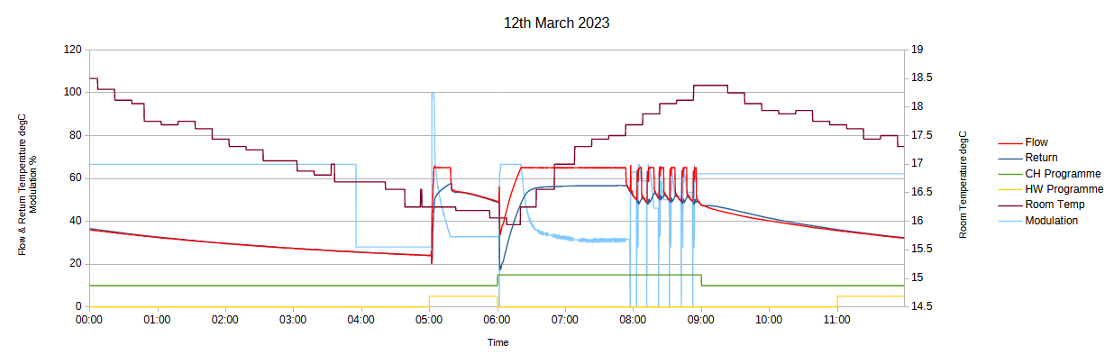

PiMike Posted March 24, 2023 Author Posted March 24, 2023 On 23/03/2023 at 17:13, JoeyF said: See this chart that shows efficiency drops from boiler cycling, you do not lose much efficiency unless your boiler is cycling a lot in a short space of time. vaillants have anticycling mode to boost efficiency https://www.heatgeek.com/what-is-boiler-modulation/ chart came from heatgeek, read all the articles on here there is some great info I read the article, it's very informative. Then I went back to a plot I made earlier this month when the weather was colder and realised it follows their logic. This is with the room thermostat in conventional (on/off) mode. The boiler starts up at 100% modulation (18kW) for hot water then 66% for the start of the CH long burn. Once the flow temperature reaches the target of 65C the modulation drops to 30% but because my boiler can't go below 5kW it starts the short cycles as the room temperature approaches the target of 18C. Mike 1

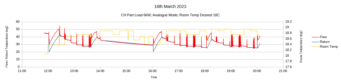

PiMike Posted March 26, 2023 Author Posted March 26, 2023 On 25/03/2023 at 00:15, JoeyF said: Read the whole consumer advice section on Heat Geek it is very informative https://www.heatgeek.com/weather-compensation-or-load-compensation/ Also if you use facebook I am part of an interesting group on there where we all discuss stuff like this, but main focus is low temperature heating. Group name 'Heating system design' In the UK we have an issue of installers oversizing boilers, mine put in a 30kw when I could of had 15kw and even that would be too much, the consequence of that is that my boiler cannot modulate below 6kw. I don't use social media, life is so busy I can't find the time. I'm more than happy with the fantastic help available on forums like this. When my boiler was installed in 2009 I didn't know enough to ask what rating it was. I assumed the installer knew what he was doing ... This puzzles me. I set the CH part load to 8kW, assuming that this is the maximum the boiler would use, but in the graph above it's running at nearer 12kW (66%) at the start of the CH programme. Mike
Lofty718 Posted March 27, 2023 Posted March 27, 2023 The boiler will fire up on full power for the first minute, that's just how they are designed. Vaillants anyway, I'm not sure about others
PiMike Posted March 27, 2023 Author Posted March 27, 2023 6 hours ago, JoeyF said: The boiler will fire up on full power for the first minute, that's just how they are designed. Vaillants anyway, I'm not sure about others Fair enough, but full power would be 100% not 66% ... Mike
