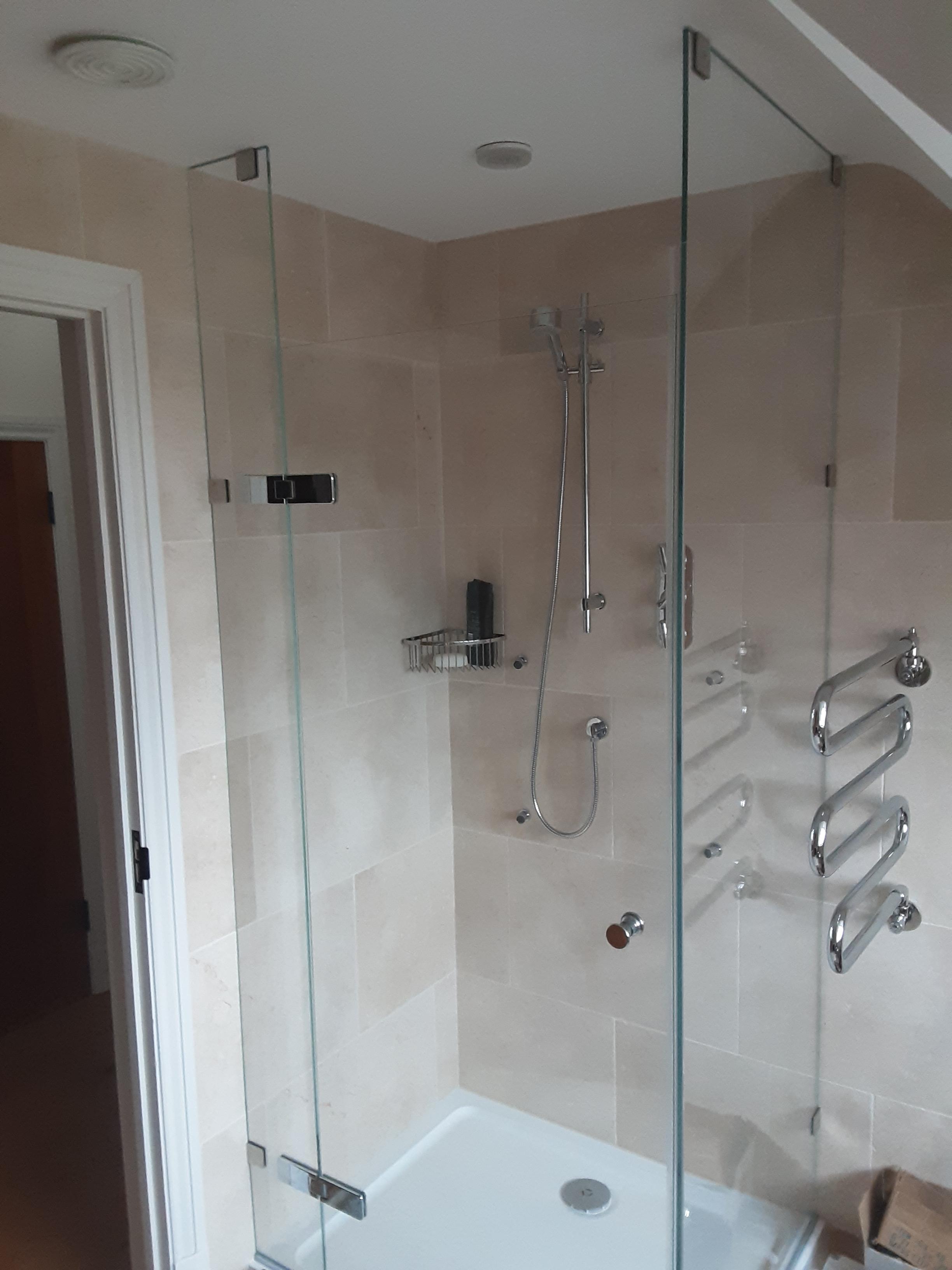

Temp Posted March 8, 2023 Share Posted March 8, 2023 I doubt you can buy one ready made but you could certainly get one made for you. We got our frameless showers made by GoGlass in Cherry Hinton near Cambridge but many local glass merchants can make them. Their web site is very posh but they operate from a relatively modest workshop last time I was there. https://goglass.co.uk/ In your second picture it shows a door hinged off a small side panel. I would avoid doing that if possible. We have that on one shower and the glass to glass hinges aren't so easily adjusted. I think the arrangement in the first photo is better and will give a better door seal. However would the shower door bang on the bathroom door handle when open? Link to comment Share on other sites More sharing options...

Temp Posted March 8, 2023 Share Posted March 8, 2023 Goglass actually made this one for us in 2007ish but I've only last month installed it! Tools and boxes still on the floor. Link to comment Share on other sites More sharing options...
