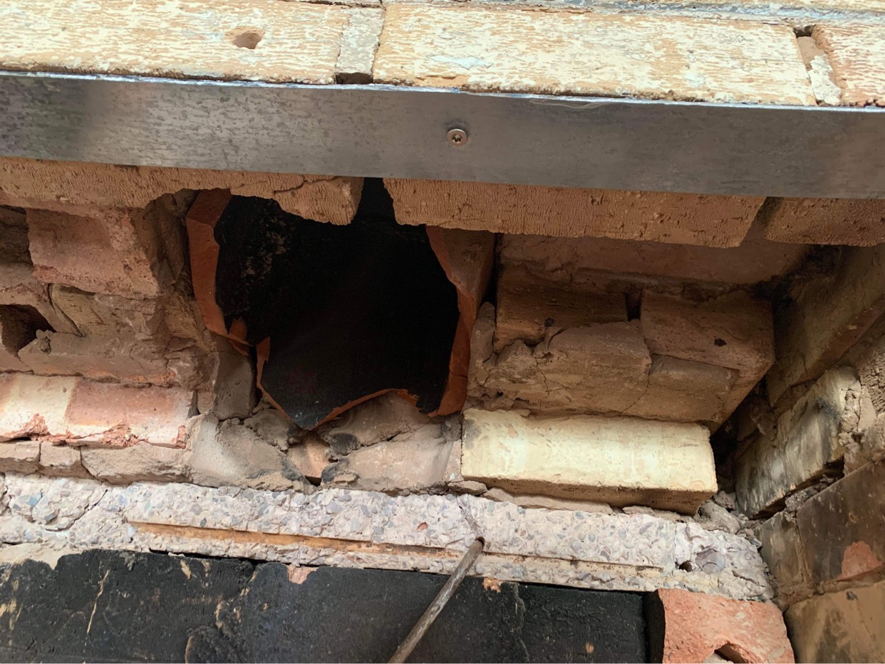

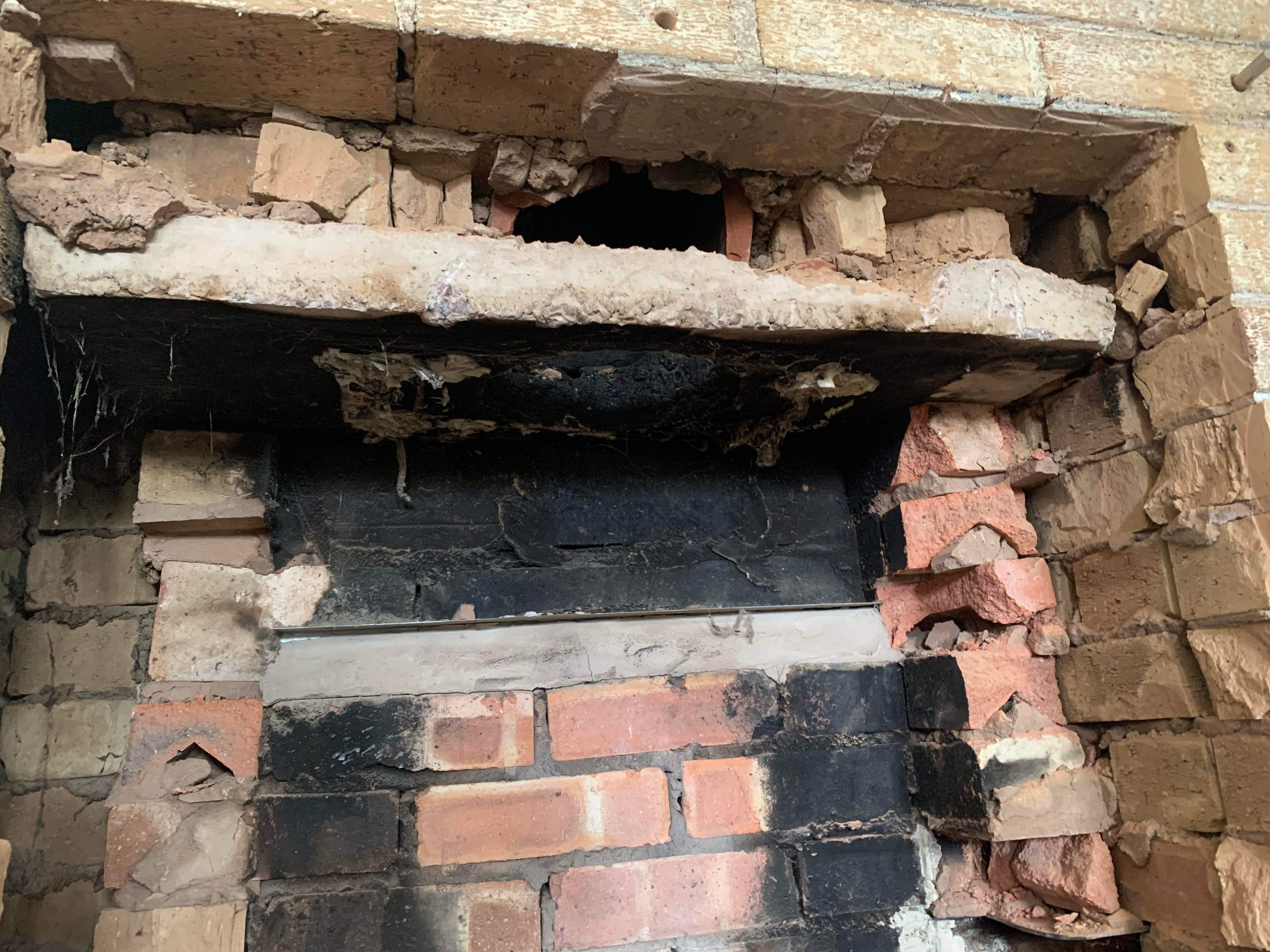

Glenda Posted March 6, 2023 Share Posted March 6, 2023 Hi, I’ve had my fireplace opened up to have a new log burner installed but the supporting lintel from back to front has been smashed out and only what looks like the equivalent of a baked bean tin put in beneath the front row of chimney breast bricks which is definitely ‘Dipping’ is this structurally ok/safe? Link to comment Share on other sites More sharing options...
Temp Posted March 6, 2023 Share Posted March 6, 2023 I would suggest it needs a concrete lintel and because the clay liners have been broken it will probably need the chimney lining (although that's probably a good idea anyway). 1 Link to comment Share on other sites More sharing options...
Glenda Posted March 6, 2023 Author Share Posted March 6, 2023 Hi, thanks for reply, yeah I was intending on a liner but it’s the knocking out of the lintel and nothing put in it’s place that’s concerning me. Link to comment Share on other sites More sharing options...
markc Posted March 6, 2023 Share Posted March 6, 2023 3 minutes ago, Glenda said: Hi, thanks for reply, yeah I was intending on a liner but it’s the knocking out of the lintel and nothing put in it’s place that’s concerning me. Looks like a piece of flat strip steel so it will not support the wall above it. Definitely needs a lintel. Had it been an angle section steel with the leg upwards behind the bricks then it would have been ok. 2 Link to comment Share on other sites More sharing options...
