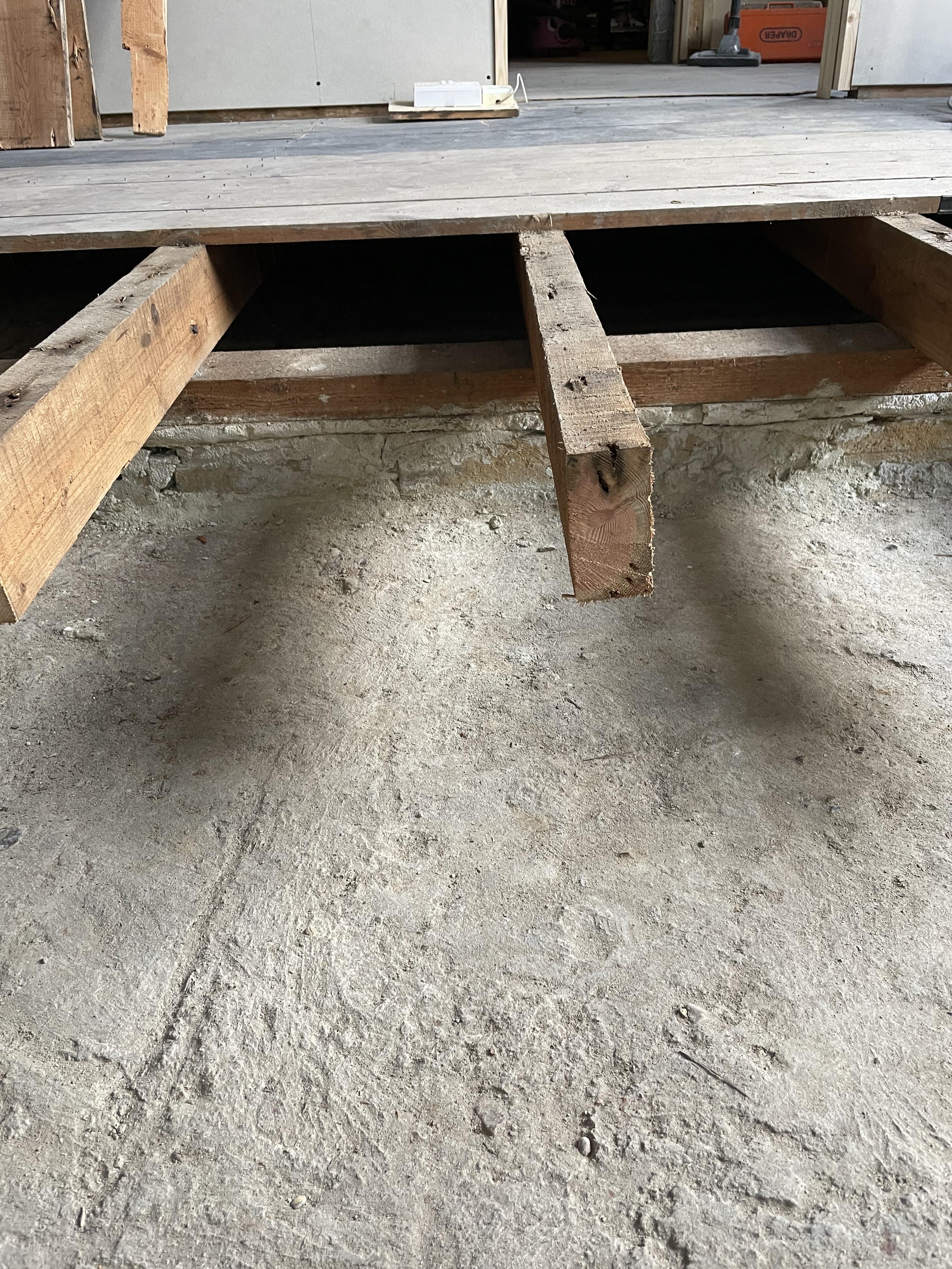

Montana Posted February 25, 2023 Share Posted February 25, 2023 Looking for ideas for insulating my suspended wooden floor. I’ve not got any room under the floorboards to insulate and I’m a bit stuck for a solution. I’ll probably over board the existing floorboards with 18mm P5 t&g boards, so guessing that will seal up the drafts better but won’t add much thermal benefit? The floor joists are 100mm deep. I’ll attach a photo. Thanks Richard Link to comment Share on other sites More sharing options...

Montana Posted February 25, 2023 Author Share Posted February 25, 2023 No not worried about taking the floor boards up, just we only have the 100mm void between the joists for the air flow, so I can’t really put anything between the joists unfortunately, as it will stop or reduce the ventilation. Link to comment Share on other sites More sharing options...
Nickfromwales Posted February 25, 2023 Share Posted February 25, 2023 2 minutes ago, Montana said: No not worried about taking the floor boards up, just we only have the 100mm void between the joists for the air flow, so I can’t really put anything between the joists unfortunately, as it will stop or reduce the ventilation. The gaps UNDER the joists forms your ventilated space, and not the gaps in between them 1 Link to comment Share on other sites More sharing options...
Montana Posted February 25, 2023 Author Share Posted February 25, 2023 2 minutes ago, Nickfromwales said: Are your internal walls sat on top of the floorboards? This was done with great wisdom by our forefarters 2 stories of brick wall with the upstairs joists spanning it from 2 rooms, all on top of the floorboards and the ( now diminishing ) 4” timbers on dwarf walls ( with failed “damp proof” slates lol ). What the hell were they thinking ?! It’s only a bungalow, cable end front and back, all internal walls are stud work. The 4 inch timbers on top of the dwarf walls are in good condition, as are the bricks and mortar, they also have an old dpm which looks fine. It had some woodworm on the end of some joists, which I’ve cut out and just about to replace. 1 Link to comment Share on other sites More sharing options...
Montana Posted February 25, 2023 Author Share Posted February 25, 2023 (edited) 18 minutes ago, Nickfromwales said: The gaps UNDER the joists forms your ventilated space, and not the gaps in between them Can you show me the gaps under the joists please? It’s one course of continuous bricks, with a timber plate on top, joists sit on that. So the gap between the joists allows for ventilation? Thanks Richard. Edited February 25, 2023 by Montana Link to comment Share on other sites More sharing options...
Nickfromwales Posted February 25, 2023 Share Posted February 25, 2023 6 minutes ago, Montana said: Can you show me the gaps under the joists please? It’s one course of continuous bricks, with a timber plate on top, joists sit on that. So the cap between the joists allows for ventilation? Thanks Richard. I can’t show you mine, I took one look, swore several times, and put the boards back down. Mine will get completely dug out, insulated, concreted with mesh and UFH pipes, and the internal walls rebuilt. I’ve worked in the construction industry for 3 decades so am speaking about your job from experience. If each of your gaps between joists were the ventilated spaces, you’d need an air brick for each void, so the house would collapse. Your air bricks will feed down into the void / underbelly and in-filling between the joists will be perfectly fine, as long as the insulation doesn’t completely foul the air bricks and their path to the remainder of the ventilated void. Link to comment Share on other sites More sharing options...

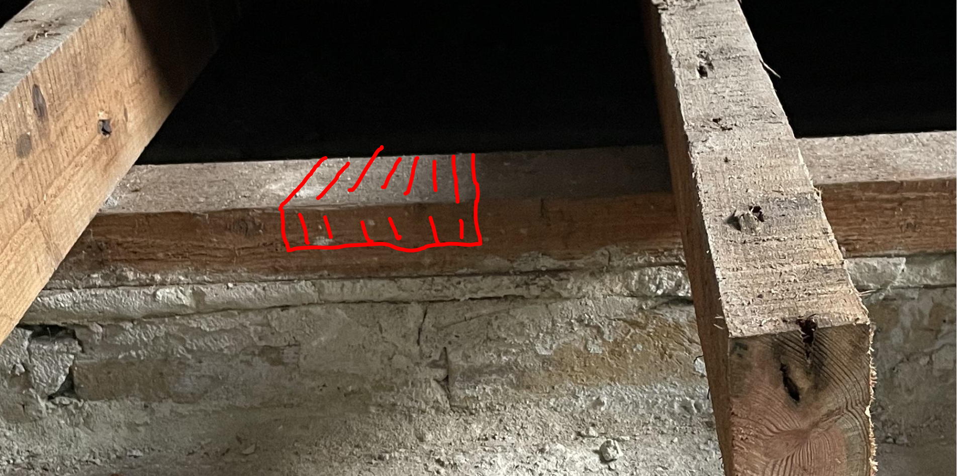

Iceverge Posted February 25, 2023 Share Posted February 25, 2023 Assuming you have enough space for the P5(18mm) and floorboards (25mm) I would propose something like this. Notch out the wall plate as shown for ventilation. (Disclaimer------ I don't "think" the house will fall down!!) or drill a couple of 25mm holes. Follow ecological building systems approach with the two membranes keeping the drafts at bay. Both from an windtightness approach( thermal bypass) and airtightness. Return the membrane to the internal walls. Lay 25mm battens on top of the existing joists in lieu of the thickness of the floor boards ( you could even rip down some floor boards to do this). This will give you a insulative value of about 0.3W/m2K using a high performing mineral wool batt like If you want to substitute the mineral wool for the more painful and less robust process of PIR then the U value could drop to 0.25W/m2K. 1 1 Link to comment Share on other sites More sharing options...

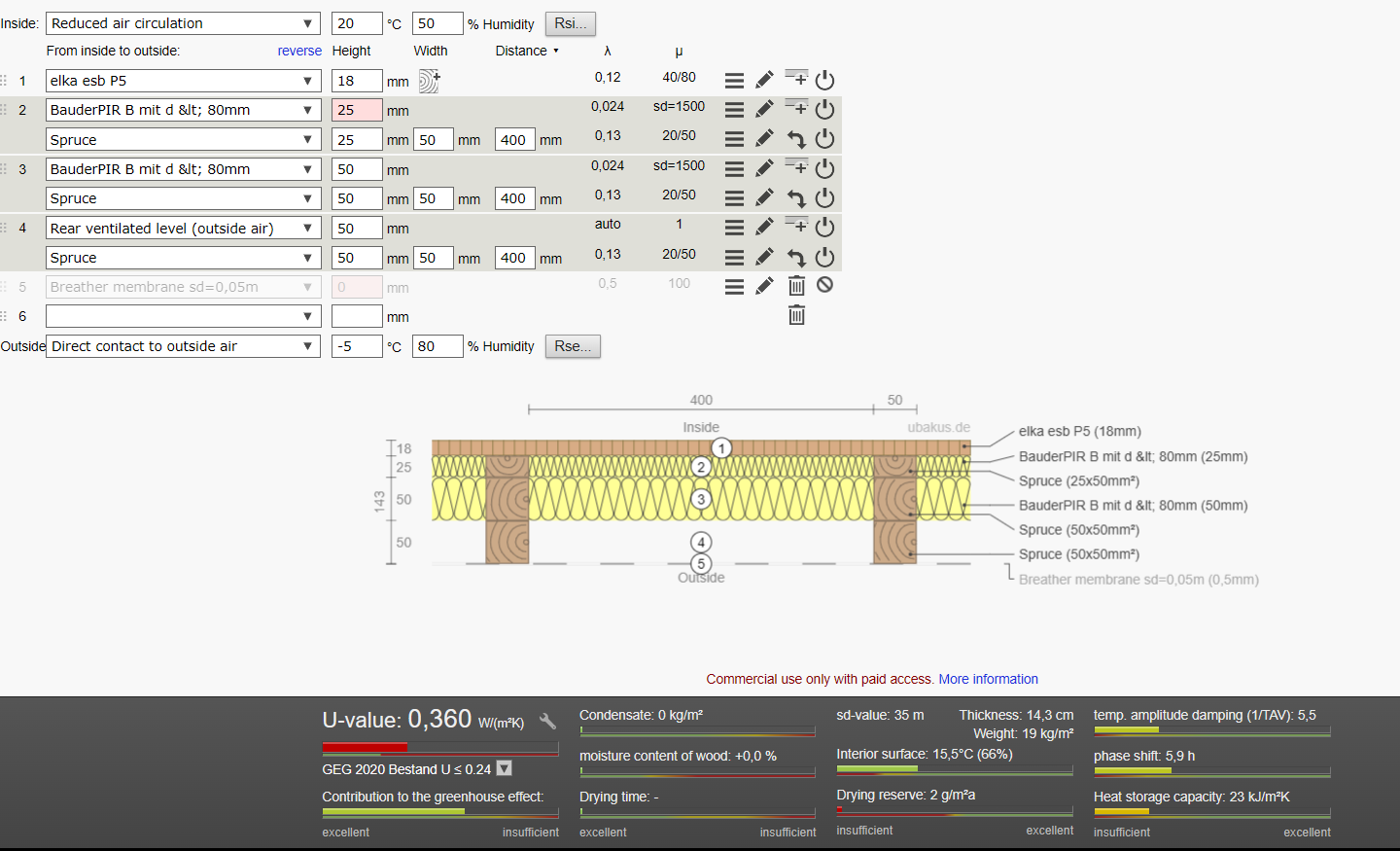

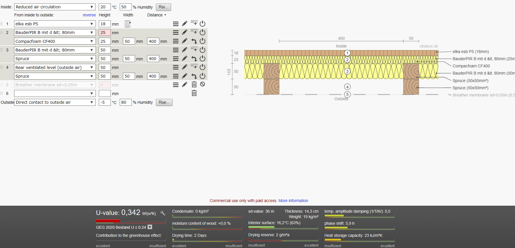

Iceverge Posted February 25, 2023 Share Posted February 25, 2023 (edited) Good thinking @Nickfromwales but the compacfoam doesn't make much difference unfortunately vs timber at such insulative values. WITHOUT COMPACFOAM WITH COMPACFOAM Edited February 25, 2023 by Iceverge Link to comment Share on other sites More sharing options...
