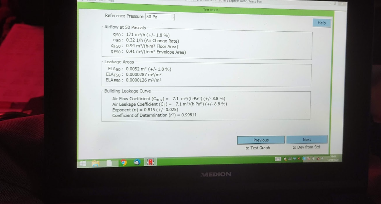

Official test
4IpUQC97gCp5bIzzz_q2rPW-ChiJKVeOoqPEuXSsA5xVlqViSfklJ6RX2tEGHZXyqtayDD3jcTgd8iXDrhyakm21ybVKoxUh-Ra8BVYT-0pAoP1IH_DJBIkUdmJ114XTjYcPTpn3nzRToOSB2MeTlVP5Np5t4Gk461qJS-xO5cBZ6Pa1GcluylE3KVF0vLOl_z_O6BeiBxUCtpq5-9iGSrC7_uZHYZLRSU1zXm8WbU41taDkb9K1Y-HCtlHlN_CTheNJAWTRunwnRESCe-3iNP2G0pkVLLjGrg4MzlHDMt1IUa9Fvl_5-QgApt_3l7ItdTNnw9B-Jr1tlvpZlfEo0h23K7bezAQiLlvBH9bY6TQXulB8YM8OSt_hYDq2Lk9W7V0RXD_iPvvPXYsER6HEeqm7pxLwYNX8EpfsTX-eq-3oO4WeeENM7gn5RpTXzDDTYsCUchipDV-l7Bxgn2C-Bz3KnBfmfcUJ21P4NtJCmNOW9C8S17mcD5Wes4QfdZb5esPuQAJ0-lQKJ6D8Jud-cVs9uyN9D-Nq328BzH_u7LET7AZcJgLu41G63HWFXSuzpN2JwlvEU8fHKNJ5znbjUO8ty1yOAcQ-Oe3wh0f7-79Ijf4MU2alUaPLqsqESE3G_kJMf9k6ve6EjiMWvomGAHr683ikUCR9Liv0ioumZVMJjRjHZ2PRMNgI9DFGnGtg5RYZA3hOw7dIMqJ-XOH1oFOgalvV1MTZwcGbp6qrHdND_l1kkb-d6wslp9rt1RYHoZg-mn04MZ_PAChXo7qtPLKW4C_FpegJdgHoxLAkl4DeCdMnaMIzIcfXwrCVBF44DWxYJVNMCBUHh4i1MjxOfRU3K8ihpLKZ87EzexD-PBJI5uHDlKrmyaRQ9oZAstHApoc_wKdK0c5Z-2jj0JS9zyDfxrawBFAaoVy667TZ=w1724-h970-no?authuser=0
 Final Result

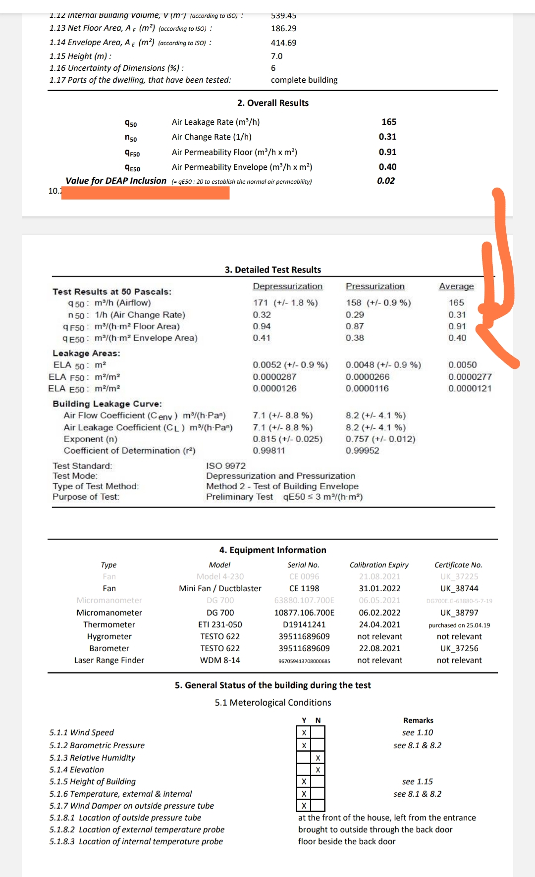

Posted
19 minutes ago, Thorfun said:
0.32ACH.....very impressive.
Ah, such a shame. I was looking for advice around getting a result of 0.31. I'll try a different thread. No bother.

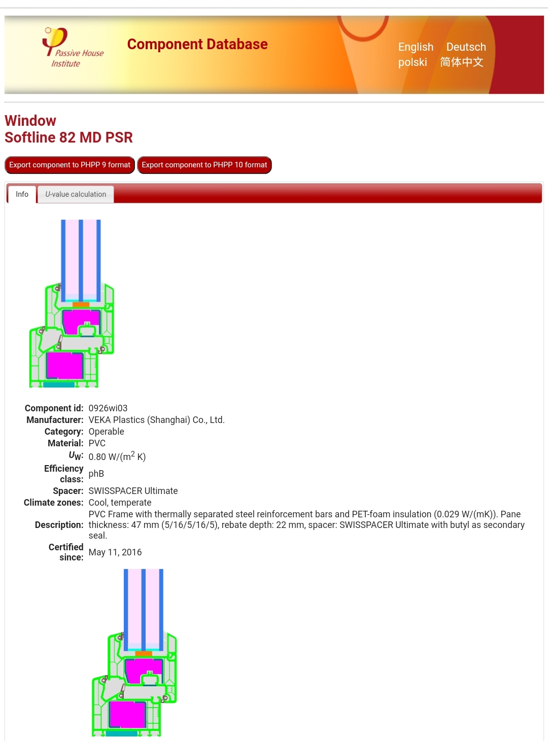

Posted
25 minutes ago, Nickfromwales said:
Did you tape up the Veka doors and windows? Are they 3g and rated 'airtight' or just good but regular uPVC stuff?
Triple sealed, passivhaus rated. They work well if adjusted properly.
Screenshot_2023-02-23-14-10-47-768-edit_com.android.chrome.thumb.jpg.36206c439045cb2d1caef27be998651d.jpg
@Iceverge
 I got ya bro.....
That must have been the depression test only, not the average.
Screenshot_2023-02-23-14-16-18-416-edit_com.google.android_apps_docs.thumb.jpg.c30041e8855eb50b86b0467b75362c54.jpg
