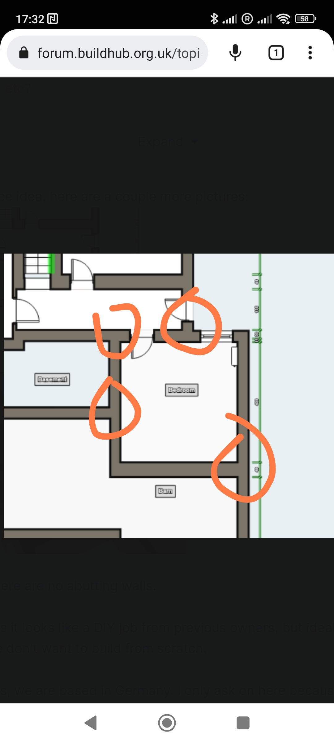

Posted
2 hours ago, vagrantly3893 said:
There are no abutting walls
Maybe my terminology is wrong.
I meant the ones outlined here.
Screenshot_2023-02-21-17-32-16-343-edit_com.android.chrome.thumb.jpg.0d3b9ef66cedf479a418705b66583218.jpg
It rules out the idea of making a good job of external insulation as there'll be too many thermal bridges.
Yes it looks like a DIY job from previous owners, but ideally we don't want to build from scratch
With internal insulation you'll end up with a much smaller room or with external insulation you'll end up with a minimal improvement due to the aforementioned thermal bridges. A knock and rebuild, even of 3 walls and the roof might be worth considering.  A small timber frame wouldn't break the bank.
Otherwise some PIR inboard and foam tape all joints and 22mm battens for a  service cavity.  And then plasterboard.
Some PIR on the floor and float 2 layers of OSB crossed glued and screwed over it.
Get some dedicated ventilation in there too. Otherwise it'll be musty. Germany has more or less everything for sale s far as I can remember.
