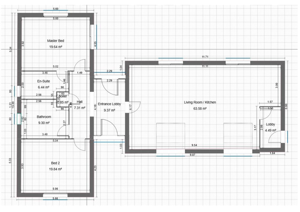

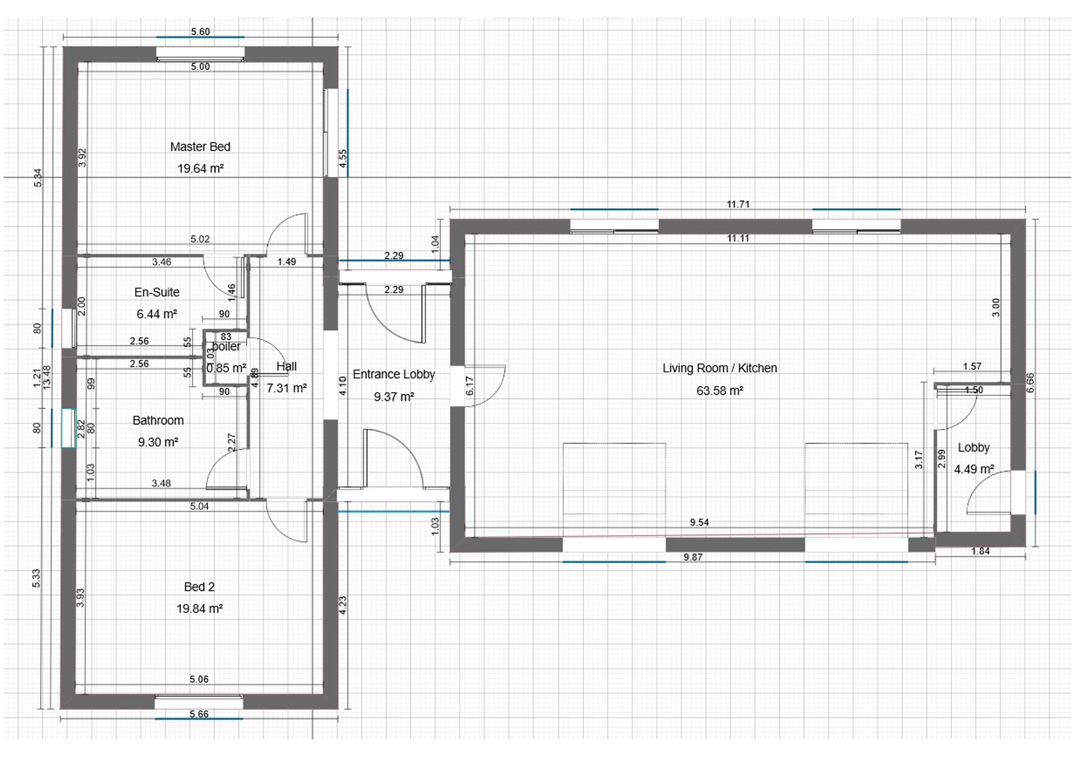

Pigsfoot Posted February 15, 2023 Posted February 15, 2023 Apologies for the weird title. We are building a new workshop which eventually will be converted to a bungalow. The building layout is two large rectangles laid out as a large letter T with a connection between the two sections which is the entrance lobby. This lobby section will have wall to wall glass which will be glass panels with a door in the middle. The plan attached may help. What i'm concerned about is the block work from the outside wall carries on to become the inside wall where the side door way is as there are no returns needed due to teh loby being full wall to wall glass. Is that OK, do i need to split the wall somehow and add in some DPC ? Any pointers would be very much appreciated. Thanks
Mr Punter Posted February 15, 2023 Posted February 15, 2023 Yes, split the outer leaves where they hit the glass.
Canski Posted February 15, 2023 Posted February 15, 2023 As above provide a cavity with a cavity closer inside of the door to prevent thermal bridging.
Jenki Posted February 15, 2023 Posted February 15, 2023 You need to build in ( i.e. take down a small section of wall and add cavity trays). These will take any water from the cavity back to the outside.
