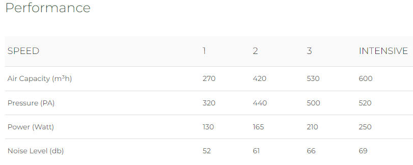

Hood Fan efficiency:
The numbers in the table below are the maxima, not an actual operating point. But if it was an operating point, the efficiency of the fan itself would be:
nu_fan = P_flow / P_electricity
nu_fan = (Flow(m/s) * Pressure(Pa)) / P_electricity(W) = ((600/3600) * 520) / 250 = 35%
That's not too bad but isn't an actual operating point so the efficiency is probably 20-25% in INTENSIVE mode. In mode 1, unadjusted nu_fan = 18%, mode 2, unadjusted nu_fan = 31%, and mode 3, unadjusted nu_fan = 35%.
You're probably looking at an efficiency of around 20% best case. Remember, fans are really inefficient. but in extraction it doesn't really matter so much.
