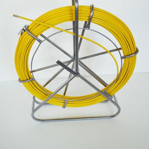

BMcN Posted February 2, 2023 Author Share Posted February 2, 2023 Unfortunately not ducted in an accessible way for the garage, an oversight. What options are there for wireless CT @Jenki? Link to comment Share on other sites More sharing options...
Jenki Posted February 2, 2023 Share Posted February 2, 2023 Just now, BMcN said: What options are there for wireless CT @Jenki? I'm not there yet. but , in this post that is the idea. I'm currently looking into this as I will have two locations that use power, and the meter is in a third place. separated by 70M. Link to comment Share on other sites More sharing options...
BMcN Posted February 2, 2023 Author Share Posted February 2, 2023 6 hours ago, Jenki said: I'm not there yet. but , in this post that is the idea. I'm currently looking into this as I will have two locations that use power, and the meter is in a third place. separated by 70M. I am going to have a look and see if I could get a cable fish through the electrical duct. It's tight and long so I doubt it will work but I'll try and take it from there. Link to comment Share on other sites More sharing options...
Dillsue Posted February 2, 2023 Share Posted February 2, 2023 1 hour ago, BMcN said: I am going to have a look and see if I could get a cable fish through the electrical duct. It's tight and long so I doubt it will work but I'll try and take it from there. Use one of the cables in the duct to pull a draw wire in then use thd draw wire to pull the cable back together with the new data cable?? 1 Link to comment Share on other sites More sharing options...
BMcN Posted February 3, 2023 Author Share Posted February 3, 2023 9 hours ago, Dillsue said: Use one of the cables in the duct to pull a draw wire in then use thd draw wire to pull the cable back together with the new data cable?? The duct is one of the Scottish power 32mm (ish ones) and the cable is the same as the main incomer (20-25mm2 I think, with armour). So itll be a tough pull and a risky one if something goes wrong. Link to comment Share on other sites More sharing options...
S2D2 Posted February 3, 2023 Share Posted February 3, 2023 Isn't the usual trick taping a plastic bag to the drawstring and attaching a vacuum at the other end? Link to comment Share on other sites More sharing options...
Dillsue Posted February 3, 2023 Share Posted February 3, 2023 5 hours ago, BMcN said: The duct is one of the Scottish power 32mm (ish ones) and the cable is the same as the main incomer (20-25mm2 I think, with armour). So itll be a tough pull and a risky one if something goes wrong. Ok. If the cable is SPs then its a no no but if its yours then it might be your only option. If its a straight duct the SWA should pull back in ok, if youve got enough room not to bend it as its drawn out. Getting cable rods over 70 metres is alot of rods! I think you can blow/vac lightweight cables through ducts but not sure how successful that would be with a chunky cable in the duct already Link to comment Share on other sites More sharing options...
BMcN Posted February 3, 2023 Author Share Posted February 3, 2023 3 hours ago, Dillsue said: Ok. If the cable is SPs then its a no no but if its yours then it might be your only option. If its a straight duct the SWA should pull back in ok, if youve got enough room not to bend it as its drawn out. Getting cable rods over 70 metres is alot of rods! I think you can blow/vac lightweight cables through ducts but not sure how successful that would be with a chunky cable in the duct already Yeah it is SWA and SP ducting but its all mine. I think I will try a fibreglass tape, it would be too many rods. Link to comment Share on other sites More sharing options...
