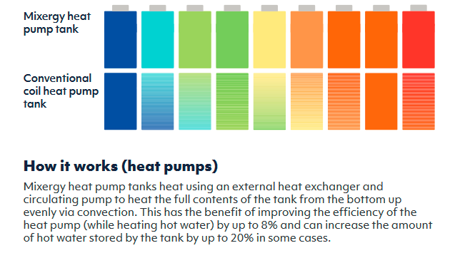

JamesPa Posted May 5, 2023 Posted May 5, 2023 5 hours ago, DanDee said: Have a look at this, send an enquiring email to them. Instead of trying to heat the whole tank, it's starting from the top down as it's built different than the rest. https://mixergy.co.uk/news-and-insights/introducing-mixergys-new-award-winning-heat-pump-cylinder-the-ihp/ from the comments on youtube When will a spec sheet be out. Particularly interested in running noise levels, capacities and recharge times versus your “traditional” cylinders Mixergy Ltd Please send us an email, and we can provide this information [email protected] To speak to the Mixergy team, please call 01865 884 343. We are available Monday to Friday from 9am to 5.30pm. Note however that, so far as I can tell from the literature, the advantage @DanDeerefers to (heating only the top) is lost should you subsequently fit an ashp. They sell an ashp conversion kit comprising PHE and pump which must surely destratify the tank. Unless I (and @sharpener) misunderstood what they are saying
DanDee Posted May 5, 2023 Posted May 5, 2023 12 minutes ago, JamesPa said: Note however that, so far as I can tell from the literature, the advantage @DanDeerefers to (heating only the top) is lost should you subsequently fit an ashp. They sell an ashp conversion kit comprising PHE and pump which must surely destratify the tank. Unless I (and @sharpener) misunderstood what they are saying This product it's a heat pump cylinder in itself, but instead of having the condenser coil inbuilt around the exterior of the tank, they try something different by having the HP module separated on top, by piping the water through a condenser heat exchanger pulling from the bottom so that the heated water it's fed through the top. The tank it's specifically designed to a degree to avoid mix. What literature have you seen?
sharpener Posted May 5, 2023 Posted May 5, 2023 (edited) It's clear from the pictures in their own literature that there is very little stratification in the heat pump version of the standard Mixergy tank: Edited May 5, 2023 by sharpener
DanDee Posted May 5, 2023 Posted May 5, 2023 8 minutes ago, sharpener said: It's clear from the pictures in their own literature that there is very little stratification in the heat pump version of the standard Mixergy tank: Well that has nothing to do with the new product, so will it mix or not or how much remains to be seen when they hit the market and people talk about it. It has a diffuser, the HP output it's only 1.5kW so low flow rate in general.
sharpener Posted May 5, 2023 Posted May 5, 2023 (edited) Yes confusing isn't it. The bottom picture in yr earlier post is from this Mixergy news article and shows the "conventional approach" with the refrigerant coil wrapped around the cylinder which Mixergy are at pains to say they do not use. The key to achieving stratification is to have the flow circulating at only the rate at which the water can be heated. Notice how small the circulating pump is in the picture. If they can be obtained readily it would be the ideal pump for adding to a conventional cylinder - with or without a heat exchanger - as discussed by @JamesPa and me in the other thread. <The Stratos instantaneously heats hot water which is drawn from the bottom of the cylinder and returns it back to the top to achieve very quick reheat times. Alternatively, a flow path back to the bottom of the cylinder allows the system to achieve the highest possible COP on a full reheat cycle.> from this Mixergy seem to think that for the best CoP the optimal strategy is to return the hot water to the bottom of the tank. I had been debating which was the best approach but don't understand why this is better than having the coldest water descending slowly to the take-off point as in their Boost mode (which achieves a CoP of between 2 and 3), maybe someone can elucidate? Edited May 5, 2023 by sharpener
DanDee Posted May 5, 2023 Posted May 5, 2023 9 minutes ago, sharpener said: from this Mixergy seem to think that for the best CoP the optimal strategy is to return the hot water to the bottom of the tank. I had been debating which was the best approach but don't understand why this is better than having the coldest water descending slowly to the take-off point as in their Boost mode (which achieves a CoP of between 2 and 3), maybe someone can elucidate? You mix the water so you can have the lowest dt and higher COP when slow heating, isn't this known as a general thing with HP's? Only CO2 HP's do well with high dt.

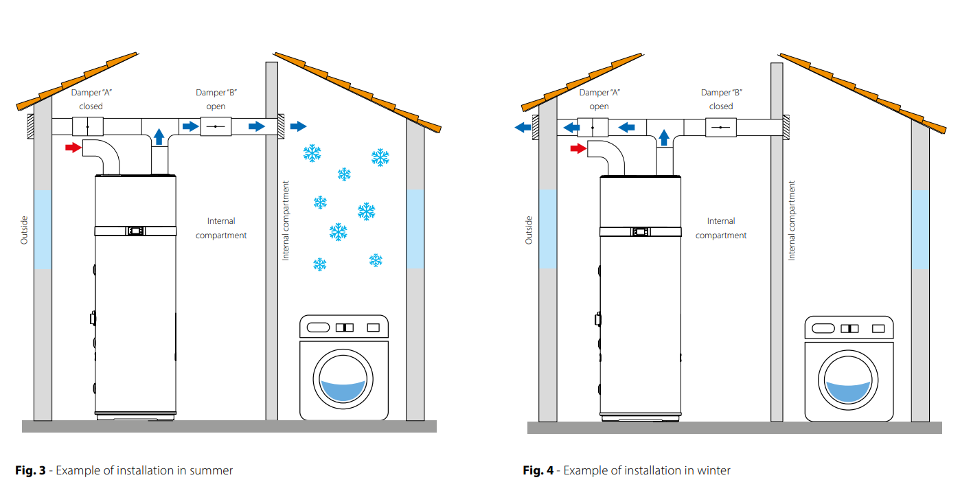

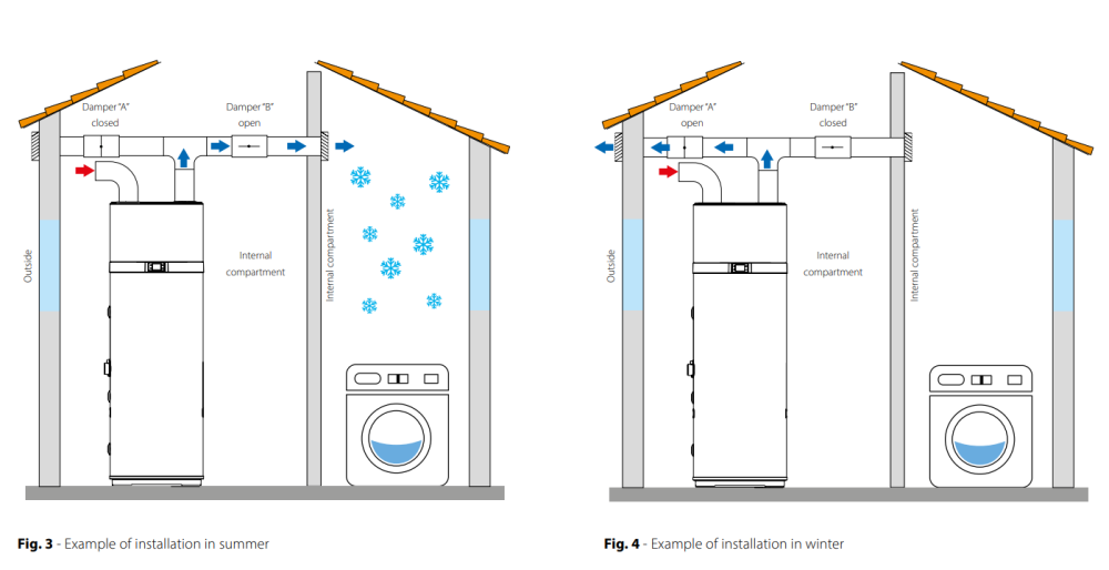

Iceverge Posted May 5, 2023 Posted May 5, 2023 @JtG Have you measured your DHW use? Heating a large UVC with a cheap time of use tariff has the cheapest lifetime cost for low volume users with my sums. Heat pump DHW is only really cheaper over a lifetime for higher volume users. On another point, an ESHP (all in one) DHW heater can be set to extract heat from the house or the outside. I've not been able to find any accurate data on the COP of said tanks Vs inlet air temperature so I'm undecided which I better. However at full chat they will tend to over ventilate a house. A simple operable butterfly valve or two in a duct could make this switchable season to season and fine tune it for best ventilation/COP.
DanDee Posted May 5, 2023 Posted May 5, 2023 6 minutes ago, Iceverge said: A simple operable butterfly valve or two in a duct could make this switchable season to season and fine tune it for best ventilation/COP. That's what daikin thinks more or less.

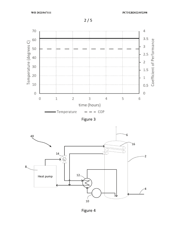

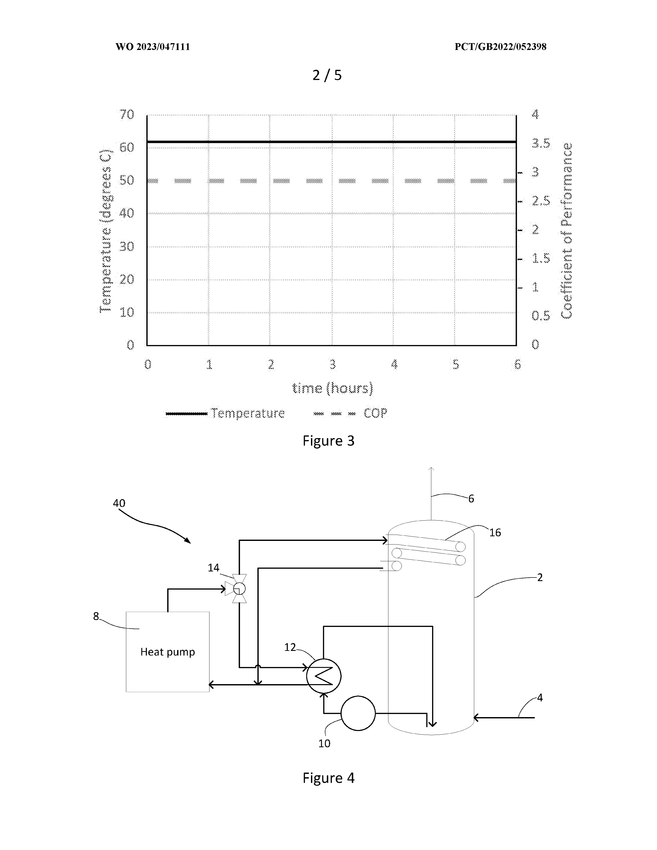

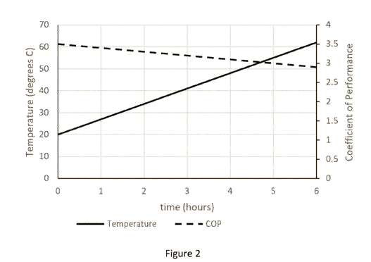

sharpener Posted May 5, 2023 Posted May 5, 2023 45 minutes ago, DanDee said: You mix the water so you can have the lowest dt and higher COP when slow heating, isn't this known as a general thing with HP's? Only CO2 HP's do well with high dt. Assuming the HP can deliver water at 50C irrespective of the inlet temp (which it seems to be capable of in Boost mode, where the water makes a single pass through the HP) then according to Wikipedia it is inversely proportional to delta T between the cold source (the air) which is constant, and the HP outlet water which as above is also constant. What we are missing is an expression which takes into account the water temp at the inlet to the HP which will either (in Boost mode) be constantly cold or (in max efficiency mode) rise slowly as the water is recirculated and the tank as a whole heats up. Clearly the heat input to the water is deltaT x flow. Does this HP (and indeed ASHPs for space heating) A. control the flow so as the body of the tank heats up and deltaT becomes less the flow rate increases to maintain constant power, or B. maintain a constant flow in which case the deltaT will remain constant so the outlet temp will not be 50C but will be less to begin with and rise as the tank heats up. Can someone point me to the appropriate theory for this? My undergraduate thermodynamics is very rusty now.
DanDee Posted May 5, 2023 Posted May 5, 2023 14 minutes ago, sharpener said: A. control the flow so as the body of the tank heats up and deltaT becomes less the flow rate increases to maintain constant power, or Variable water pump https://patents.google.com/patent/WO2023047111A1/en?assignee=Mixergy+Ltd&sort=new
JamesPa Posted May 5, 2023 Posted May 5, 2023 2 hours ago, DanDee said: 3 hours ago, JamesPa said: Note however that, so far as I can tell from the literature, the advantage @DanDeerefers to (heating only the top) is lost should you subsequently fit an ashp. They sell an ashp conversion kit comprising PHE and pump which must surely destratify the tank. Unless I (and @sharpener) misunderstood what they are saying This product it's a heat pump cylinder in itself, but instead of having the condenser coil inbuilt around the exterior of the tank, they try something different by having the HP module separated on top, by piping the water through a condenser heat exchanger pulling from the bottom so that the heated water it's fed through the top. The tank it's specifically designed to a degree to avoid mix. What literature have you seen? Apologies, my comment was based on the standard Mixergy cylinder with the heat pump conversion kit. I hadn't twigged that they had brought out a cylinder with an integrated HP. 1
sharpener Posted May 5, 2023 Posted May 5, 2023 (edited) 2 hours ago, DanDee said: Variable water pump https://patents.google.com/patent/WO2023047111A1/en?assignee=Mixergy+Ltd&sort=new Thanks for the link, very useful explanation. They obviously envisage using this two-regime technique in an improved add-on kit for existing tanks too, which may interest @JamesPa. As the full text although worth reading is very repetitious I am including the key bit below (my emphasis, it explains why circulating the water in an existing tank with an externally-fitted pump is a good idea). Pictures taken from espacenet: Figure 2 shows a graph illustrating a first example for optimising the COP of the heating. In this example the flow rate of (cold) water into the heat exchanger is selected to enable the most efficient heat transfer. Generally, the higher the flow rate the better the COP is; this can be explained by the higher flow rate producing a turbulent boundary layer further into the heat exchanger, with the turbulent boundary layer providing more efficient heat transfer than the laminar boundary layer. Other factors affect flow speed too; for example for a large plate exchanger a lower flow speed can produce the same heat transfer as a smaller plate exchanger with a higher flow speed. The flow speed may be reduced or increased in dependence on performance of the heat source (be it e.g. seasonal variability or heat pump capability), but for maximum COP the flow speed is generally maintained as high as safely and conveniently available. The COP associated with heating water at 20 °C is around 3.5 whilst the COP associated with heating water at 60 °C is lower, for example 2.9. In this example water in the tank is permitted to heated up gradually, and the COP gradually drops as the tank is heated. In this example, the average COP is 3.2 for complete heating of the tank. Figure 3 shows a second example where the water is not permitted to heat up gradually, but instead the flow rate of cold water into the heat exchanger is selected to bring the water to the desired use temperature of 62 °C in a single pass through the heat exchanger. Here the COP associated with heating water is 2.9 throughout, and if this is used for complete heating of a tank’s worth of water, then the COP remains 2.9 throughout. Edited May 5, 2023 by sharpener Add graphs
JamesPa Posted May 5, 2023 Posted May 5, 2023 1 hour ago, sharpener said: Thanks for the link, very useful explanation. They obviously envisage using this two-regime technique in an improved add-on kit for existing tanks too, which may interest @JamesPa. As the full text although worth reading is very repetitious I am including the key bit below (my emphasis, it explains why circulating the water in an existing tank with an externally-fitted pump is a good idea). Pictures taken from espacenet: Figure 2 shows a graph illustrating a first example for optimising the COP of the heating. In this example the flow rate of (cold) water into the heat exchanger is selected to enable the most efficient heat transfer. Generally, the higher the flow rate the better the COP is; this can be explained by the higher flow rate producing a turbulent boundary layer further into the heat exchanger, with the turbulent boundary layer providing more efficient heat transfer than the laminar boundary layer. Other factors affect flow speed too; for example for a large plate exchanger a lower flow speed can produce the same heat transfer as a smaller plate exchanger with a higher flow speed. The flow speed may be reduced or increased in dependence on performance of the heat source (be it e.g. seasonal variability or heat pump capability), but for maximum COP the flow speed is generally maintained as high as safely and conveniently available. The COP associated with heating water at 20 °C is around 3.5 whilst the COP associated with heating water at 60 °C is lower, for example 2.9. In this example water in the tank is permitted to heated up gradually, and the COP gradually drops as the tank is heated. In this example, the average COP is 3.2 for complete heating of the tank. Figure 3 shows a second example where the water is not permitted to heat up gradually, but instead the flow rate of cold water into the heat exchanger is selected to bring the water to the desired use temperature of 62 °C in a single pass through the heat exchanger. Here the COP associated with heating water is 2.9 throughout, and if this is used for complete heating of a tank’s worth of water, then the COP remains 2.9 throughout. So is the inference that you get better cop if you circulate the water than if you don't, in which case adding the Mixergy 'heat pump conversion kit' or equivalent to an existing cylinder, rather than upgrading it to a hp specific one with a large coil, is actually, potentially, rather a good idea! 1 hour ago, sharpener said:
sharpener Posted May 5, 2023 Posted May 5, 2023 (edited) I think this must be a yes for 3 separate reasons, because (i) with the PHE you will achieve just as good heat transfer as a "heat pump" cylinder would give, but the stirring will (ii) improve it further with turbulence round the coil (if left in circuit) and (iii) improve the CoP by keeping the temperatures low for as long as possible assuming their thermodynamics are correct. The downside is de-stratifying the tank so not being able to draw off water that is properly hot during the heating up phase. In my case this is of no consequence as the times when it is best to heat the water are quite distinct from the times when I want to use it. I can imagine this would apply to many people. Still haven't been able to find the small pump that Mixergy use. But theirs is on the primary circuit, whereas if I fit one to stir my existing tank I will have to have a bronze one. Edited May 5, 2023 by sharpener
JamesPa Posted May 5, 2023 Posted May 5, 2023 25 minutes ago, sharpener said: Still haven't been able to find the small pump that Mixergy use. But theirs is on the primary circuit, whereas if I fit one to stir my existing tank I will have to have a bronze one. Confused by this statement. The digram in fig 4 above shows the pump (I assume the open circle is a pump) in the heated DHW circuit essentially taking it out from and returning it to the bottom of the tank and thus needing to be WRAS compliant/bronze. What am I missing?
