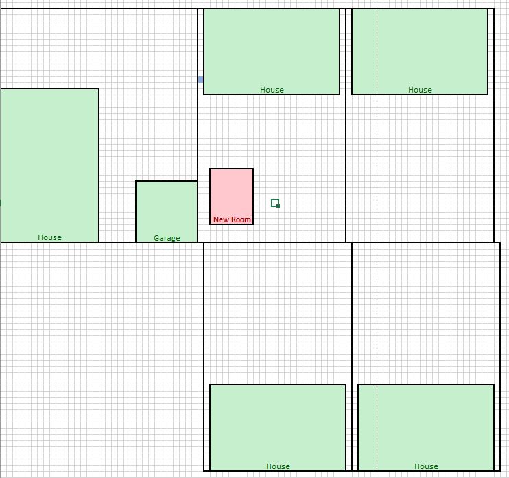

gambo Posted January 27, 2023 Author Posted January 27, 2023 I've read number of pages and they say "in most cases you do not need planning permission". I can make it up to 15m2, given it's a measure of internal space, and <2.5m height. Kitchen is not required but would it be easier to do it without and perhaps years later apply for permission if I kick out kids from house? I've attached a quickly created plan where the house would be (red box), also where the man hole is (blue dot). Boiler is very close to the man hole and the room is roughly 6-8m from house. Not sure electricity is an issue but I could use PV to power it + 1 battery as backup.
Temp Posted January 28, 2023 Posted January 28, 2023 Planning Permission and Building Control Approval are two different things. The 15sqm issue is normally a Building Regs issue rather than Planning Permission issue. I don't think there a limit on floor area for planning other than: A) it must not use more than half the area of the original garden. B) it must be what they call incidental to the original house. Eg not so big its virtually dominating the house or capable of being a dwelling in it's own right. I don't think either are likely to be a problem for you. I believe you can buildi bigger than 15sqm under permitted development. However there are limits on eaves and ridge heights under permitted development and this can be an issue if you want a pitched roof or lots of insulation. The bigger the footprint the lower the roof pitch works out. If you want decent insulation the eaves height limit for buildings near the boundary might be an issue. Eg a 2.5m high roof with 300mm of insulation gives a ceiling height of 2.2m which is a bit low. Less 8f the floor is above ground level. Perhaps keep it away from the boundary so the eaves height can be higher? 0 As for Building Control Approval.. https://www.planningportal.co.uk/permission/common-projects/outbuildings/is-building-regulations-approval-needed-for-an-outbuilding Quote Is building regulations approval needed for an outbuilding? If you want to put up small detached buildings such as a garden shed or summerhouse in your garden, building regulations will not normally apply if the floor area of the building is less than 15 square metres and contains NO sleeping accommodation. If the floor area of the building is between 15 square metres and 30 square metres, you will not normally be required to apply for building regulations approval providing that the building contains NO sleeping accommodation and is either at least one metre from any boundary or it is constructed substantially of non-combustible materials. So you will need Building Control Aporoval if its going to have a bedroom. Also because it has drains.
