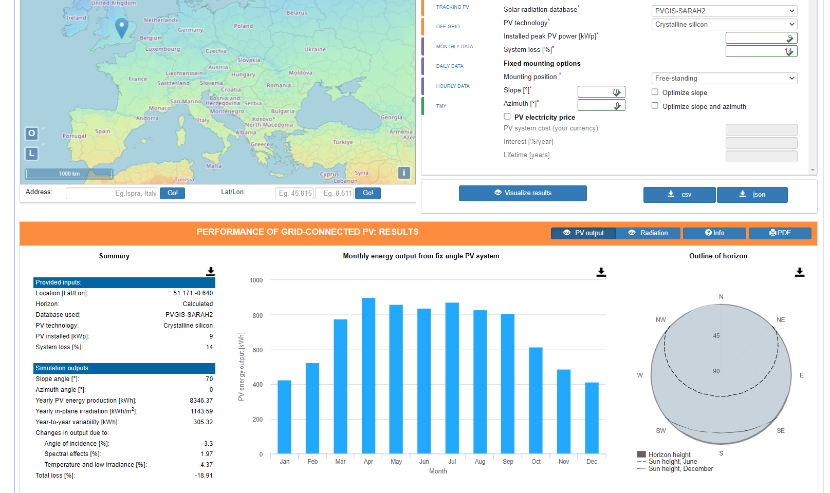

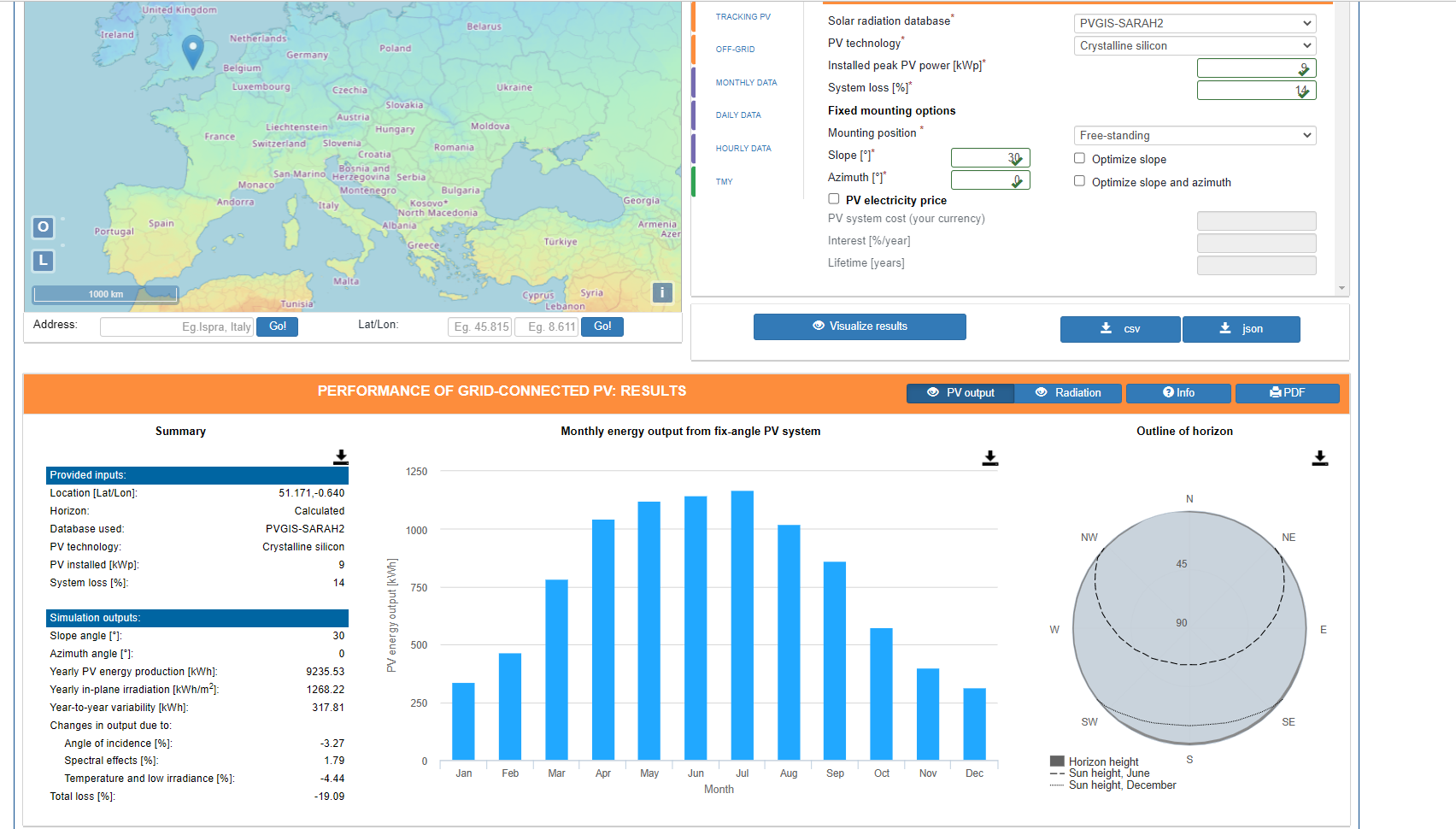

PVGIS will give you hourly generation figures so you can see how much an unshaded array should be generating at different times of the day throughout the year. You can then decide when and how much you want to generate and set your panels so there is no shading when youve chase to generate.

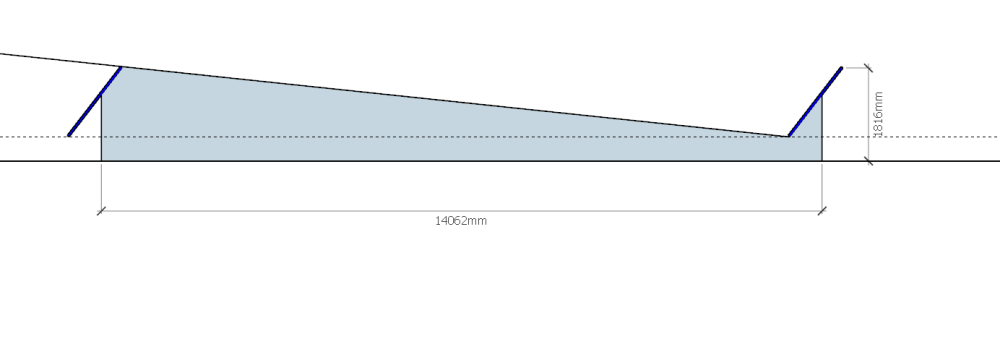

The sun it at about 6 deg elevation the Sun - Interactive Sky Chart | TheSkyLive.com  from this website at 9am on the 21st of December.
Sketching it out to scale  it appears that you would need to have 14m spacing to ensure that the rearmost panels are not shaded by the first.
You need to decide if your goal is maximum self use of the electricity or maximum annual production. The economics depend on your feed in tariff, the capacity you have to self use the power and your cost of  bought in electricity.
For maximum production 35deg works well in SE England, this enables closer spacing (especially on south facing slopes). Also an azimuth of true South is optimal. This is what commercial solar farms do.
For domestic self use the equation changes somewhat.
An angle of 35 would give 9.2MWh annually but only 338kWh in January.
An Angle of 70deg would drop annual production to 8.3MWh but the January output would be 424kWh.
Similar juggling can be done on a daily basis by splitting the array East/West giving more power in the house at times you will use it at the cost of total production. Search for  @ProDaves henhouse on here. These daily fluctuations can be buffered somewhat if you have a battery or a load that can be timed from say 11am to 1pm.
My rough guess on this is you'd be best off with a single array of 24 panels in landscape, 2 high at about 60-75 deg pointing due south.

Do the PVGIS calculations for several angles of incidence.  For us in the midlands, the annual production doesn't vary very much between say 30deg and 45deg but the winter output is far higher the more upright the panels are.   We're expecting to export a lot of our summer output (no battery yet) but want to maximise output in the winter when we won't be exporting - so for us the more vertical the better within the window of roughly similar annual output.  Ours will be a 12 panel array, in line, so no worries about shading between arrays.
