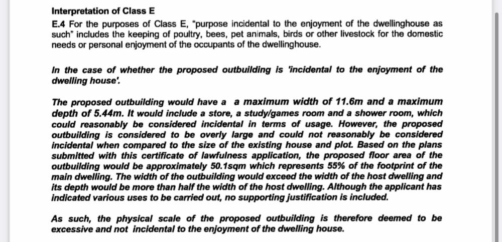

DevilDamo Posted January 16, 2023 Share Posted January 16, 2023 Although quite rare, the size(s) can come into it. Link to comment Share on other sites More sharing options...
Pabbles Posted January 16, 2023 Author Share Posted January 16, 2023 Thank you. That’s some useful background information on a past decision. Could you share the source/planning authority involved? Link to comment Share on other sites More sharing options...
DevilDamo Posted January 16, 2023 Share Posted January 16, 2023 That was Guildford, Surrey. Link to comment Share on other sites More sharing options...

mr rusty Posted January 20, 2023 Share Posted January 20, 2023 (edited) Sometimes you have to just do it. Even in @DevilDamo quote above the building is "deemed to be" rather than it actually was proven to be outside any regulation, which puts it firmly in subjective territory. The description of "store, study/games room and shower" is somewhat incompatible with the size and the smallish footprint of the house , which does suggest the applicant was possibly trying it on, and the rejection was possibly justified - nor is there any indication how controversial this development was generally. It is very easy for a planning authority to impose an "opinion" when asked, ahead of works starting - there is no downside for them. It is something of a bigger challenge for a LA to be so confident they are on such solid ground that they can initiate enforcement after the event which might entail going to appeal. The law makers went to the trouble of writing in all the restrictions for Schedule E. If they had wanted to impose a restriction in size as a proportion of the main dwelling, it would have been a one liner in the Act. They didn't, so IMHO it is challenging for a LA to try and interpret a restriction as existing when it isn't actually part of the law governing developments. The garden office @36sqm is very small in comparison to the plot size and I can't see there would be any reason for it not to be incidental, even if it has a use as a study. A garage is a garage, and if not used for anything commercial is literally that by definition - incidental. I am no expert, but from my own personal research for my own garden room, my opinion FWIW is just do it. Edited January 20, 2023 by mr rusty Link to comment Share on other sites More sharing options...
mr rusty Posted January 20, 2023 Share Posted January 20, 2023 In fact, when you read the decision from @Devildamo, it is a nonsense. "The physical scale....is excessive and is therefore not incidental". How on earth can scale which is about size, shape and form be related to "incidental" which for the purposes of planning is related to purpose and use. For this decision to conflate the two in the context of planning law surely would not stand closer scrutiny? Link to comment Share on other sites More sharing options...
