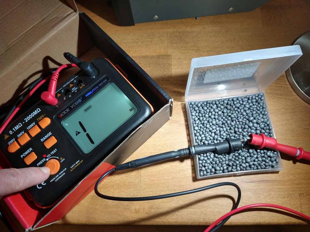

Radian Posted January 11, 2023 Share Posted January 11, 2023 On 10/01/2023 at 14:46, osprey said: my local installer claims to use Evobead, which claims to have the appropriate 0.033 W/mK thermal rating, but just seems to say the beads are 'grey'. No mention of graphite. My installer used Evobead as well. I tried analysing them with a megger to see if the graphite gave a measurable resistance but they didn't show any conductivity up to 1kV test voltage at least. I'm pretty sure they do conduct a little at static level voltages as they don't tend to cling in the same way plain EPS beads do. Link to comment Share on other sites More sharing options...
Spreadsheetman Posted January 11, 2023 Share Posted January 11, 2023 They look just the same as the beads I had injected this week. I also noticed that they don’t cling or behave like plain white eps, so there is something going on with the coating. Link to comment Share on other sites More sharing options...
