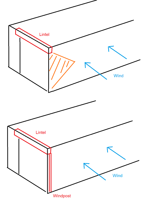

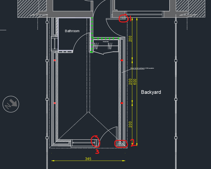

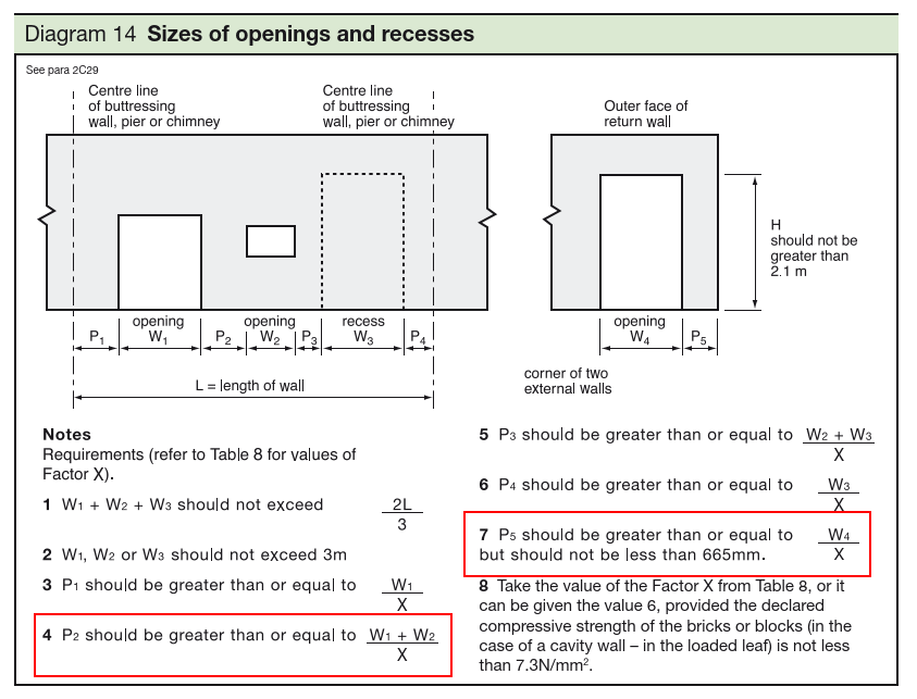

MJ6 Posted January 2, 2023 Share Posted January 2, 2023 Hi All, I'm helping a friend to build a single story 6x3.45x2.6m (LxWxH) extension to their house. The cavity wall consists off bricks, cavity and blocks, 100mm each. The architect wanted windpost design for the extension, now I'm not sure whether it's required by the Building Control Officer (BCO) or the architect asked for it from previous experience. Looking at Approved Document A, there's no clear statement to when a windpost is needed (i.e minimum brick wall length or height). Also, I found that the proposed plan doesn't match the Document A requirements of having a minimum of 665mm return (like in red circles 1 & 2), and the minimum dimension between 2 openings (P2 in the second snapshot). Probably why they asked for windposts?! So far, I more inclined that windposts are not needed, especially that it's a mid-terrace house with fences from both sides, with the left-hand side fence being very close to the proposed extension, but probably the followings should be met: Minimum of 665mm returns are built, with appropriate wall starter system Appropriate wall ties are used between wall leaves & around openings (225mm long, 225mm apart vertically) Appropriate straps to tie walls to roof Therefore; Am I thinking in the right direction? Do you think windposts will be required if the minimum returns and P2 are not met? Is there a rule of thumb to when windposts are required? Does the 3.45m wall works as a buttressing wall for the other two side walls? What are the calcs needed to justify not using windposts? (e.g. Masonry wall panel design to EN1996?) Many thanks! Snapshot from Approved Document A Link to comment Share on other sites More sharing options...
Bonner Posted January 2, 2023 Share Posted January 2, 2023 The architect has probably suggested windposts due to the lack of buttressing by appropriate return walls. I don’t think the end wall qualifies as a buttress even assuming there is a lintel and masonry above the door, it won’t give the same stiffness as a full height wall. Normally they would say windposts or buttressing ‘to be confirmed by structural engineer’. Have the drawings been submitted to building control for approval yet? 1 Link to comment Share on other sites More sharing options...
nod Posted January 2, 2023 Share Posted January 2, 2023 Your Architect is probably prompting what BC will as for Wind posts are incredibly easy to install We had a similar extension on our last home I intended putting WPs in But our engineer designed an elaborate steel plate system bolted to the house I go with your Architects suggestion 1 Link to comment Share on other sites More sharing options...
George Posted January 2, 2023 Share Posted January 2, 2023 The 345cm end wall isn't a buttressing wall - doors and windows are not structural components. It sometimes is possible to deign a masonry wall to span top to bottom, but this has much less lateral capacity and requires a lot of fiddly detailing. much more robust is to use a windpost. The building regulations are a bit out of date on minimum return length. A wall with a cavity o 75mm needs 665mm. But many walls now have cavities of 100mm+ - this really needs a return of 780mm. Quote it's a mid-terrace house with fences from both sides, with the left-hand side fence being very close to the proposed extension That's fine until the beast from the east MkII rolls through, blowing over the fences. Structural design for domestic houses needs to consider a 50 - 60 year time span. In summary: Am I thinking in the right direction? Yes Do you think windposts will be required if the minimum returns and P2 are not met? Yes Is there a rule of thumb to when windposts are required? Masonry panels require support to be able to resist lateral loads. Most common is buttress wall in accordance with Part A. Designed solutions almost always require a windpost. Does the 3.45m wall works as a buttressing wall for the other two side walls? No What are the calcs needed to justify not using windposts? (e.g. Masonry wall panel design to EN1996?) EN1996 would suffice but it is unlikely to work without a windpost anyway. 1 Link to comment Share on other sites More sharing options...

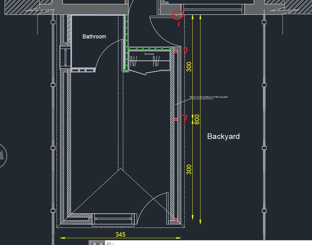

MJ6 Posted January 2, 2023 Author Share Posted January 2, 2023 9 hours ago, Bonner said: Have the drawings been submitted to building control for approval yet? I spoke with the architect, the drawings were submitted for approval and it was the BCO who asked to explore the windposts option. I agree with your point about the small wall not being considered as a buttress, that's why I asked the question just to confirm. Any thoughts on the left hand side wall? Link to comment Share on other sites More sharing options...

Bonner Posted January 2, 2023 Share Posted January 2, 2023 17 minutes ago, MJ6 said: Any thoughts on the left hand side wall? I can’t see any dimension of the return wall but I would say there is an argument that WP’s are not necessary on that side. You will need a SE anyway so see what they come up with. 1 Link to comment Share on other sites More sharing options...

George Posted January 2, 2023 Share Posted January 2, 2023 (edited) 55 minutes ago, MJ6 said: As for point 2, would BCO be ok for not having these in place anyway? And if sufficient returns are applied, will WPs still be required? Also, what are your thoughts on the left hand side wall? Considering it only has a small bathroom window with sufficient returns at both ends. Any wall panel which complies with Part A rules is fine and won't need additional windpost/justification. Anything that doesn't comply will need a structural engineer's input to satisfy BC. I've rarely ever made a (non-Part A compliant) wall panel work without putting in a windpost or reinforcement. Windposts are a bit pricey but fundamentally are just a steel section with a bolt top and bottom. Left hand side appears fine to me. Only 6m long and at the bottom corner the two walls buttress each other. House construction is all about building boxes! Edited January 2, 2023 by George 1 Link to comment Share on other sites More sharing options...
MJ6 Posted January 2, 2023 Author Share Posted January 2, 2023 1 hour ago, George said: Any wall panel which complies with Part A rules is fine and won't need additional windpost/justification. Anything that doesn't comply will need a structural engineer's input to satisfy BC. I've rarely ever made a (non-Part A compliant) wall panel work without putting in a windpost or reinforcement. Windposts are a bit pricey but fundamentally are just a steel section with a bolt top and bottom. Left hand side appears fine to me. Only 6m long and at the bottom corner the two walls buttress each other. House construction is all about building boxes! I think I have a better understanding of Part A now, thanks to your comments. So if you don't have a buttressing wall/chimney/pier and/or sufficient returns, then an alternative solution should be explored, which is WPs in our case, otherwise to reinforce the wall. As for the left-hand side wall, this has both 90cm start/return, so this is Part A compliant. But in general, is there a maximum length of the wall to comply with this rule, considering openings are less than 3m? As for the 345cm wall, considering a long lintel is installed over the door and window with stuffiest tying to the other walls, would this provide enough stability? What about the lack of return (P5) in the right hand corner? Link to comment Share on other sites More sharing options...
George Posted January 2, 2023 Share Posted January 2, 2023 (edited) 53 minutes ago, MJ6 said: I think I have a better understanding of Part A now, thanks to your comments. So if you don't have a buttressing wall/chimney/pier and/or sufficient returns, then an alternative solution should be explored, which is WPs in our case, otherwise to reinforce the wall. As for the left-hand side wall, this has both 90cm start/return, so this is Part A compliant. But in general, is there a maximum length of the wall to comply with this rule, considering openings are less than 3m? As for the 345cm wall, considering a long lintel is installed over the door and window with stuffiest tying to the other walls, would this provide enough stability? What about the lack of return (P5) in the right hand corner? Maximum wall length covered by Part A rules is 12m. Although usually you start to break the rules (due to multiple openings etc) when you go over around 6m. No a lintel won't provide lateral stability. Walls are panel structures and panels need linear supports else they will span in two directions. For masonry this rarely works. A lintel will only support it at a 'point' (in the top corner). The difference looks a bit like this: Orange zone being at risk. I'm afraid we're into the realm of 'step 1: attend university and do a civil engineering degree' but fundamentally, the layout proposed does need a windpost. Best person to speak to next is an engineer who can specify what you need. Potentially a windpost manufacturer would do the calculation for you as well. What I would do is put a windpost at point 'W' and make the studwork wall a shear wall a point 'S' (this would be an extra layer of OSB and some additional strapping to the wall and the floor). Edit - actually what are the red blobs? Are they the proposed windposts or something else? Edited January 2, 2023 by George 2 Link to comment Share on other sites More sharing options...

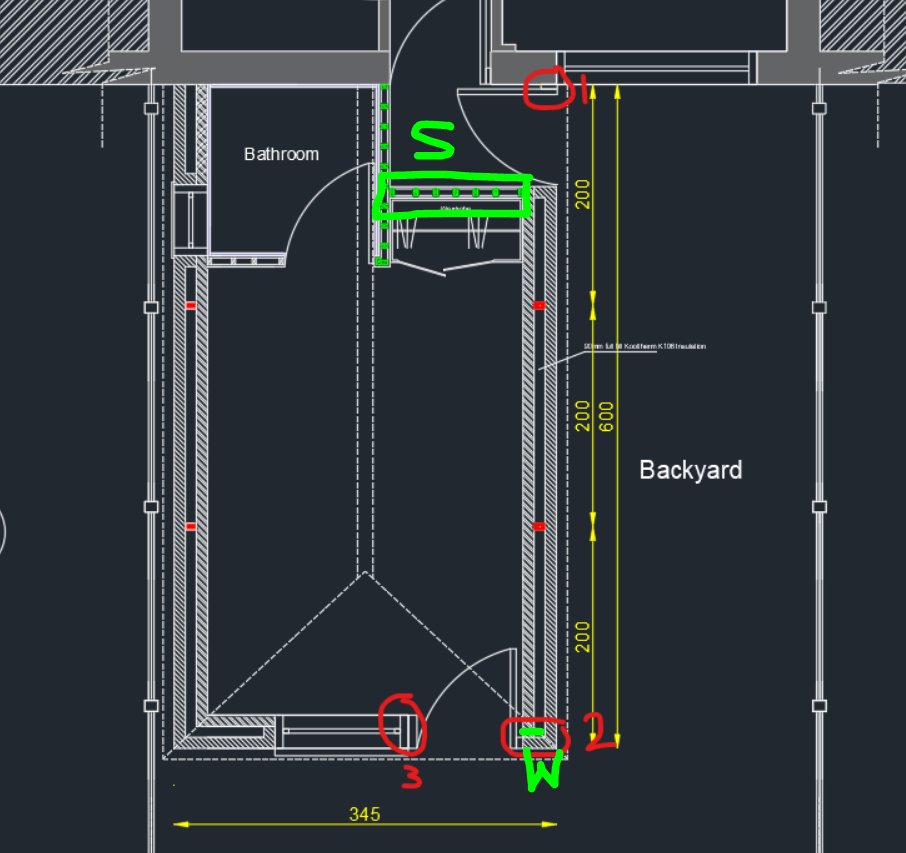

MJ6 Posted January 3, 2023 Author Share Posted January 3, 2023 1 hour ago, George said: No a lintel won't provide lateral stability. Walls are panel structures and panels need linear supports else they will span in two directions. For masonry this rarely works. Sorry, as for the lintel, I was referring to the 345cm wall, I know it won't stabilise the long wall. So just saying that one side would have a 90cm (P5) return but the other won't, which as I understood is non-Part A compliant, hopefully I got that right! 1 hour ago, George said: Best person to speak to next is an engineer who can specify what you need. I spoke with a couple, who advised no WPs are needed, if the 3 points suggested in my original post are followed! But as I wanted to be sure, I asked the question here. 1 hour ago, George said: Edit - actually what are the red blobs? Are they the proposed windposts or something else? Yes they're, but now we know they're not needed for the left wall, only the right hand one. Your suggestion of adding a WP at the bottom right corner would serve both walls I think, but as for the shear wall behind the wardrobe, can't this be replaced with another WP either at the start or the middle of the wall (where I put red "?")? - I understand that full calculations still need to be provided here. Thanks again George, and sorry if it's a lot. Link to comment Share on other sites More sharing options...
Bonner Posted January 3, 2023 Share Posted January 3, 2023 9 hours ago, MJ6 said: but as for the shear wall behind the wardrobe, can't this be replaced with another WP Quite sure you can, I think the suggestion was to save cost. A shear wall will probably work out cheaper than a WP 1 Link to comment Share on other sites More sharing options...
