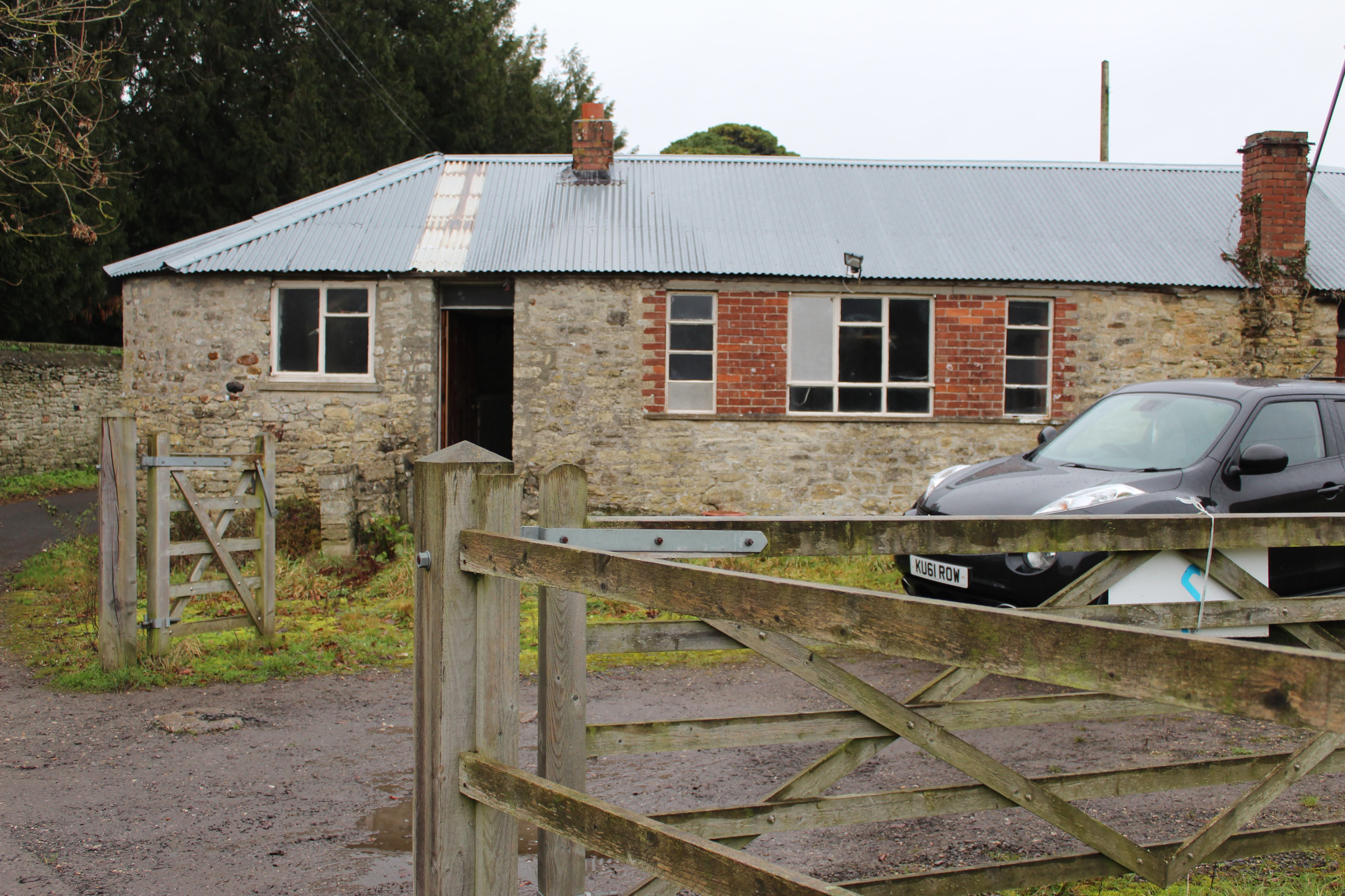

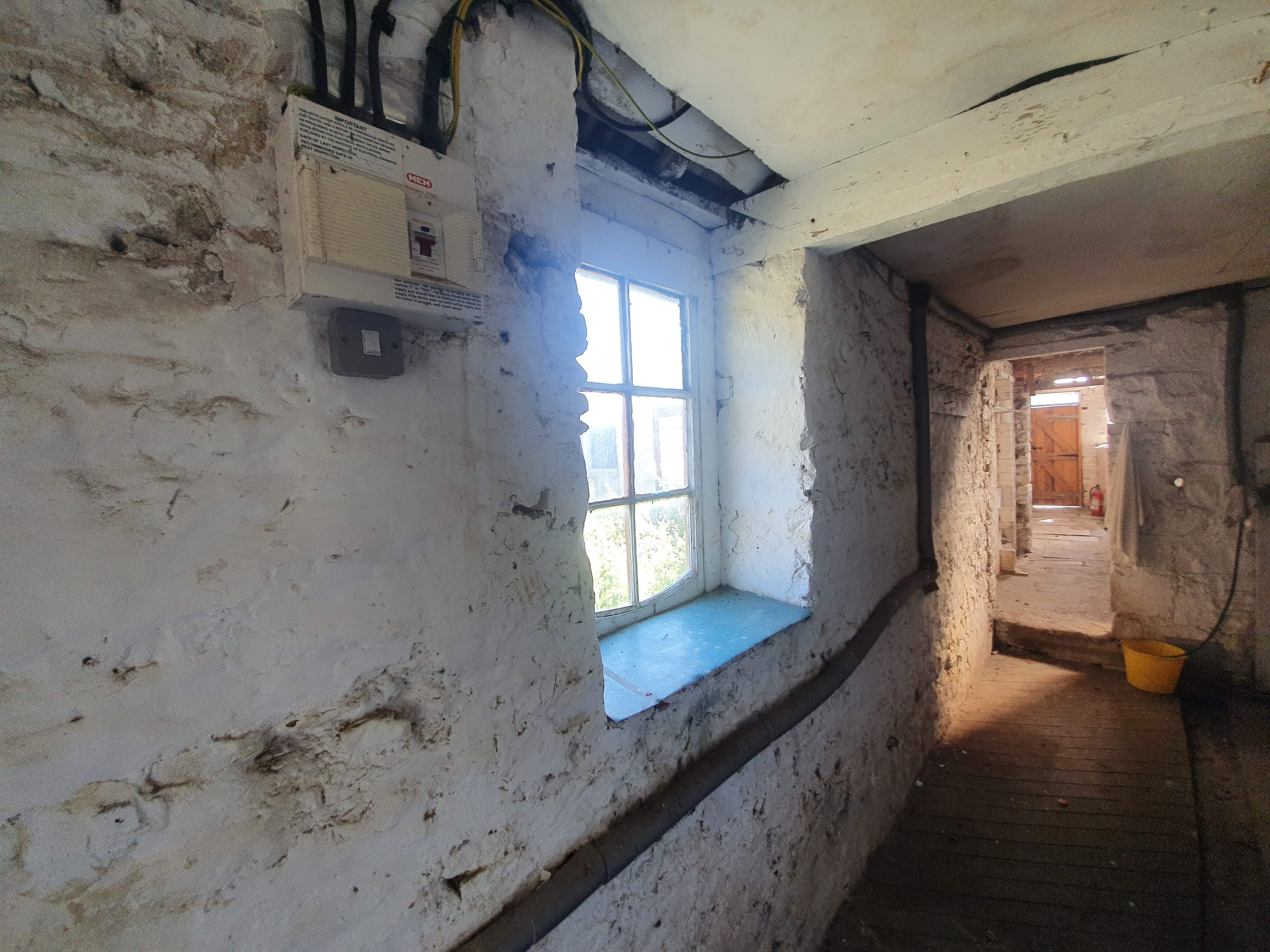

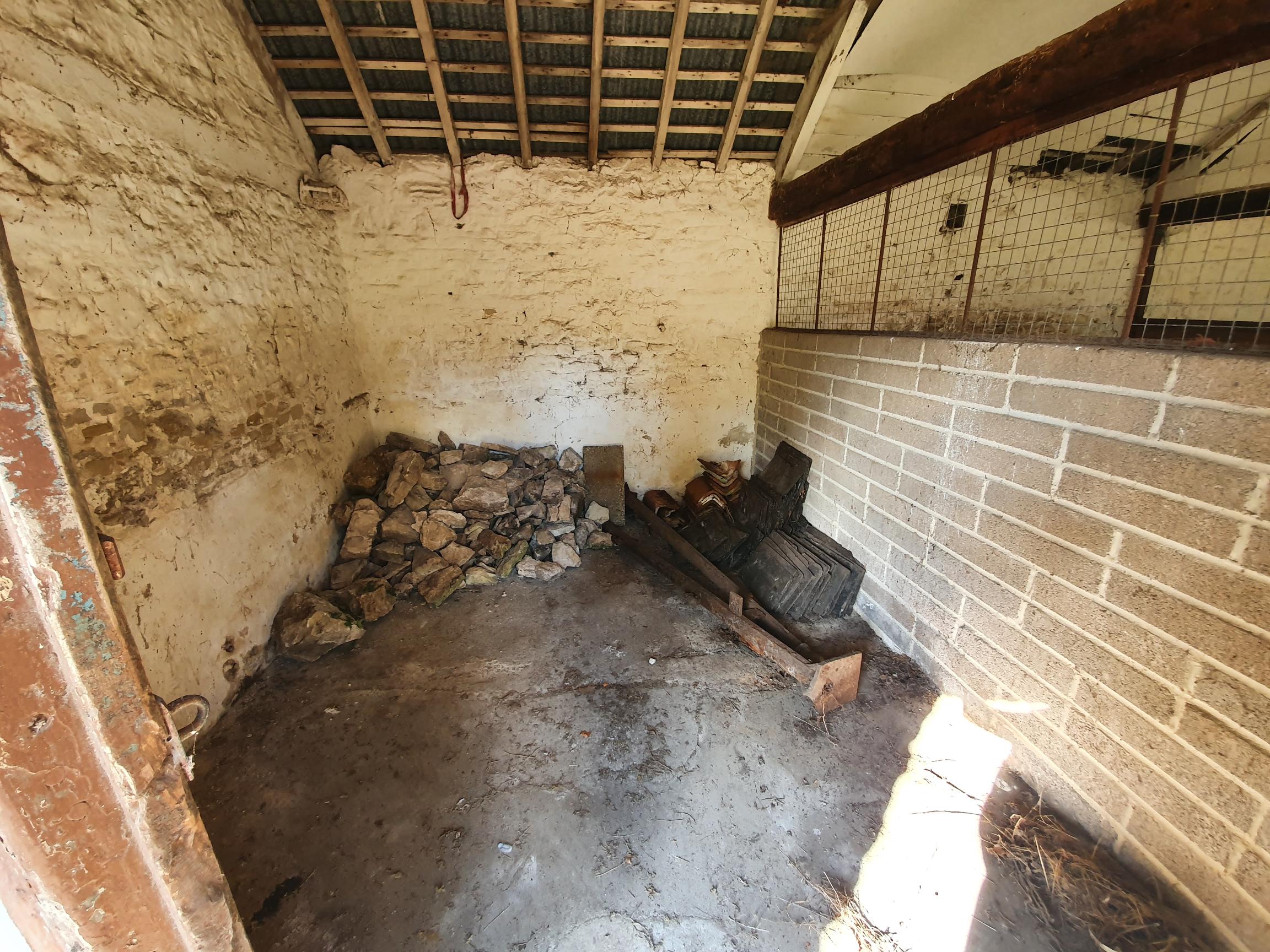

TPickford Posted December 28, 2022 Posted December 28, 2022 Solid stone stable building in a conservation area. It has taken us 2 years to get all the planning. We live in Singapore currently and are doing this remotely with a project manager. Our conservation officer has insisted we ensure the building is insulated with breathable products - being totally naive about everything we are now doing the research we should have done before! It seems our PM was happy to use modern methods, having done the research we realise this is not necessarily the best way. Hoping to find more help on here....

Redbeard Posted December 28, 2022 Posted December 28, 2022 ...and if you don't knock it down... Â I would use rigid wood-fibre, and get a WUFI (or similar) dynamic condensation risk analysis done first to inform the 'safe' depth you can use. Some say only 60-80mm, some say 100 OK in some circumstances, but bear in mind that, depending on the exg fabric the resultant U value will be worse than 0.3W/m2K, probably. Some would say use plastic ins (PIR nearly twice as good for a given thickness as some rigid WF) and just get the vapour control right. It is this bit - getting the VC layer right - which, while hardly rocket science, can often be done badly. Difficult for you to control from abroad! Â My stance on wood-fibre is that if it is designed to operate without a VCL that's one VCL not to get messed up. I have used it a lot, internally and externally. Is the pointing done in lime, by the way? 1
Mr Punter Posted December 28, 2022 Posted December 28, 2022 That is a shame. Properly done it could look far better than currently. No more cement based pointing, concrete cills and lintels, brick stretcher window reveals and metal roof. Did the Conservation Officer entirely dismiss the idea?
TPickford Posted December 29, 2022 Author Posted December 29, 2022 @Mr PunterThe metal roof is being replaced by slate tiles and the pointing re-done with lime. We wouldn't want to knock it down as we love it as is, just want to make sure we look after it properly. We haven't asked if we could knock it down but as they are being so strict with conditions we have assumed it would be no.  @Redbeardthanks for the advice
