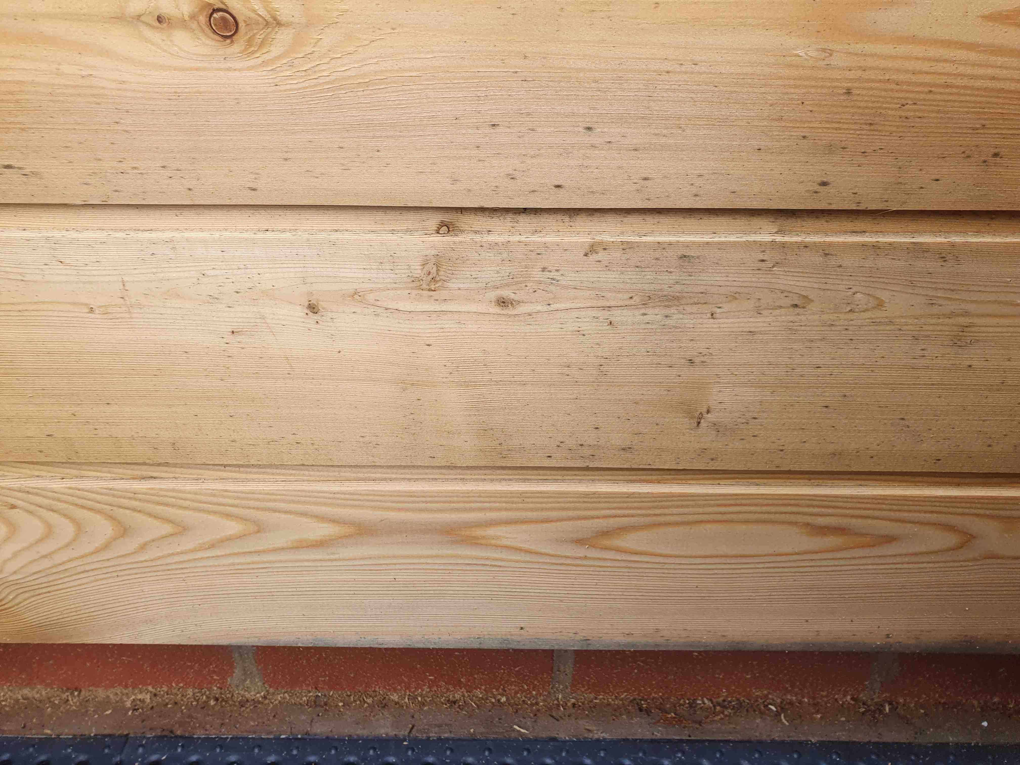

Moonshine Posted December 23, 2022 Share Posted December 23, 2022 I have installed a bunch of larch cadding, and in a few areas there is what appears to be mold spots. We haven't treated the larch and want it to go the silver colour Is this normal weathering? Link to comment Share on other sites More sharing options...
nod Posted December 23, 2022 Share Posted December 23, 2022 It’s normal It will all turn the same colour eventually 1 Link to comment Share on other sites More sharing options...
SuperJohnG Posted December 23, 2022 Share Posted December 23, 2022 (edited) It's normal, the mold is actually eating the sugars in the timber. Will go away and it will all weather Edited December 23, 2022 by SuperJohnG 1 Link to comment Share on other sites More sharing options...
