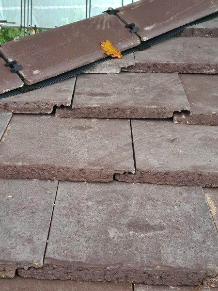

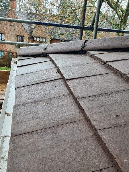

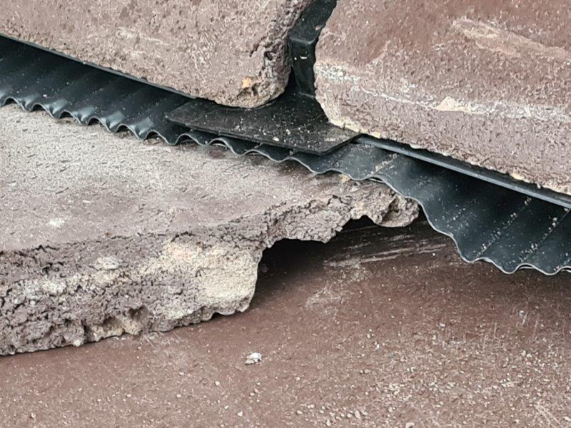

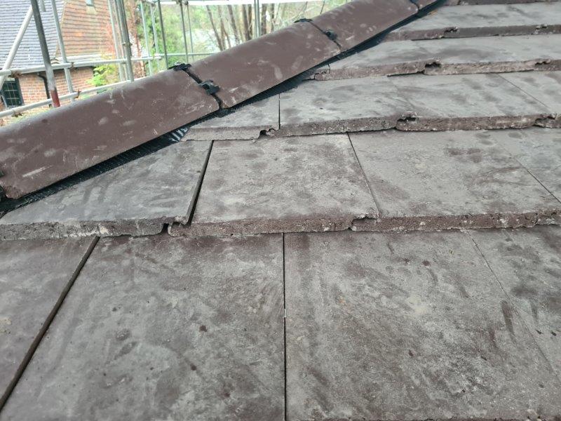

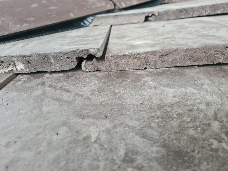

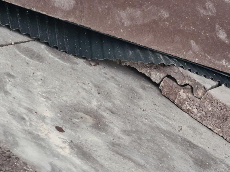

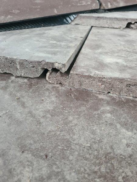

w1zard Posted December 19, 2022 Share Posted December 19, 2022 Got completed a new roof and I have a question on the finish as there are two items I am unsure of 1) the gap between the cloak ie the stickly strip isnt fastened on the concrete interlack tiles 2) Some of the tiles are not sitting level I enclose some pictures as this is the first dry ridge I have been involed with Would be great to have some feedback as to the quality of the finish on the above points Thanks Link to comment Share on other sites More sharing options...
twice round the block Posted December 20, 2022 Share Posted December 20, 2022 Welcome on board. The pitch of the roof looks shallow for that style of tile. We're they specified by the architect ? Link to comment Share on other sites More sharing options...

w1zard Posted December 20, 2022 Author Share Posted December 20, 2022 its new truss roof and new tiles Link to comment Share on other sites More sharing options...
w1zard Posted December 20, 2022 Author Share Posted December 20, 2022 re the pitch yes specified and they match the pitch angle with the manufacturer spec Link to comment Share on other sites More sharing options...
Dave Jones Posted December 20, 2022 Share Posted December 20, 2022 thats poor. the bottom row of tiles hasnt had a kicker batten fitted so they are 'drooping'/ hanging low. The hip needs hip trays fitting above the dry kit. overall, poor workmanship. 3/10 Link to comment Share on other sites More sharing options...
Marvin Posted December 21, 2022 Share Posted December 21, 2022 What the overlap 100mm? Link to comment Share on other sites More sharing options...
w1zard Posted December 21, 2022 Author Share Posted December 21, 2022 overlap is 100mm 1 Link to comment Share on other sites More sharing options...
