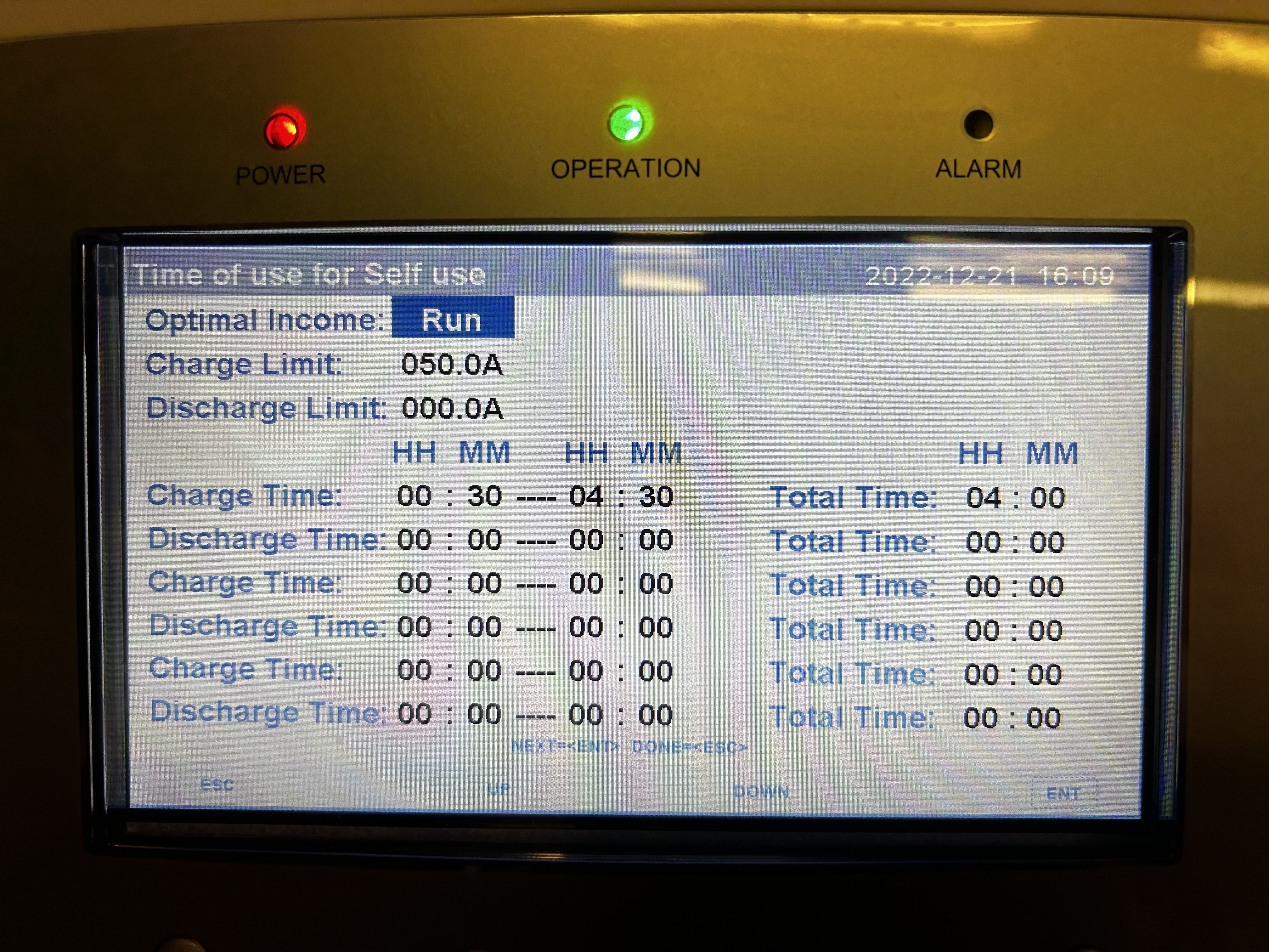

Chrisofle Posted December 7, 2022 Share Posted December 7, 2022 Hi, Newbie here, hoping for some help and advice. I am looking at having a new PV and battery system to our home. The system I have been offered is a 4.9kw system consisting of the following: 11nr 450 watt Znshinesolar panels Solis 5G RHI Hybrid Inverter- RHI-5K-48ES-5G 3.3kwh Growatt Battery ML33RTA. Could anyone confirm if the Solis Inverter can be set up to charge the batteries using off peak rates? I was thinking this may be an option in the winter months when the PV is not performing as well. My current usage is: DAY NIGHT COMBINED Month USAGE USAGE USAGE MAR/APRIL 505 245 750 FEB/MAR 519 274 793 JAN/FEB 616 352 968 DEC/JAN 573 153 726 NOV/DEC 490 250 740 OCT/NOV 491 292 783 SEPT/OCT 421 184 605 AUG/SEPT 452 240 692 JULY/AUG 412 230 642 JUNE/JULY 469 265 734 MAY/JUNE 511 228 739 APRIL/MAY 499 278 777 ANNUAL 5958 2991 8949 Even though I do have electrical back ground I’m finding this a bit of a mind field. Many thanks in advance any advice. Link to comment Share on other sites More sharing options...

Chrisofle Posted December 8, 2022 Author Share Posted December 8, 2022 Many Thanks for the replies. Due to budget and the fact we will only be in this house in the short/medium term we are quite happy just to subsidize our electricity bills. I believe we will be about 40% self sufficient with this set up. My question regarding off peak charging, was whether this inverter has the option to charge the batteries at night whilst we are on off peak cheaper electricity rates. Thanks Chris Link to comment Share on other sites More sharing options...
RichardL Posted December 21, 2022 Share Posted December 21, 2022 (edited) Yes - you can charge off peak - I'm doing exactly that since the solar only generates a couple of kW hours over the winter. Check out the timed charge functionality Advanced settings (default password is 00010) Storage energy set, Storage mode (is probably self use - just click through) Time of use... Mine looks like this (pictured) for Octopus go 00:30-04:30 off peak. The charging amps is only relevant IF a. your BMS does not control charge rate and b. your inverter is sized so it can't overload its grid cable. This is a solis hybrid 5k - might look slightly different, + if theres no batteries you might need to find its 'keep awake' option to stop it shutting off when there's no solar overnight. Does that answer the question? Edited December 21, 2022 by RichardL Link to comment Share on other sites More sharing options...

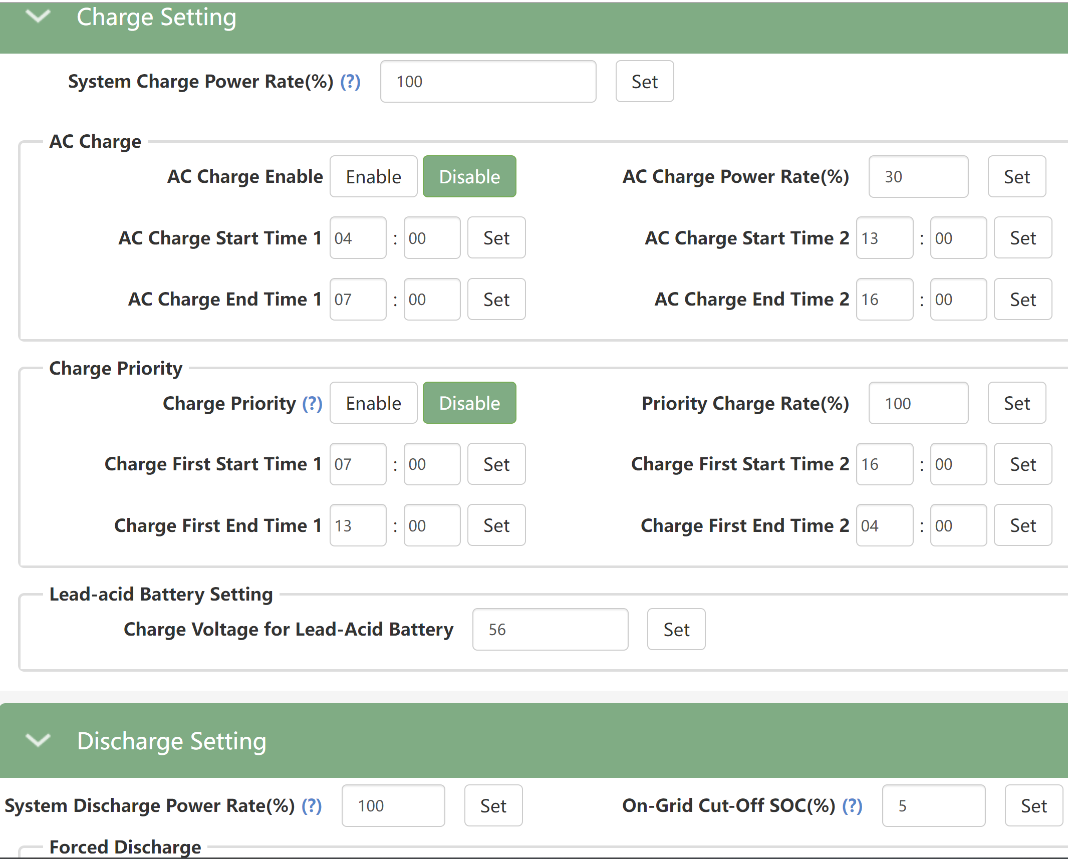

athlonoc Posted February 3, 2023 Share Posted February 3, 2023 Hope you don't mind me jumping in on this thread. My installation has a Solis inverter and Pure Drive battery. The Solis Cloud Monitoring App shows that all PV generated power always goes to the battery both day and night. This indicates that there is no self use energy being generated albeit the solar charging of the battery in effect is doing that but it suggests that the battery is constantly being charged as first priority to provide solar generated energy. Does that make sense? I thought the order of generated solar power was; Self Use, then Battery charging ( when self use needs were met at any given time ), then back to the grid (if self use met and battery was full) I'm unable to get any assistance at this moment in time from the installer. I've attached an image to show the predicament. Thank you Link to comment Share on other sites More sharing options...
PhilT Posted February 3, 2023 Share Posted February 3, 2023 You should be able to access settings and disable the "charge priority" function, can you check to see if you can do that? Link to comment Share on other sites More sharing options...
athlonoc Posted February 3, 2023 Share Posted February 3, 2023 Thanks for the solution. I'll have a look when I get home. I know that he set it up to charge battery between 00:30 and 04:30 to take advantage of the cheaper tariff but I thought that condition would only apply to that time. When I have a look will there be an option to only charge battery during the night but set priority during daylight to be Self Use / Battery / Back to Grid? Thank you Link to comment Share on other sites More sharing options...
PhilT Posted February 3, 2023 Share Posted February 3, 2023 8 minutes ago, athlonoc said: When I have a look will there be an option to only charge battery during the night but set priority during daylight to be Self Use / Battery / Back to Grid? There should be, something like this, which at the moment is in the default self-use state but as you can see almost any combination of Default, AC Priority or System (Panels/battery) Priority, together with time selections, should be possible Link to comment Share on other sites More sharing options...
athlonoc Posted February 5, 2023 Share Posted February 5, 2023 Thank you for this. I've been up into the loft and looked at the settings but want to tread carefully with the settings. Under the advanced settings, how do you get to this page setting. I guess it's under a different sub heading. At this stage I don't want to change anything but instead see what its set to. Thanks Link to comment Share on other sites More sharing options...
PhilT Posted February 5, 2023 Share Posted February 5, 2023 20 minutes ago, athlonoc said: Under the advanced settings, how do you get to this page setting. I guess it's under a different sub heading. I never touch the inverter, everything is done via an app. Can you not get at the settings via the app from which you took the screenshot in your earlier post? Link to comment Share on other sites More sharing options...
athlonoc Posted February 14, 2023 Share Posted February 14, 2023 On 05/02/2023 at 14:59, PhilT said: I never touch the inverter, everything is done via an app. Can you not get at the settings via the app from which you took the screenshot in your earlier post? Hi PhilT No, the app is very limited. The only way I could change any of those settings is using the control panel on the inverter. I've been told the Solis Cloud App is somewhat limited and not the most accurate and that I shouldn't read too much into it. Seems strange that an app is provided to show what's happening but you can't take too much notice of it!!!! Solis need to up their game with app development. So many app developers out there you would think it's quite easy to get one working efficiently. Link to comment Share on other sites More sharing options...
