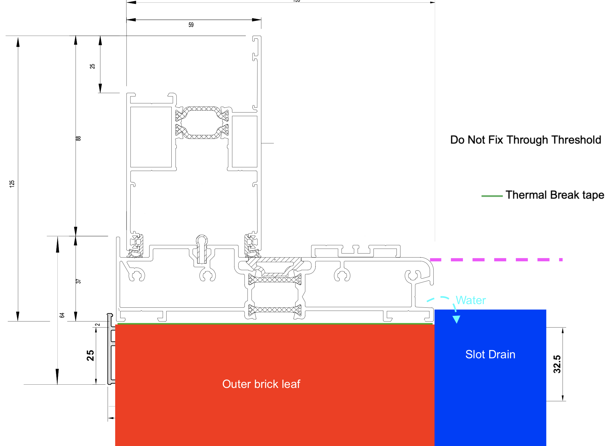

GaryChaplin Posted December 5, 2023 Share Posted December 5, 2023 On 06/12/2022 at 22:03, SBMS said: Yep, am getting that now! Tbh, we're sorted inside. as that's just about internal floor levels. It's the external bit we've struggled with. So if we put a slot drain in front of the track, I assume that the top of the slot needs to be lower than the top of the track profile, for the water to be able to leave? I'm not sure how the drain could be totally flush with the top of the track (my pink dotted line on diagram below), unless the drain took water from the side, rather than the top? (crude drawing below): Interesting reading. I have exactly the same issue. Did you come to a conclusion? Link to comment Share on other sites More sharing options...
SBMS Posted December 12, 2023 Author Share Posted December 12, 2023 On 05/12/2023 at 19:09, GaryChaplin said: Interesting reading. I have exactly the same issue. Did you come to a conclusion? Hi Gary Yes we pretty much did the detailing as my diagram. We sacrificed 10-20mm or so so are not completely flush because we do get heavy rain and there’s no overhang so I went belt and braces. We put the cill on and drains into a slot drain. Can barely tell it’s not flush and it’s pretty level and have had no issues. Link to comment Share on other sites More sharing options...

GaryChaplin Posted December 13, 2023 Share Posted December 13, 2023 Thanks for the reply. I'm hoping to use an ACO threhsold drain abutting the sill, then cut slots in the plastic section of the drain to insert the door sill into. Below would be an additional waterproofed drain into a french drain I have around the whole building. Though I suspect I'll change the plan when the doors arrive! Something like this: Link to comment Share on other sites More sharing options...
