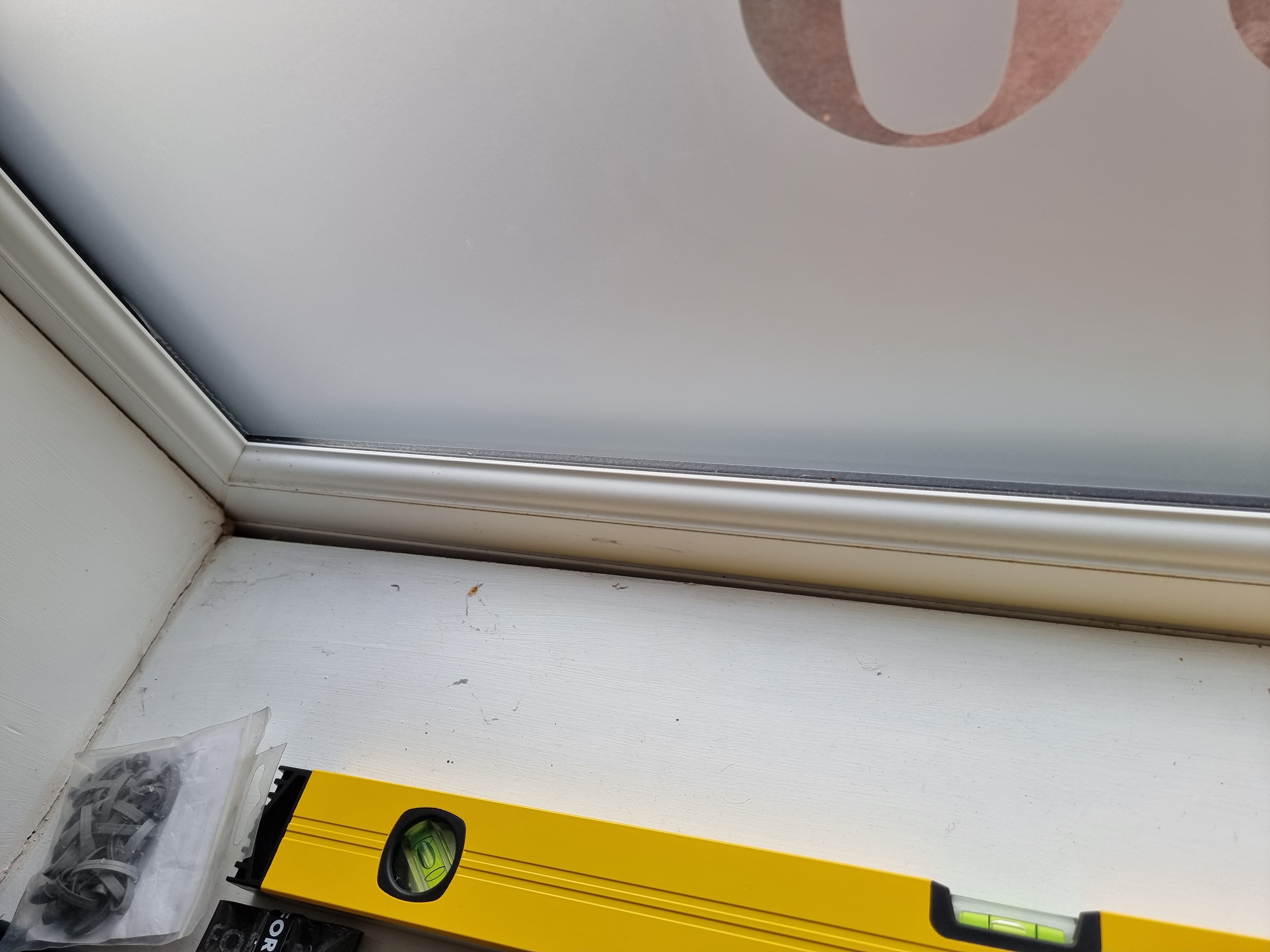

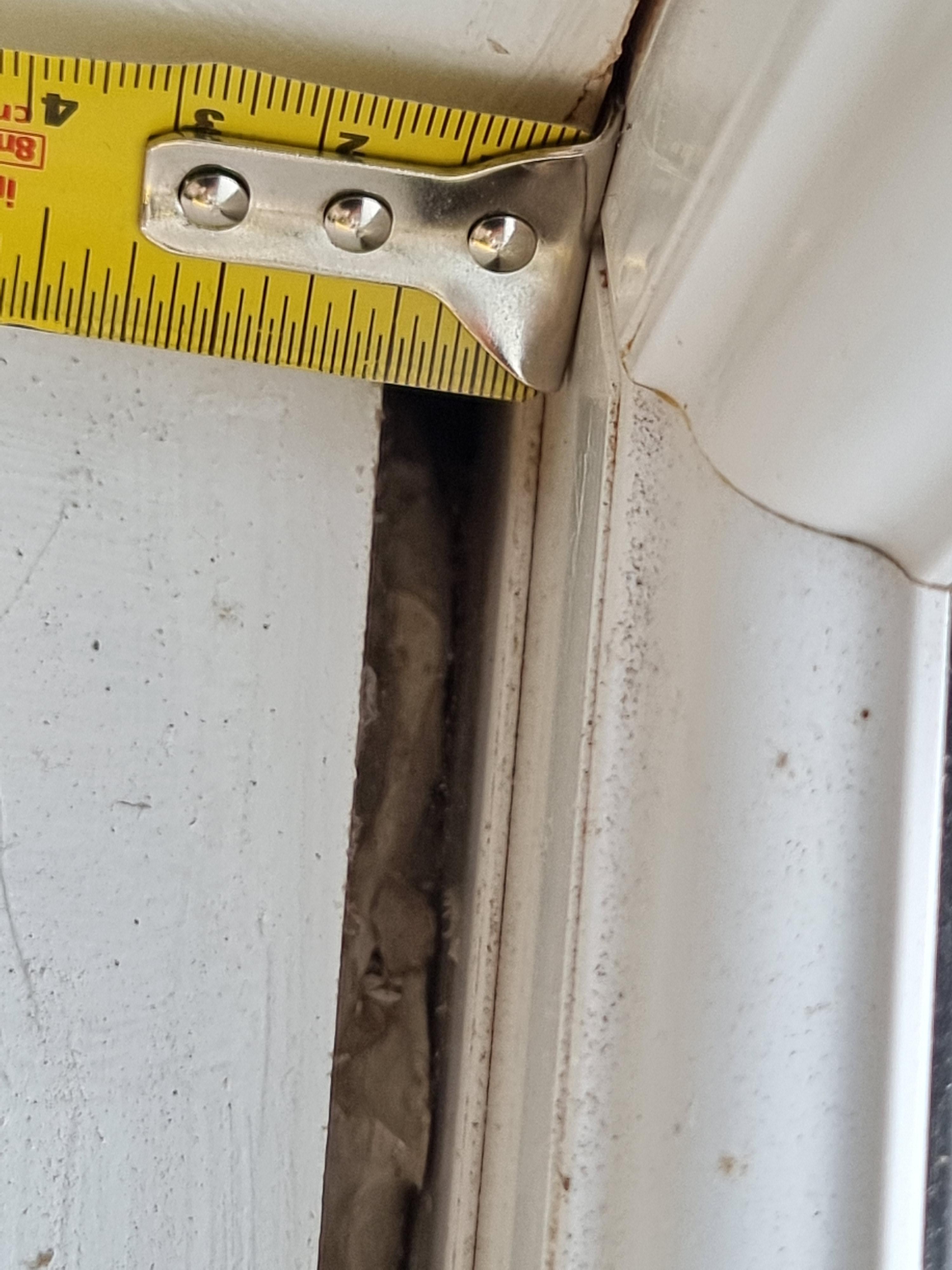

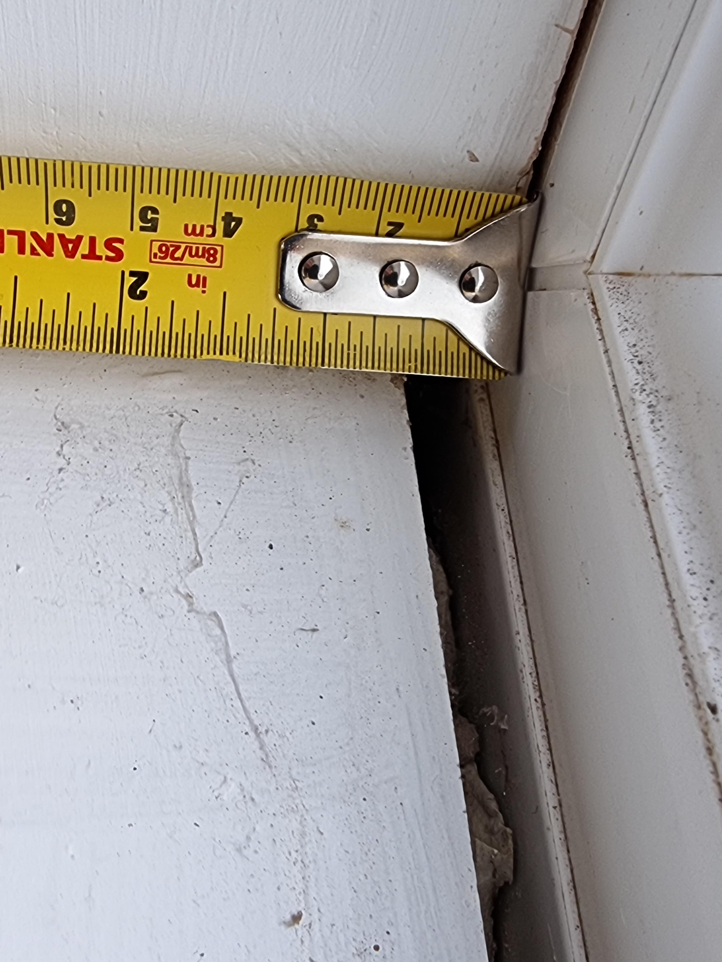

newbie282 Posted December 6, 2022 Share Posted December 6, 2022 Hi, I'm a complete newbie & wanted your expert opinion on how to tackle this. Noticed a fairly wide gap on the window sill of a non opening UPVC window (almost 1.5 cm). It's only been installed in 2019 & was looking around house for draughts & cold spots when I came across this. How can I fix this ? Read online about expanding foam. Will it be too much for filling this gap? Or are there any other products I could use? Any suggestions & opinions more than appreciated! I have attached pictures of the window. Thanks ! Link to comment Share on other sites More sharing options...
Nickfromwales Posted December 6, 2022 Share Posted December 6, 2022 I'd mask up and inject with a closed cell foam such as Illbruck and then fit a strip of 25mm PVC D-section LINK from cill to frame to cover it over. 1 Link to comment Share on other sites More sharing options...
Olf Posted December 6, 2022 Share Posted December 6, 2022 IF the window is well fitted (big IF), then that would be cosmetic only and any strip the look you like will do it. But likely this is where spiders get inside (no joking, I had it) and you either foam it or fill with appropriate sealant. Illbruck and Soudal make dedicated products, Soudal SWS actually suggests foam, internal and extrenal sealant. If you go for foam, mask the area around as it likes to splash, expands, and then is b!tch to remove. Cover with strip (or at least filler or lick of paint) to protect foam from UV degradation. With sealant alone you can possibly get away with extra strip, though lose thermal insulating properties of foam. Link to comment Share on other sites More sharing options...
