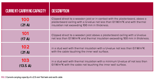

Temp Posted December 6, 2022 Share Posted December 6, 2022 (edited) The insulation is not likely to be an issue for lighting cables. For power cables there might need to be some derating if this hasn't been taken into account. Typically if you know its going in/undervinsulation you can specify a thicker cable or smaller RCD/MCB but again not always necessary. Remember most power circuits are rings so there are two wires in parallel. Discuss with your electrician. https://professional-electrician.com/technical/impact-thermal-insulation-current-carrying-capacity-flat-twin-earth-cables/ In Fig 2, the current-carrying capacity of a 2.5 mm2 flat twin and earth cable is shown in brackets for each of these Installation Methods. Edited December 6, 2022 by Temp Link to comment Share on other sites More sharing options...
nod Posted December 6, 2022 Share Posted December 6, 2022 There’s no issues with using a wool type insulation between joists Pretty much as in the loft Cables are buried under at least three layers of insulation Link to comment Share on other sites More sharing options...
