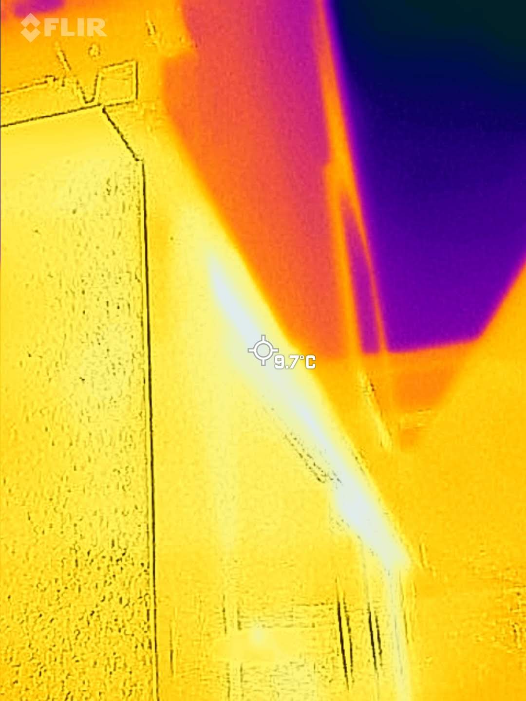

I'll show you a horror-show photo of the  6m span 'I' beam over this elevation containing sliding doors:
The 'I' beam has a 300mm welded 'foot' on the underside to carry the timber frame above. Nobody thought about how this would end up in the cold on the outside. I think this might qualify for the worst cold bridge of all time 😂
