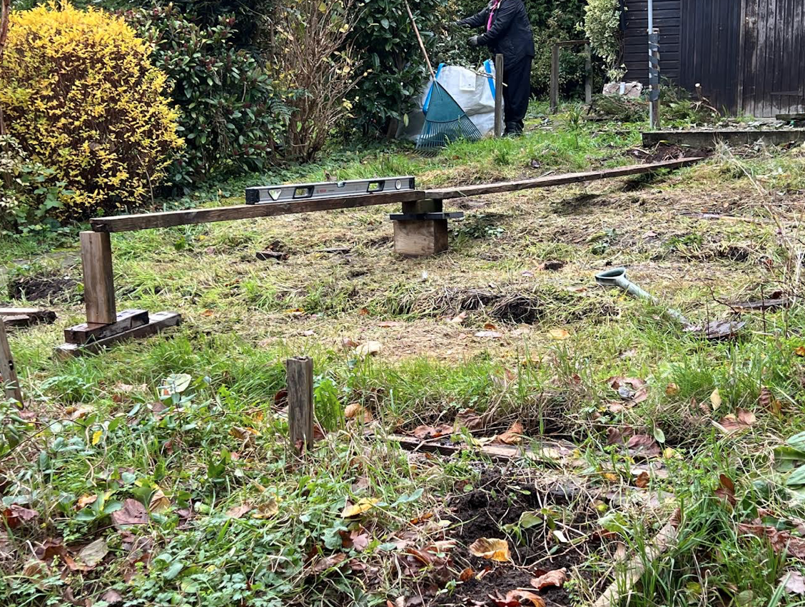

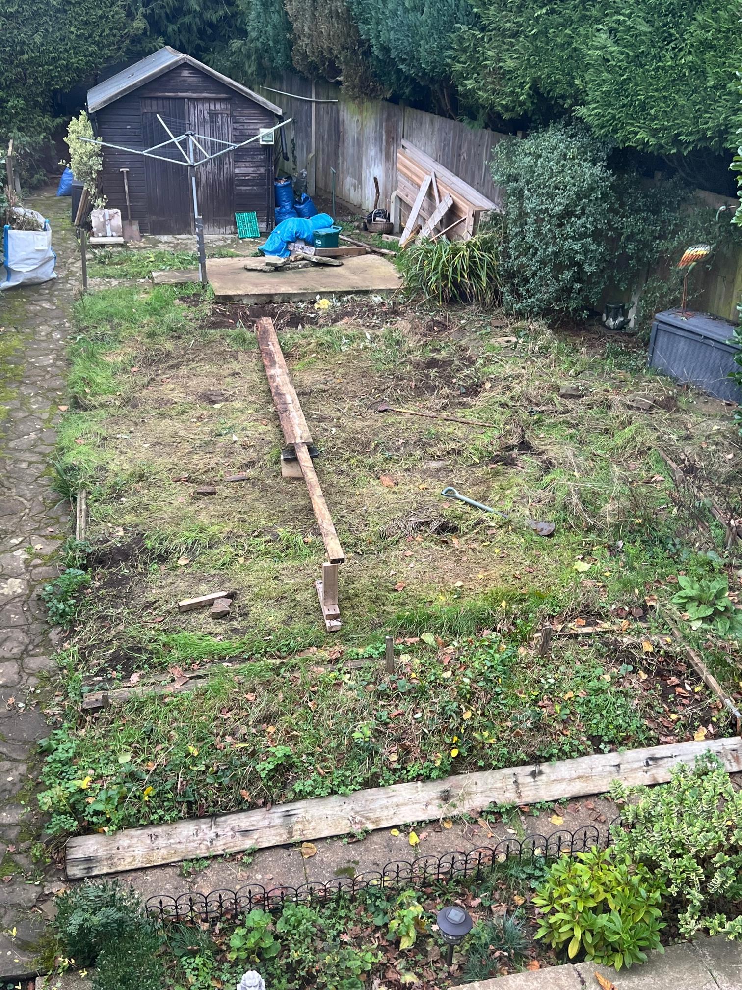

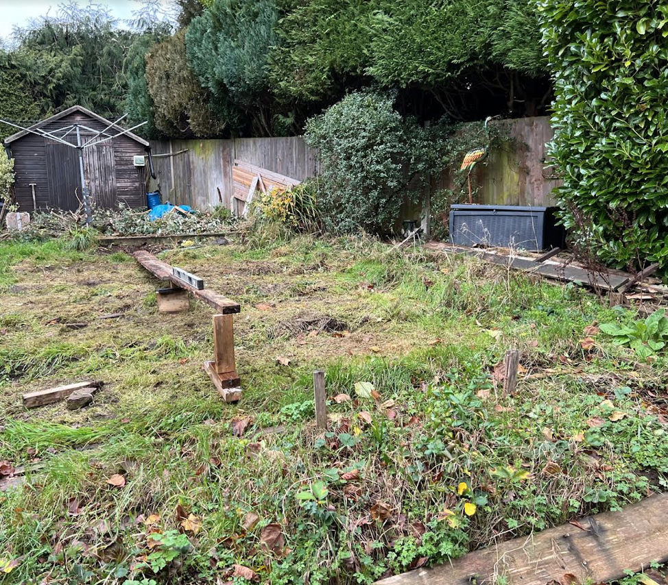

I'm planning on building a garden room / workshop on our old veg patch next year and first thing I need to tackle is the foundations. I've attached some pictures of the area below, we're looking at something around 4m wide by 6m long. As you can see the area is on a decline, I have put a rough level on so you can see this.
My debate is what kind of foundations would work best for this project, so any suggestions would be greatly welcomed. I've been looking at a steel bar / square plate pile foundation similar to that used by Oakwood garden rooms on Youtube but I'm sure there are plenty of viable options out there.

What's the build? Masonry or timber? If timber I'd do it post and beam and sit each post on a 'Walter Segal-style' pad, which could be anything from a paving slab to a paving slab with lois of concrete/crushed rubble below, depending on ground conditions.

Thanks for the reply, it's going to be timber frame.
Sit it on pads, then, even if it is not post and beam.
The copy is not great but have a look at http://www.ianwhite.info/THE_SEGAL_METHOD.pdf for the principle. If you are having stud frames rather than post-and-beam you can just span the pad footings with a horizontal 'foundation timber' situated above the splash-up zone. I have built a lot of Segal-style structures and am a rubbish photographer but I may be able to dig out some pics if that might help.

Thanks so much for such a detailed reply, i'm really considering it as an option now. my concern with any of these foundation options is how high from current ground level the front end of the area is. Something I am considering is digging down at the back end (the right on picture) and building a small retaining wall as to naturally level off the area a little more.
There was at least one of the companies I found, can't remember which - not groundscrewcentre - that did much longer screws, 1200mm or more, with the idea being you could have quite a long section above ground on a slope.
That said levelling a bit might also be a good idea, especially if you plan to put doors on the long or downhill sides?
