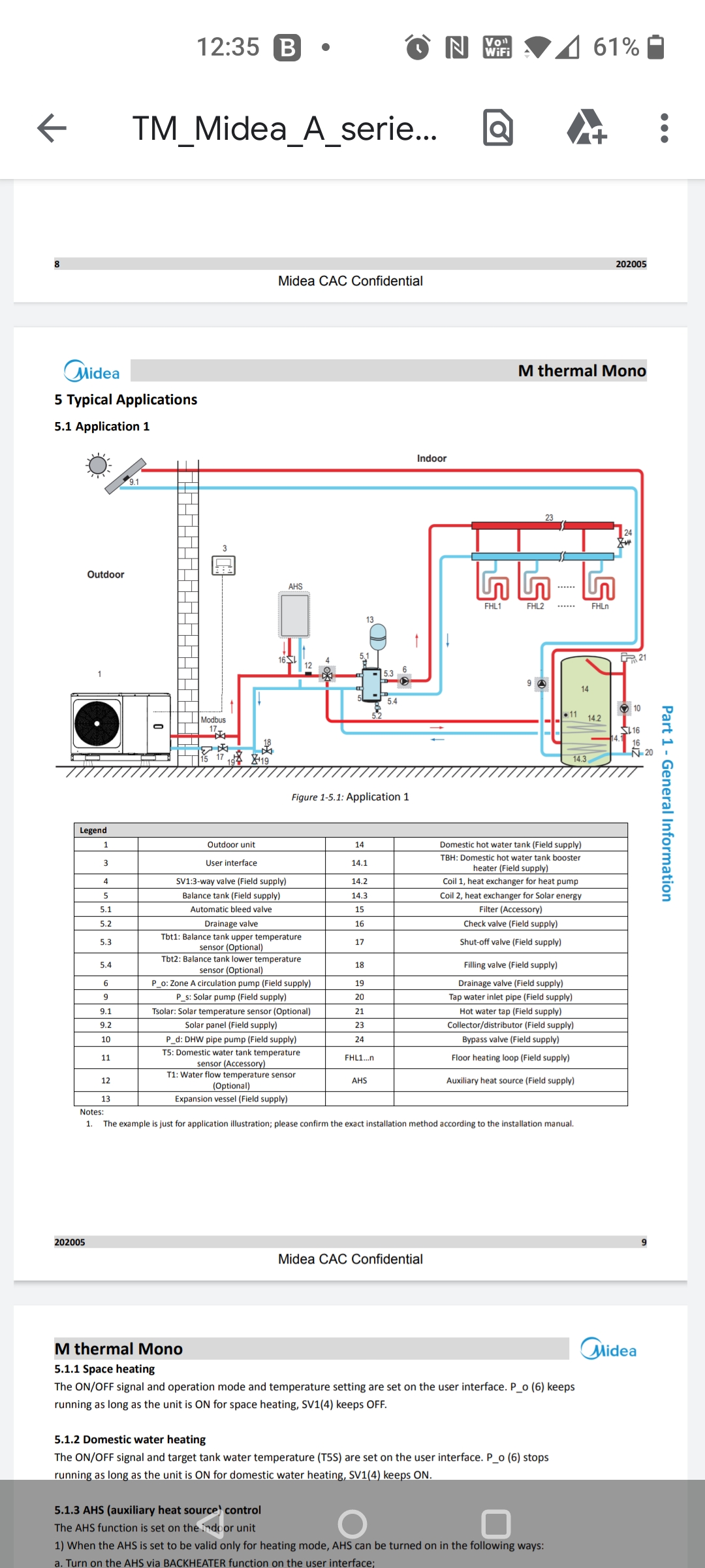

The more you split the system into zones the bigger the required buffer.
If you had a big enough buffer then a couple of immersion heaters in the buffer would get rid of a need for seperate heater.  Simplifying layout and piping runs.
LLH have to be correctly hydraulically sized to work efficiently. So would steer away from them.  Great for commercial applications.
Many do not like thermal stores, but you can get them sized for heat pumps, the main difference is the DHW coil size, being huge (about 6.6m2).  That way there is about 4 to 5 degrees difference in store and DHW temp.  You keep the store at low 50s, supply heating and DHW.
Here is a typical drawing showing the hydraulic layout of a system with an additional heat source as well as a heat pump. Pump for the gas boiler if not already within the boiler, follow boilers manual.
Note: Hydronics just means a water based heating system.  The hydraulics is the use and design of the system for water in the system.

thanks. sorry but your  diagram loses all detail with the screenshot resolution.  however, I have studied dozens of similar diagrams , plumbing and heating websites, watched umpteen design videos, and it does seem to be common that the pump for the secondary circuit is shown adjacent to the buffer pumping away , but nowhere can I find a reference that says that this is the right thing to do.
