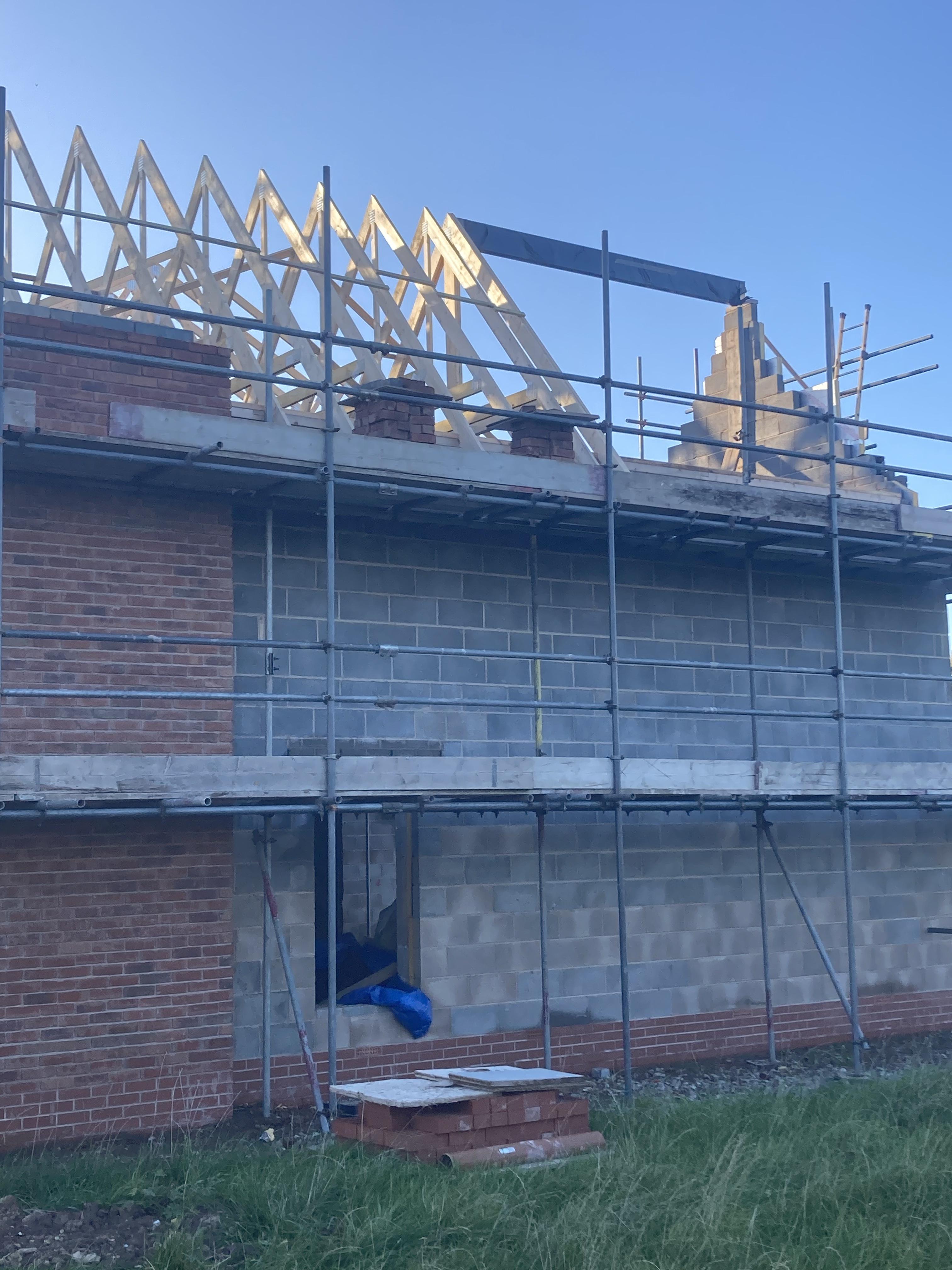

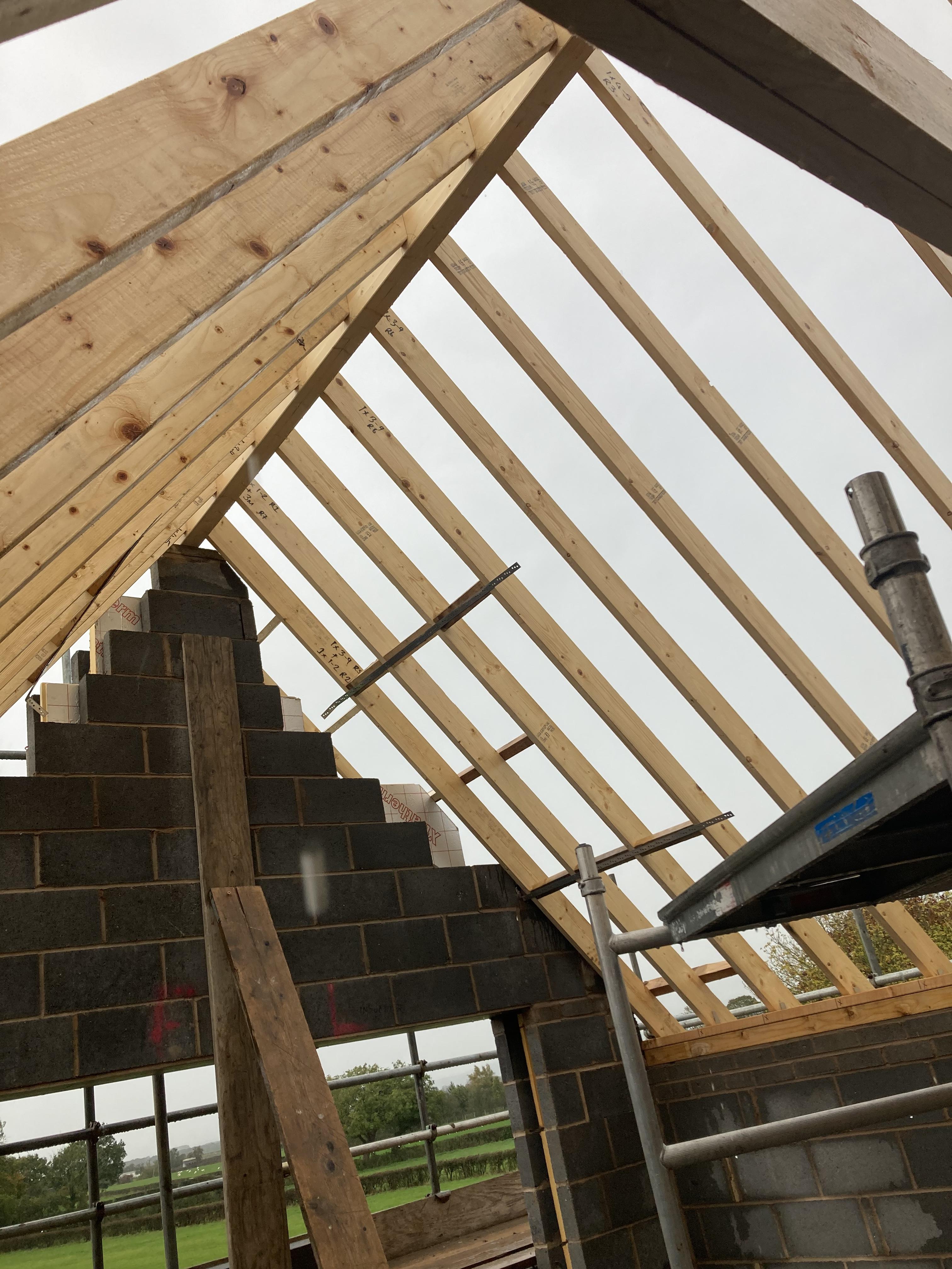

nod Posted November 24, 2022 Posted November 24, 2022 While I’ve used a bunch of steels Ive used timber to all three vaulted ceiling’s Reason being is The beam is carrying hardly any weight

nod Posted November 24, 2022 Posted November 24, 2022 1 hour ago, Temp said: What stops it pushing the walls out? If not triangulated at floor level I thought a structural ridge beam carried the weight of the roof as the roof effectively hangs from the ridge beam. I birds mouthed each joist So the force is downward A steel ridge wouldn’t make any difference to this The tops are cut to an angle So each side pushes equally against each other The engineer specked a 300x100 beam But I’ve installed roofs with smaller ridge beams in the past without issues
nod Posted November 25, 2022 Posted November 25, 2022 12 hours ago, Temp said: What stops it pushing the walls out? If not triangulated at floor level I thought a structural ridge beam carried the weight of the roof as the roof effectively hangs from the ridge beam. I’ve only tacked mine at the top with truss clips at the bottom Theres nowhere for it to go
