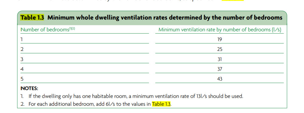

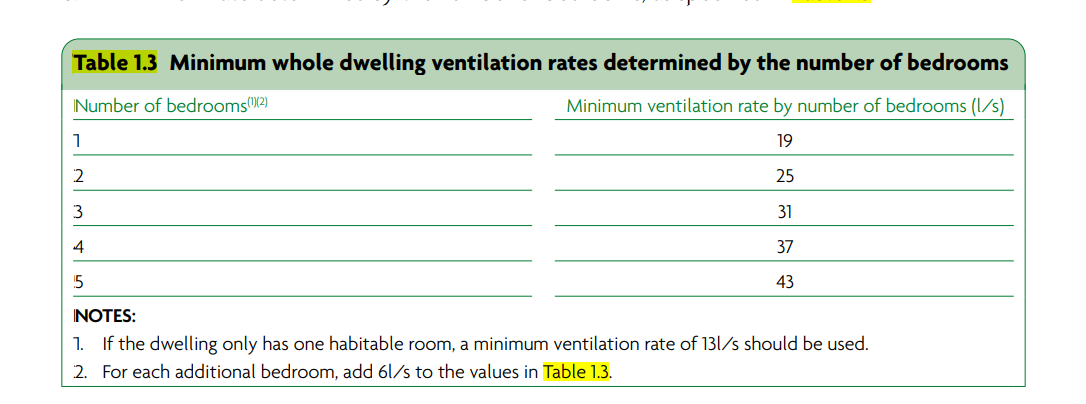

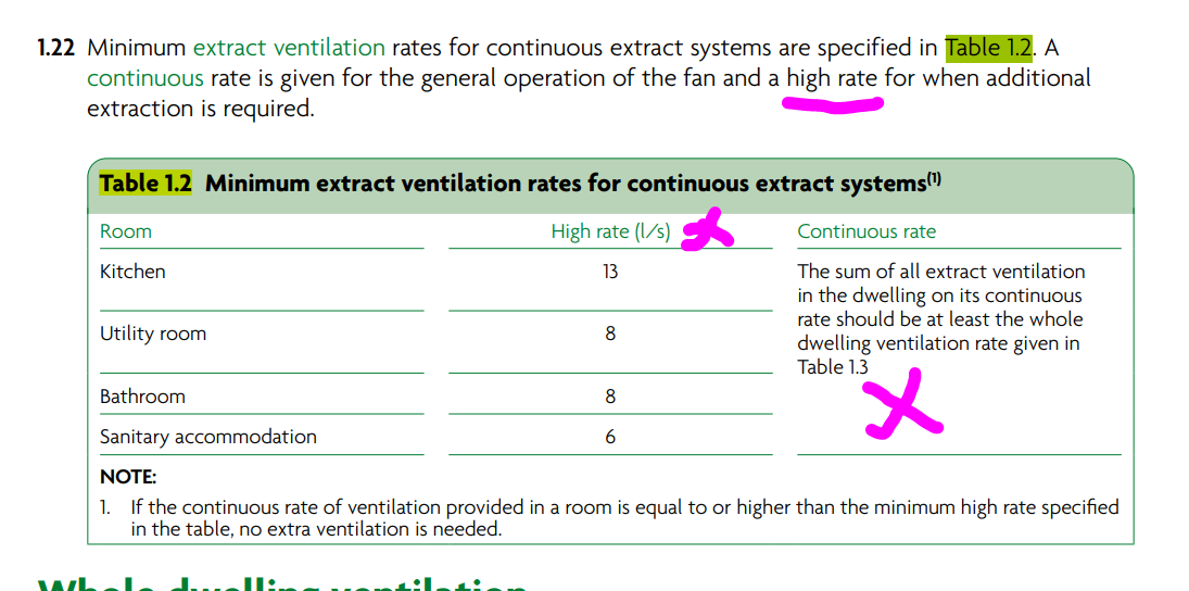

55 minutes ago, TimCx said:
I thought I had read somewhere that the required flows for each room e.g. 13ls (45m3) for kitchen could be done on boost and that the normal running could be at a lower rate but I can't find where I read that. From your info I think I need to ensure that the required rates are available on the normal setting and that boost should be higher?
Try this:-
Approved Document F: Volume 1 applies to dwellings (publishing.service.gov.uk)
High rate ventilation [boost]
Minimum whole dwelling Ventilation -
