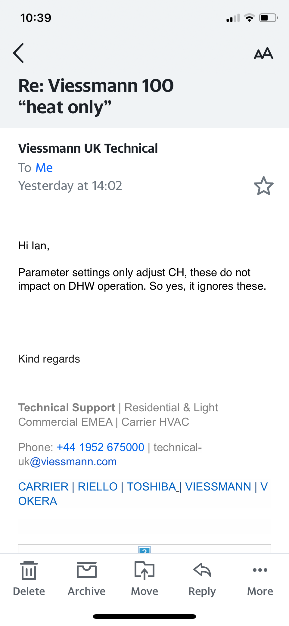

marshian Posted October 26, 2024 Posted October 26, 2024 Oh and below is the response from Viessmann technical regarding range rating the boiler (I have another email confirming the same for flow temp max, also adjustable for CH only (not when using HWD box)

marshian Posted October 27, 2024 Posted October 27, 2024 On 26/10/2024 at 08:38, JohnMo said: Can't you just change the max flow temp setting down from the default 82 to something lower. Condensing mode stops when return temp exceeds about 54 degs, it has no care what the flow temperature is, so if you are getting a 10 Deg dT across your coil you could just the max flow temp to 64, have condensing, good efficiency all year. So now your boiler runs WC in heating mode, and up to a max defined flow temp (by you) in cylinder heating mode. Gone old school and found a way forward to cap the boilers output - can't stop it going to 80 deg or trying to shove 20kW at the Hot Water circuit with the Demand Box parameters but I'll update that in my Viessmann Boiler thread. 1

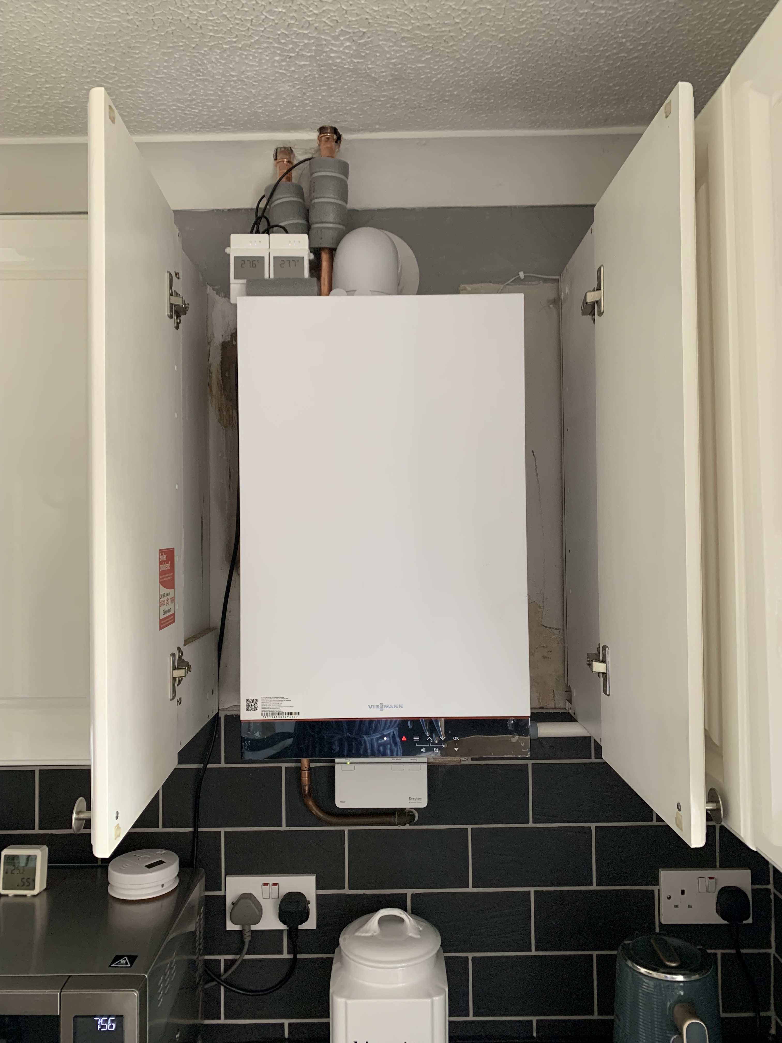

marshian Posted October 29, 2024 Posted October 29, 2024 8 hours ago, ruggers said: @marshian thanks for the info. I understand what you mean and realise in PDHW is looks to minimise the down time of the CH so gives it max power to reheat the water quicker, but I thought there'd be an option like John suggested to change this. What flow temperature does it provide in PDHW mode, is it 70-80? What do you set the cylinder hysteresis to so that it doesn't cycle too much when showering, or do you operate it based on time only? First question - OK - there probably is an option to change temp or power on a Viessmann 4 pipe boiler but I don't have one of those - I have a two pipe "dumb" boiler with Viessmann "Extras" (actually calling it "dumb" is unfair it's really surprised me with just how clever the program in it is....... I think I've explained elsewhere reasons why I chose the 100-W heat only I couldn't fit a larger boiler in the space I have and hide it in a cupboard I didn't want to run another set of flow and return pipes for the system boiler Only the 100-W has flow and return exiting the boiler at the top (same as my old boiler) So I was pretty much picking what worked best for location and minimal changeover costs I've found a way to rein in the boiler modulation when doing HW, it's a bit old school but it's almost done the job (like everything it's a swings an roundabouts situation - or you could say actions have consequences but I've got a back up plan) Second Question - Temp wise it's 80 deg that's what the boiler targets I have the cyl stat set to 60 deg (it ends up at 63 on a friday legionaires cycle) and that's the only time the cyl stat actually gets to be in control - rest of the time - I have HW set to 20 mins on a timed slot - hence my end of HW temps can vary a little (anywhere between 46 and 54 depending on tank starting temp) but I can live with that. I always heat water before it's needed, I never have a HW demand at the same time as water heating I think the Cyl Stat hysteresis is quite wide - It's just a std Dayton HTS3 probably around 8 deg it also doesn't like being set below 50 deg as it doesn't have a positive off so it's really easy to think you've cracked a position for 45 deg and then find you have no HW because the next day it's Off I don't have an NTS sensor It's how I've always done HW always happy to hear alternatives to my current process but what I do works for us in the house. Sorry probably a bit wordy in reply!!! 1
