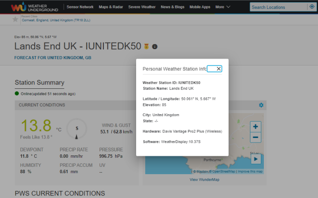

SteamyTea Posted November 7, 2022 Share Posted November 7, 2022 A Davis Vantage Pro2 is what you need, can interface directly with an RPi. Have you looked at WeatherUnderground to see what weather stations are near you, and what sort they are. You can sometimes get the info on the hardware they are using. Link to comment Share on other sites More sharing options...
