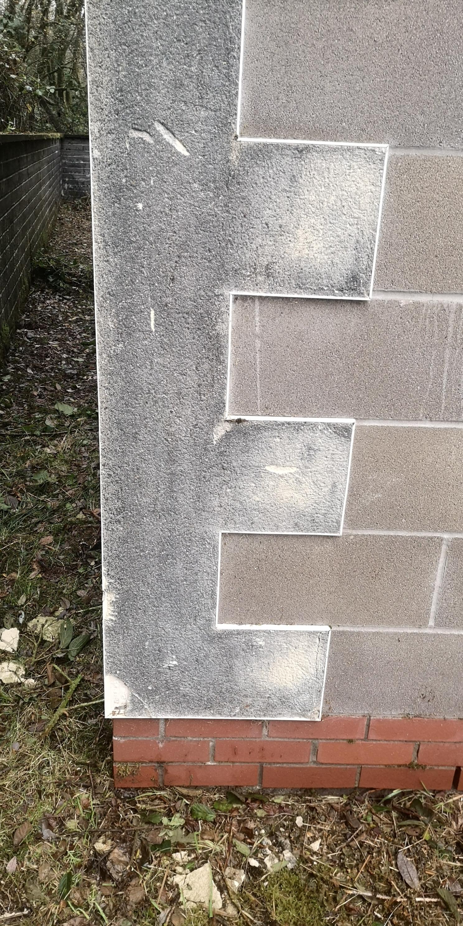

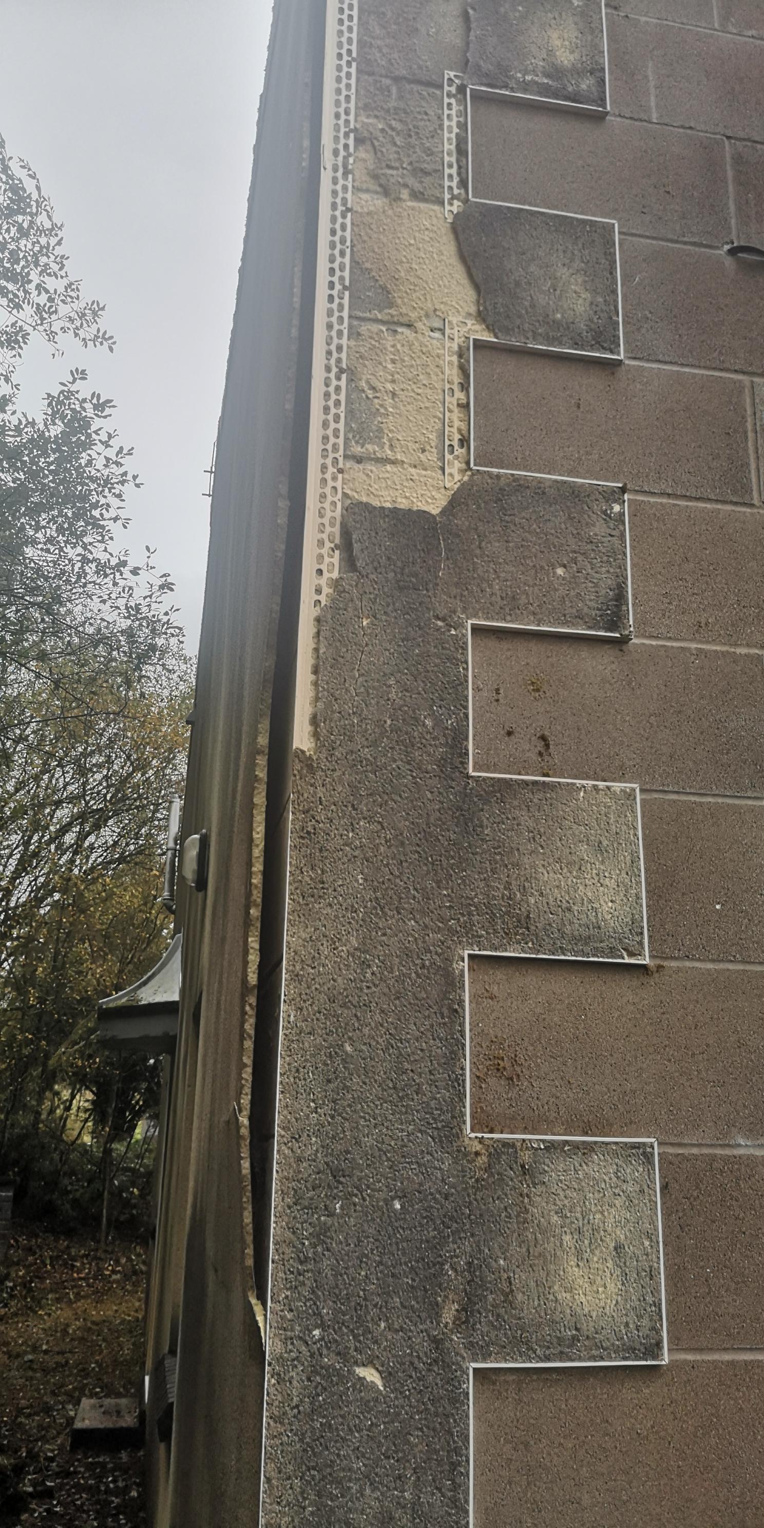

Roger440 Posted November 6, 2022 Share Posted November 6, 2022 On my nice new barn, we have this issue going on. Its clearly going to fall off soon. But i just wanted to know what it is? Hopefully the buildhub massive will know. The end of the building is done as 4 seperate areas with plastic edgoing. Only one has a problem. So pondering my options to repair? Clearly the lack of any roof overhang isnt great, but i think the primary cause is that the gutter has been leaking and running down the wall, and got under it. Link to comment Share on other sites More sharing options...

Roger440 Posted November 6, 2022 Author Share Posted November 6, 2022 It was like this when i bought it, so i have no recourse to anything. Its also, id guess, up to 20 years old? Based on the fact that roof cap sheets are applied over it, and thats when it was built. Its concrete blockwork. Its well sheltered, hence the "green" look! But you comments are not filling me with reasons to repair it. Given only one end of the building/barn (that i cant see) is done, and the rest is bare concrete block, it serves no useful purpose. But stripping it all off doesnt leave a clean wall either. And im also aware that the current shelter from a massive bank of conifers will "disappear" at some point, leaving it rather exposed to the west. Link to comment Share on other sites More sharing options...
themucky1 Posted November 7, 2022 Share Posted November 7, 2022 That’s monocouche that’s been beaded into quoins, it’s not thin coat render. What’s happened is the render had delaminated from the substrate, if you have a small overhang from a roofline or as you say a leaking gutter chances are you’ve had water ingress and after a few frosts delamination has started and this is where you are now. Link to comment Share on other sites More sharing options...

Roger440 Posted November 7, 2022 Author Share Posted November 7, 2022 4 hours ago, themucky1 said: That’s monocouche that’s been beaded into quoins, it’s not thin coat render. What’s happened is the render had delaminated from the substrate, if you have a small overhang from a roofline or as you say a leaking gutter chances are you’ve had water ingress and after a few frosts delamination has started and this is where you are now. Thanks. Are 100% certain of that? I think the lack of overhang is releatively easily fixed, as is the gutter. Much as id not choose it myself, especially given where it is, its probably cheaper to repair the damaged part than remove it all and do something else. Link to comment Share on other sites More sharing options...
themucky1 Posted November 15, 2022 Share Posted November 15, 2022 On 07/11/2022 at 11:04, Roger440 said: Thanks. Are 100% certain of that? I think the lack of overhang is releatively easily fixed, as is the gutter. Much as id not choose it myself, especially given where it is, its probably cheaper to repair the damaged part than remove it all and do something else. Yep I’m certain 1 Link to comment Share on other sites More sharing options...
