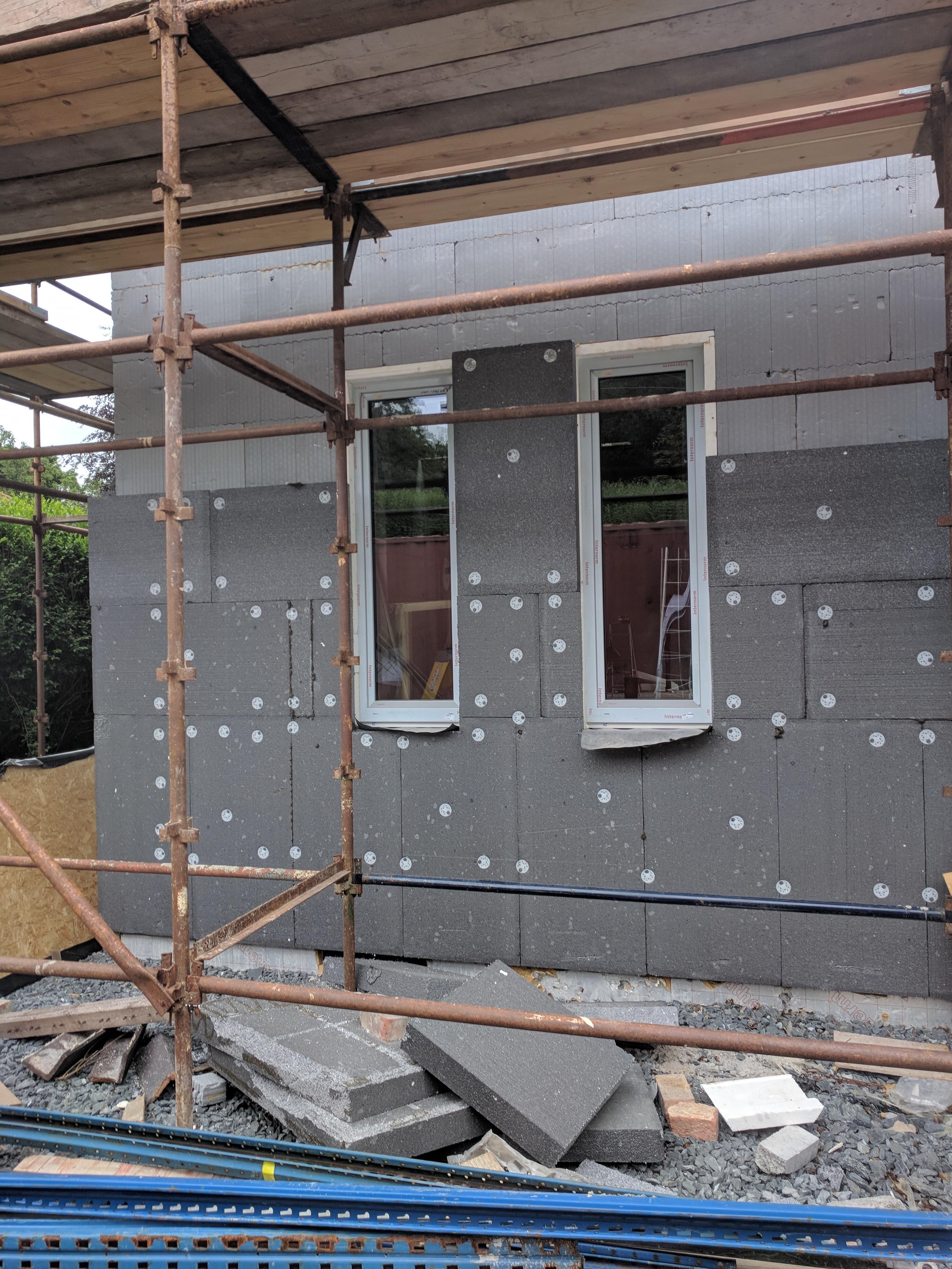

Trw144 Posted November 4, 2022 Share Posted November 4, 2022 Which ICF system did you use @Conor? Did you add extra external insulation or was that a standard offering? Link to comment Share on other sites More sharing options...
Conor Posted November 4, 2022 Share Posted November 4, 2022 1 minute ago, Trw144 said: Which ICF system did you use @Conor? Did you add extra external insulation or was that a standard offering? Amvic 300 blocks with an additional 100mm EPS on the outside. Was a lot of work but hopefully worth it! (The plastic washers were later rebated in and covered with 25mm thick insulation discs before rasping and rendering) 2 Link to comment Share on other sites More sharing options...

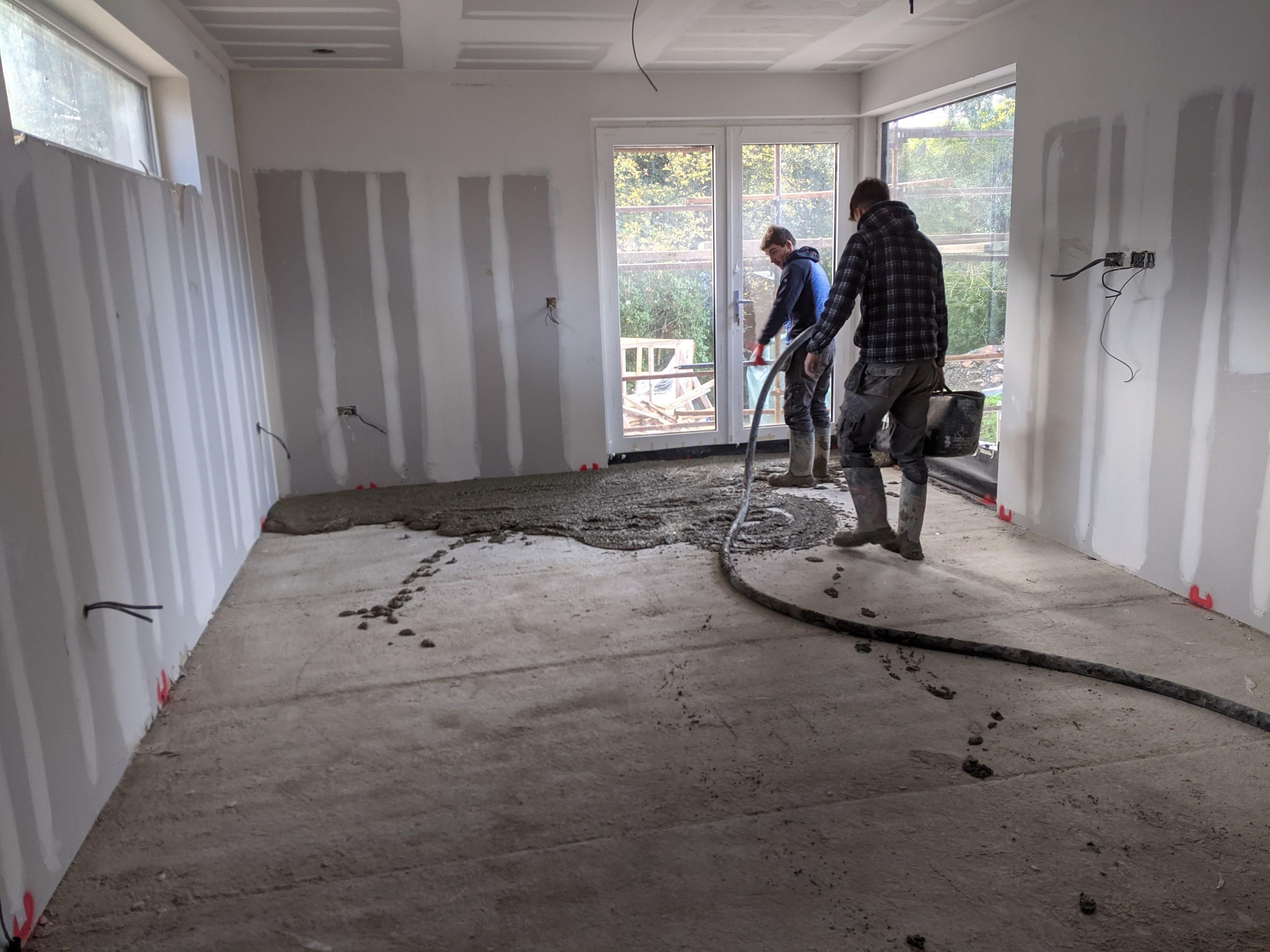

Conor Posted November 5, 2022 Share Posted November 5, 2022 (edited) 16 hours ago, Iceverge said: @Conor The TLA is a very interesting concept. Would you recommend it? What is the surface of the screed like post pour, can it be trafficked OK or does it need protection? Was it cost comparable to EPS boards? I like the idea that ducting etc can easily be accommodated in there no cutting of boards or waste. For us, we had a few uneven slabs and quite a few steels protruding so laying sheets of PIR or EPS would have been a real pain. I factored in £800 of labour for two guys for two days levellimg and laying the boards. We were at a crunch time of the build with kitchen arrival immenent so dates were fixed and we didn't have the time outlrselves. PIR was also through the roof at the time and hard to get, so the TLA worked out same price, if not cheaper You can walk on it in a couple of days after. It's a bit soft but fine for foot traffic. You wouldn't let a team of guys work on it all day tho. Or set a ladder on it. Same as insulation sheets really You need to get your polythene sheet and UFH pipes down within 3-5 days as the TLA becomes too hard to drive staples in. And they done tstick as well compared to PIR. We used mostly self adhesive clip rails anyway. But you still need to staple and will need a decent stapler and good hard, double barbed staples. Don't get the cheap ones off Amazon like I did! Edited November 5, 2022 by Conor Link to comment Share on other sites More sharing options...
