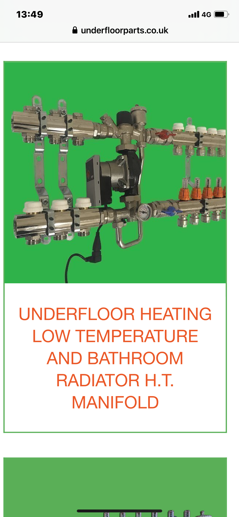

Joshua Graham Posted November 1, 2022 Share Posted November 1, 2022 Hi, I am setting up an underfloor heating circuit with a control unit, thermostats and actuators. On the last 3 ports of the manifold will be rads, 2 are upstairs. Would something like this usually be a problem for ufh pumps? Would I need a bigger pump than the standard types? Link to comment Share on other sites More sharing options...
JohnMo Posted November 1, 2022 Share Posted November 1, 2022 Have you designed the radiators to work at the same temperature as the UFH? Generally the flow temp for UFH is well below that required for a radiator. Whether an issue for the pump would depend on the what pump you are using. Would you be better plumbing for the radiators and using two close coupled tees from the radiator circuit to supply the UFH manifold? Link to comment Share on other sites More sharing options...
Joshua Graham Posted November 1, 2022 Author Share Posted November 1, 2022 5 hours ago, JohnMo said: Have you designed the radiators to work at the same temperature as the UFH? Generally the flow temp for UFH is well below that required for a radiator. Whether an issue for the pump would depend on the what pump you are using. Would you be better plumbing for the radiators and using two close coupled tees from the radiator circuit to supply the UFH manifold? Hi John, Yes the radiators are set to run at 35 degrees, basically oversized. I used a couple calculators to work out the btu sizes for the temp. Its also regulated by digital thermostats. I want to avoid using TRVs on my radiators as I prefer the digital thermostats on the walls with a couple extra thermometers around the rooms. A very similar pump, brand and model etc, has a 6.5m delivery head, which from what I have read, represents the max it can push water against gravity. The radiators are about 3.5m max above the pump, would it stand a chance? What else should I consider? Link to comment Share on other sites More sharing options...

Nickfromwales Posted November 2, 2022 Share Posted November 2, 2022 There are manifolds to do this out of the box. Link to comment Share on other sites More sharing options...
