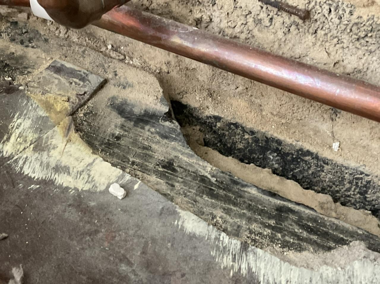

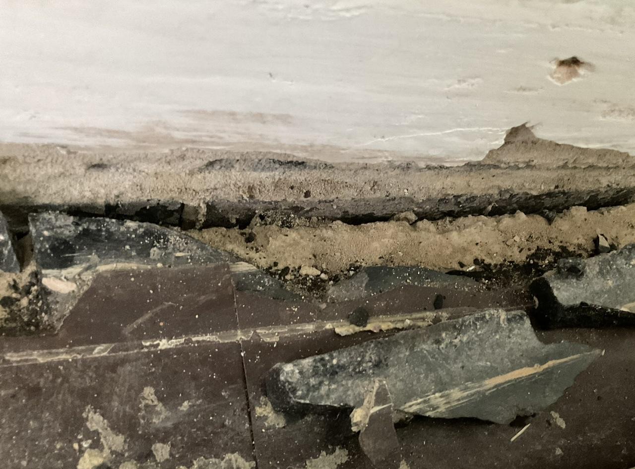

Monty2468 Posted October 31, 2022 Share Posted October 31, 2022 Our mid 60’s solid floor has broken up at the edges were the carpet gripper has been fitted, and I need to repair it without causing any damp issues. The floor consists of a thin tile on top of a black layer (15mm) of something ? On top of concrete. I was thinking of coating everything solid with SBR, then bringing back to level with a strong sharp sand mix, then painting on a liquid DPM ? Or have I got that wrong ? There is also a 5mm gap between the floor and the wall. Can I mortar this up as well to prevent drafts, or is it an expansion gap ? So maybe use either foam or a urethane sealant ? Thanks for your help Link to comment Share on other sites More sharing options...
markc Posted October 31, 2022 Share Posted October 31, 2022 Looks like tile on top of bitumen, probably shrunk back from the wall over time. Filling with foam or flexible sealer will be ok. Grippers really should have been glued or drilled and screwed on that floor. 1 Link to comment Share on other sites More sharing options...
Temp Posted November 1, 2022 Share Posted November 1, 2022 17 hours ago, Monty2468 said: I was thinking of coating everything solid with SBR, then bringing back to level with a strong sharp sand mix, then painting on a liquid DPM ? Sounds ok to me. 1 Link to comment Share on other sites More sharing options...
Temp Posted November 1, 2022 Share Posted November 1, 2022 17 hours ago, Monty2468 said: There is also a 5mm gap between the floor and the wall. Can I mortar this up as well to prevent drafts, or is it an expansion gap ? So maybe use either foam or a urethane sealant ? Normally there is perimeter insulation. Probably get it at Screwfix or Toolstation. Link to comment Share on other sites More sharing options...
Temp Posted November 1, 2022 Share Posted November 1, 2022 Just now, Temp said: Normally there is perimeter insulation. Probably get it at Screwfix or Toolstation. I was thinking of this stuff but unfortunately £33 a roll. Might be cheaper elsewhere or someone might have the short length you need. https://www.toolstation.com/jg-speedfit-edge-strip/p74324 Link to comment Share on other sites More sharing options...
Nickfromwales Posted November 1, 2022 Share Posted November 1, 2022 Liquid DPM first, and flick some sand over it whilst wet to provide a key. You don’t want to bring damp up to the surface and then try and hold it back from there, far better to keep it out of ( below ) the new filler material. 1 Link to comment Share on other sites More sharing options...
Nickfromwales Posted November 1, 2022 Share Posted November 1, 2022 2 minutes ago, Temp said: I was thinking of this stuff but unfortunately £33 a roll. Might be cheaper elsewhere or someone might have the short length you need. https://www.toolstation.com/jg-speedfit-edge-strip/p74324 Perimeter ( expansion ) insulation is only really necessary on a heated slab? A bit OTT if it isn’t heated IMO. Link to comment Share on other sites More sharing options...
Monty2468 Posted November 1, 2022 Author Share Posted November 1, 2022 2 hours ago, Nickfromwales said: Liquid DPM first, and flick some sand over it whilst wet to provide a key. You don’t want to bring damp up to the surface and then try and hold it back from there, far better to keep it out of ( below ) the new filler material. Thanks Nick, after the liquid DPM, do I then need SBR on top, or OK to just concrete onto the liquid DPM back to level ? Also, should I concrete in the small gap between floor and wall, or just use expanding foam ? Again thinking about cold air/damp tracking from wall to floor ? I appreciate the help Link to comment Share on other sites More sharing options...
