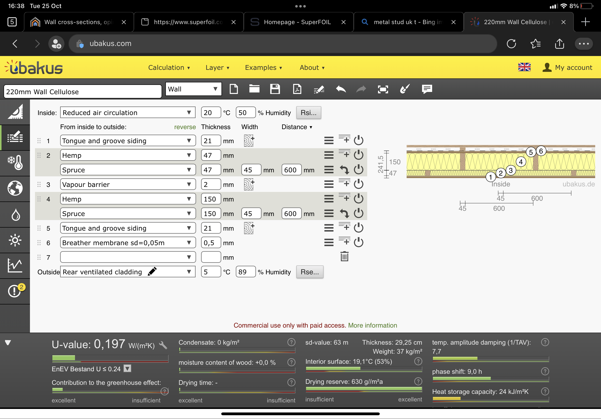

I’m trying to arrive at a final plan for the walls before sending the plans off the building control. I’d really appreciate people’s opinions on the structure. Am I missing something, does something need to be chunkier, is there a newbie error in there, etc. (For example, I’m unsure if I need a moisture barrier between the frame and the plywood sheeting on the outside, given that there’s also a weather shield — I’m guessing it can’t actually hurt anything but my wallet.)
My priorities are structural rigidity, wind/weather-proofing, insulation, a utility channel for electrics etc., and to be realistically achievable.
Cross-section diagrams of external and internal walls attached. All opinions appreciated.

This seems over complex.
4 layers of vapour barrier of different types  whereas one out and one in should do.
Plywood on the frame will make it very much stronger, laterally and vertically,  so that is a great idea.
I'm not a fan of foil insulation if there are other options. 6" between the studs as shown is a good start. Then some non- conducting liner over the studs.
What external facing have you in mind?

There is too many moisture barriers. One "barrier" ( think plastic sheet) max in any buildup. Everything needs to be breathable ( think goretex jacket). Otherwise the wall will not be able to dry and stay damp and rot.
No moisture barriers normally on internal walls typically.
The ply Vs OSB has its protractors/detractors arguements. Good quality OSB for me every time. I like Smartyply.
One factor I would be cautious of is using lightweight insulations like glasswool and foam considering you have no masonry externally leaf. It would be similar to a caravan in the summer regards overheating due to poor decrement delay/phase shift.
This is the the time it takes for the initially daily blast of external summer heat to soak though the wall/roof. Two buildings will perform drastically differently in summer even if they have the same U values. The caravan and stone outhouse are the dramatic examples.
The stone building remains comfortable but the caravan overheats in summer although in winter they take the same amount of energy to keep warm.
Have a play with Ubakus.com. it's great for this.

Internal to external wants to go from less vapour permeable to more vapour permeable.
Are the internal battens for a service void?
You shouldn't need plywood on both sides (personally I think internal is better) and grade 3 OSB is a better choice.
Internal - plasterboard - 25x38mm battens / service void - vapour control layer - 25mm PIR insulation* - 9mm OSB** - 150x50mm*** timber timber structure with full fill PIR* - Breather membrane - 50x50mm battens (or 2No layers 25mm battens for vertical cladding) / ventilated cavity - cladding
*Insulation type and thickness to whatever is needed for BR in your location
**9mm OSB to be increased to whatever SE says
***150x50mm structure to whatever SE says

The insulation we like is hemp (https://www.ecologicalbuildingsystems.com/product/thermo-hemp-combi-jute). Mainly because it doesn’t require any specialist equipment to install. The manufacturer recommended a moisture barrier on both sides of the frame to keep it in place, but I guess the racking would do the same job.
Thanks for the Ubakus tip, I will play with that.
@George — The foil insulation needs an air gap on both sides to be effective (minimum 38mm). I bumped it up to 50mm on the side closest to the plasterboard to give me a more generous service void (just in case).

If you have structural issues foil won't save you.  I'd avoid it in any case, most of the performance numbers they claim comes from the unventilated airspaces created within a wall, much like double glazing. Any kind of air circulation would ruin the theoretical performance and it's a renovation so you'll have some air movement.  Mineral wool, cellulose/hemp is a better way to stop the air moving. Fire will love those air gaps too if it gets in there.
PIR between studs is fine if you like suffering, don't care about summer overheating, of fire risk, or materials wastage!
Do you have any pictures of the building as it stands, inside and out?
Im guessing that you don't have a tremendous budget so it's important to save as much cash as possible.
I think you don't need to remove the tounge and groove boards outside if they are in good condition, just lap, staple and tape a good breather membrane over the top, then some 38mm or 22mm battens for ventilation and some more cladding.
Internally you could take down the T&G and put hemp batts between the 6x2 studs. Then cut 45deg tracks in the studs and push in some T L or C profiles to provide cross bracing screwing them into the studs. Then cover and really diligently tape with a good vapour membrane, fix 47mm cross battens for a service cavity insulated with 50mm hemp batts and then reuse the tounge and groove cladding.
It could be done piece by piece, fairly cheaply and would be windtight, airtight, have little thermal bridging, good phase shift, breathable, good sound protection, low embodied carbon, good fire performance, low materials wastage.

The only time I've seen foil insulation suggested seriously is for retrofit where nothing else was feasible. The idea is that radiant heat gets reflected back into the room to be absorbed. Which is great. but with a well insulated wall, that same radiant heat is absorbed by the wall, so still remains within the same thermal envelope. So what have you gained by reflecting it back in?
Foil can make make some improvement in badly insulated walls. But on a new build that is not where you should be.
If weight is an issue, improve the foundations.

How about treating the existing structure as just ventilated cladding?
Something like..
Remove existing insulation to allow ventilation of that void.
Line with vapour permeable membrane and OSB.
Build internal structure from say 2*5 with 125mm insulation between...or 100mm and a 25mm service void.
Plasterboard.
Is there a DPC already under the existing structure?
