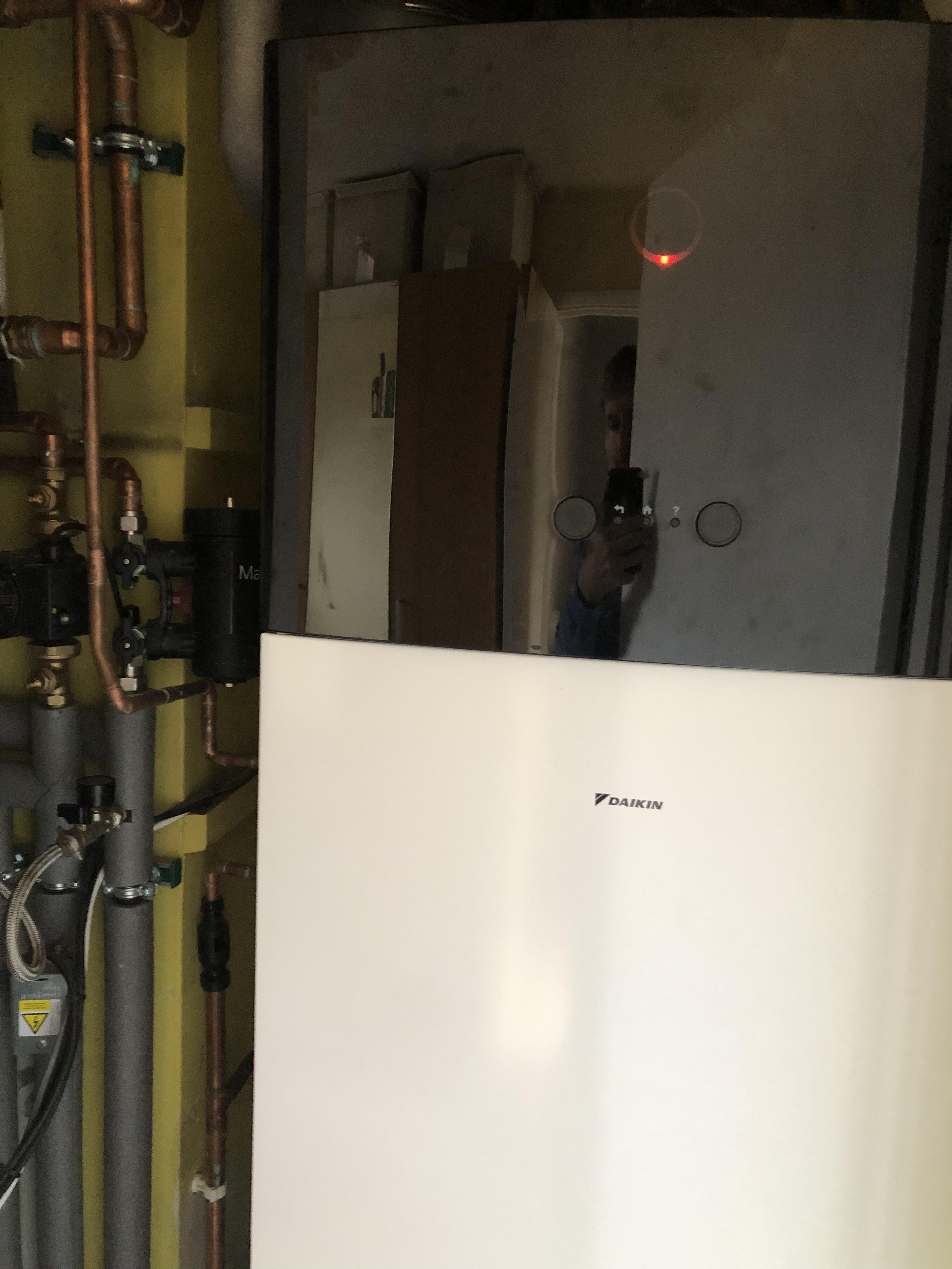

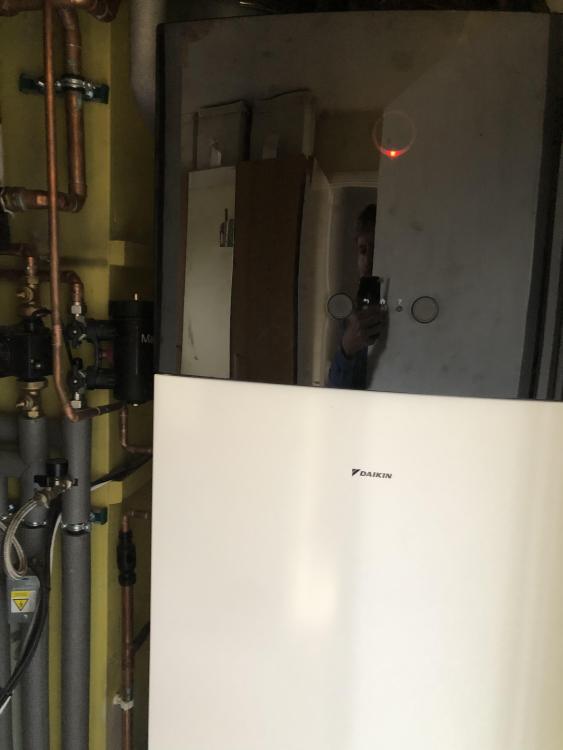

Any chance it's plumbed incorrectly? 45C could very well be the DHW blending valve's setpoint...
Photos of the install would help, here.
Is there a motorised valve operating from a tank thermostat and the tank thermostat is set lower than the ASHP target tank temperature?
Picture of the plumbing and controls on and around the tank?
There should be a motorised valve and tank thermostat on an UVC as a safety measure to shut off the heat input if it gets too hot. This is often not actually used with an ASHP and in my case the tank stat is set to 65.
The tank is integrated into the indoor unit so there’s not much to see without taking it all apart, which I don’t want to do at this stage because if there is a problem then I don’t want to be liable for messing around with it!

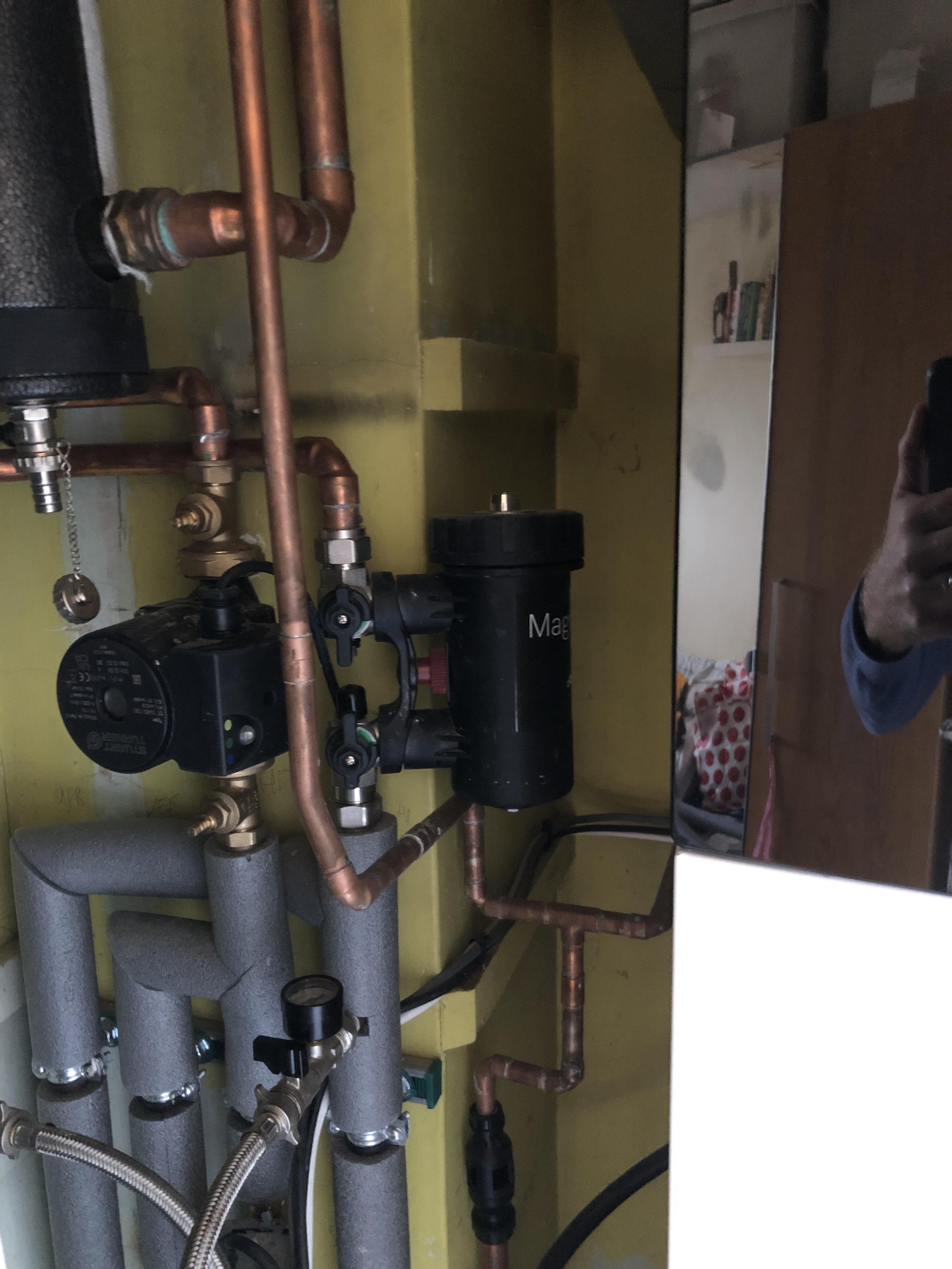

The pump at the left is connected to the wireless thermostat receiver from the bedroom thermostat (radiators)

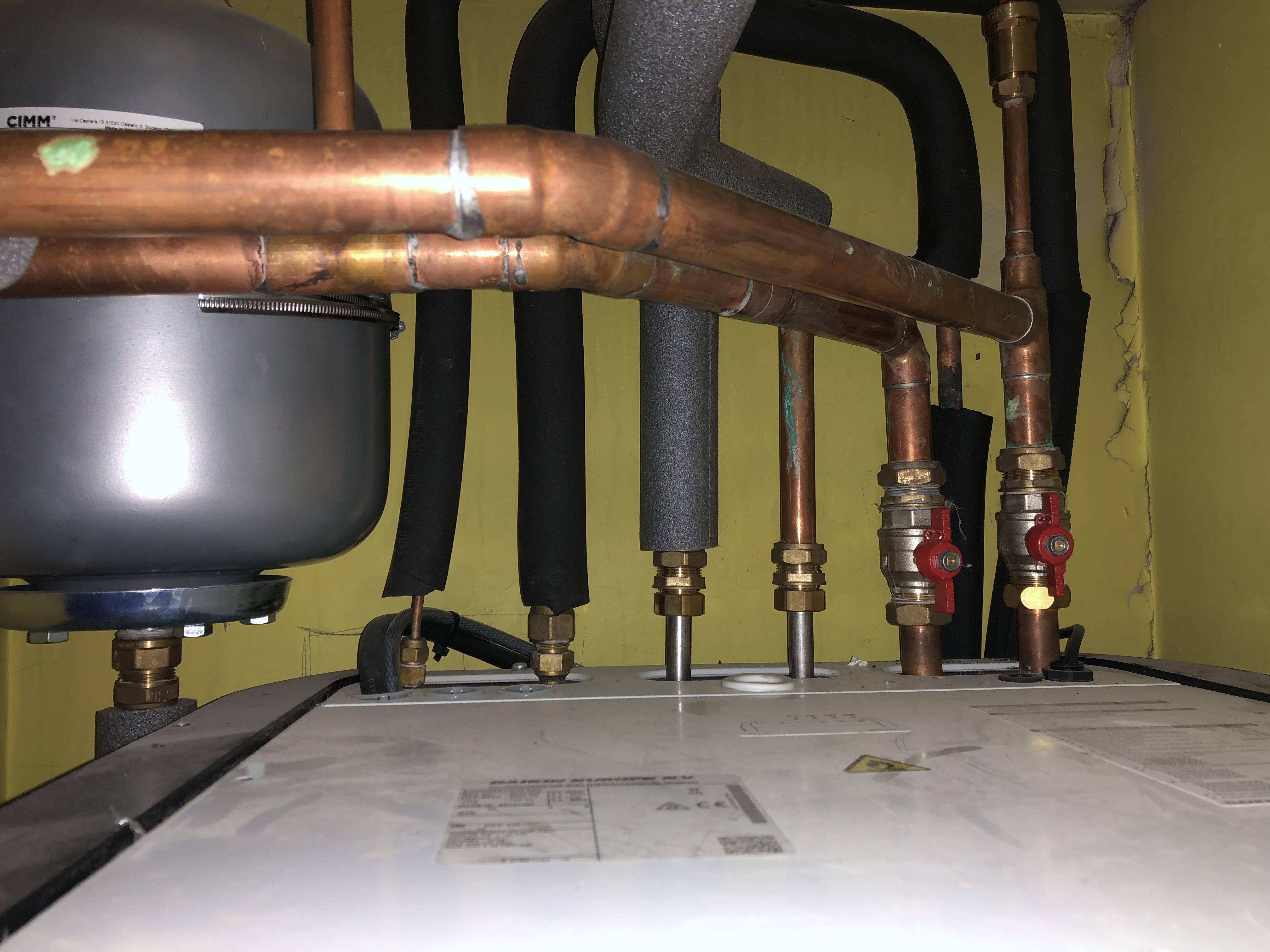

Plumbing into the top of the indoor unit. Probably not much help as all the interesting stuff will be inside, I imagine?
(Lagging has been removed as an additional air valve was cut into the pipework)
Edited by Bob77
what's the item above and to the left of the pump?
/if this is a split with inbuilt tank, and only heating flow and return coming from it, it would seem to me to be an internal fault as there is no external flow for DHW...
The black cylinder? That’s the low loss header I believe.
I’m also starting to suspect some kind of internal fault. The space heating circuit seems to work fine but the hot water has never worked properly since installation. It won’t even get up to temperature when it tries to run a legionnaires cycle.
