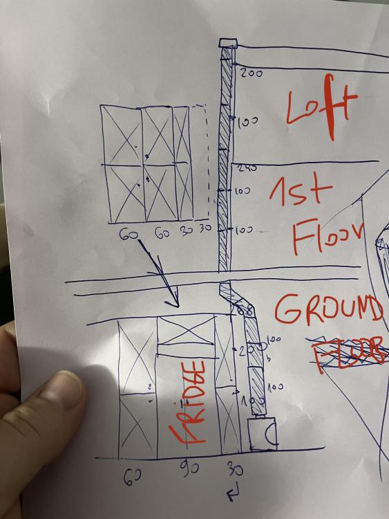

On Your drawing you show the flue terminating at ridge height. If it will be near the ridge I believe it must go 600mm above it.

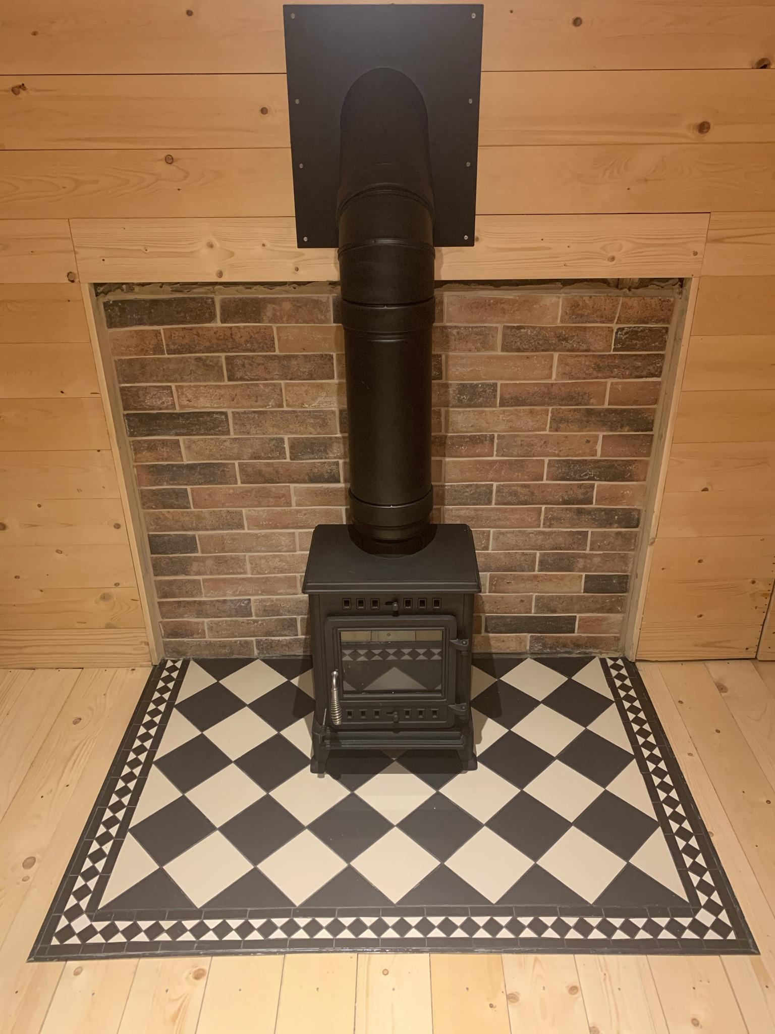

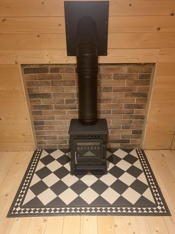

I'm not sure the picture of the stove on the tiles would comply. I believe there should be a step up of 12/15mm(?) to discourage rugs migrating too close to the stove. Eg the tiled area shouldn't be flush with the wood floor. Hard to tell from the photo if that's the case.
