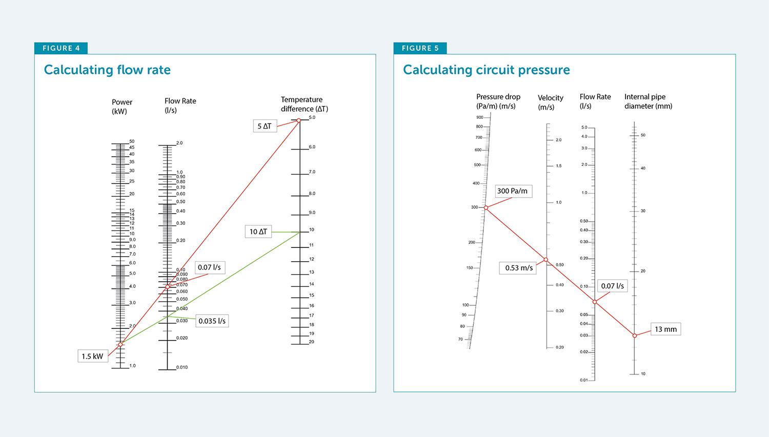

JohnMo Posted October 3, 2022 Share Posted October 3, 2022 You cannot just pick a flow temperature and assume it will work. Flow temp depends on heat loss, both from the house and downwards. You really need to be looking at running weather compensation to get the best CoP. See attached, the red lines are there as examples. You need to calculate your heat loss then find W per m2. From these charts you can calculate your heat for WC. Find heat loss at -20 and +20, convert them to flow temps and plot a straight line curve. You need to consider the min flow requirements of the heat pump and let that guide you on centers. Also the centre distance affects the response time of the floor. 1 Link to comment Share on other sites More sharing options...
