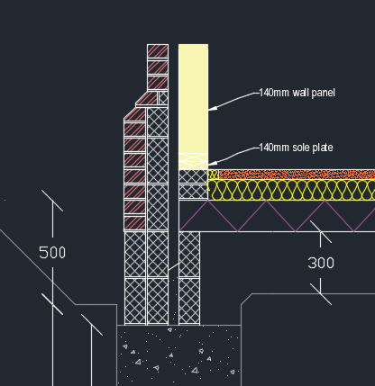

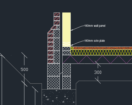

benben5555 Posted September 28, 2022 Share Posted September 28, 2022 Which of these details do you think is best? The labour and material cost is not significantly different so it really comes down to what will work best. 1. 215mm blocks in outside leaf, 140mm blocks in inside leaf 2. 100mm blocks all round Link to comment Share on other sites More sharing options...
nod Posted September 28, 2022 Share Posted September 28, 2022 The 215 x140 would be quicker Link to comment Share on other sites More sharing options...
Canski Posted September 28, 2022 Share Posted September 28, 2022 Outer 215 and inner 100 mm would be quickest. Blocks on their belly on the outer and upright on the inner. Link to comment Share on other sites More sharing options...
