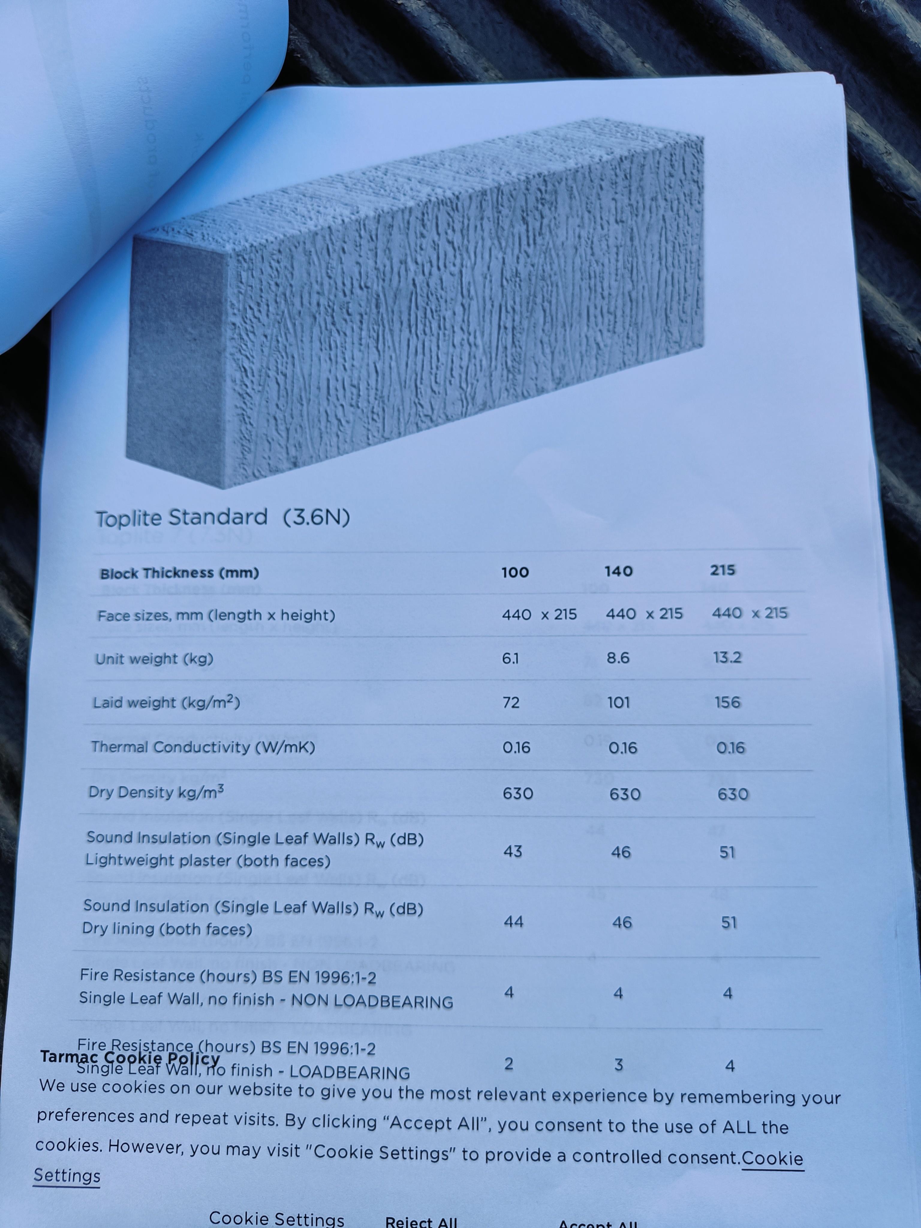

Hi team,
Our builder has proposed the below aircrete blocks for internal concrete walls on our first floor level.
Any comments/feedback ? I have no idea if this would be a downgrade on concrete blocks ?
I'm particularly interested in the sound deadening qualities & thermal performance, but any other feedback/suggestions welcome ?
Many thanks in advance
Edited by bmj1
Whilst u values are higher Concrete blocks are more sturdy
I wouldn’t build any free standing walls out of them
Prone to getting knocked over or blown over
Brickies love them
They are not very strong and are difficult to fix to.  If they are internal walls you should not need thermal properties.  A medium density aggregate block like Hemelite is good.
yup, unless you want to go back to using cut nails
